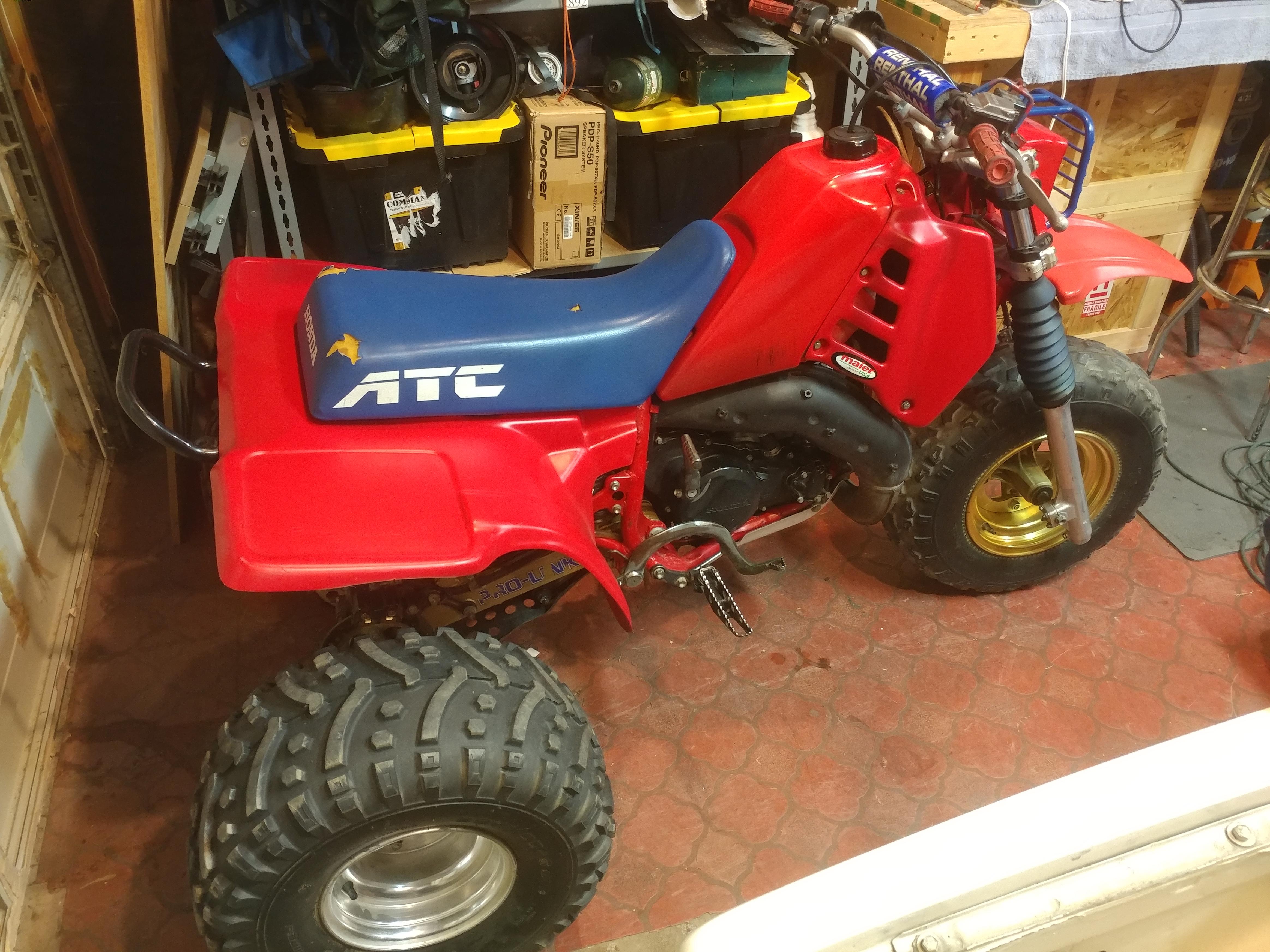

    Picked this one up today after about 8 hours of driving round trip. This is the first one I've owned. Ridden a few in my day but never had one... Mostly original, except the Maier low profile rear, silver top end, and countless stacks of unnecessary washers where shorter bolts should be. Definitely has had some ham-fisted work done to it but I'm anal, I'll save it... The other 2 gold wheels have a set of paddles on them. These are a little easier to push around.
    Couple questions... Any source for the rubber rear fender washers? Not the ones that go on the frame, the ones that go on the bottom of the seat. Also needing the front fender rubbers so I can throw a few washer stacks away. And lastly, when it comes to the exhaust flange, is it best to go with an o-ring kit or just splurge for the fancy billet one? We're leaking there so I need to get that fixed before running it much...

    Nice trike!
    On my 85 exhaust flange, I replaced the stock seals with new ones and used some red hi-temp RTV. It hasn't leaked in 5+ years.

    Defo a nice looking machine. One thing you could check that is fairly common swap is the wire harness. Easy check is to look at the CDI plug, round = 85, 2 plug 4 & 2 pin is 86. Pretty sure the 86 harness is more desirable since it's the same cdi connectors used today. The round cdi connector (harness side) seems to be out of production for new harnesses on my end, but I've seen a "reproduced" CDI on ebay with the round connector for a 4 stroke machine.
    Also a great resource for parts is of course a Honda dealer, some items are in production, a lot are not, but never hurts to check there first. A lot of bolts etc are in production yet, unless it's some one off special bolt.
    https://www.partzilla.com/catalog/ho...1985/atc250r-a
    Front fender rubber mounts still in production $2.46 each:
    https://www.partzilla.com/catalog/ho...a/front-fender
    Also looks like all of the OEM case bolts are listed too for left and right cases. Probably would have cost about the same as the stainless ones you ordered, maybe a little more. If you have a good local Honda dealer you might be able to get them to price match partzilla and provide free shipping.

    The yard is up in Ventura. Have been talking to some people and they seem to think he's expensive. But then again, they're notoriously cheap...
    Thanks for that ps2... I saw partzilla but wasn't too sure of them. Good resource for part numbers as well. And seems I have an '85 harness with the round plug CDI...

    I buy 99% of my Honda parts from partzilla, the only thing that can suck with any Honda dealer is back orders. I've waited like 4 months for a large order once, but most of the time it's within a month max. They recently changed their site, used to be able to search part numbers for easy interchange checking, now you have to edit the url to bring up the part's page since it's not included in search results any more . Easiest way to look up parts with the updated site is by machine. The list of machines the part number fits is really useful for researching parts though.

    What are the go-to chain rollers? Mine are just bearings, no plastic left on either of them.

    For the exhaust flange- the billet aftermarket ones with the o rings are well worth the money, especially since they don't cost that much anyway.
    And as far as the cycle salvage yards, I have not found one yet that wasn't trying to get close to,or in some cases more than the part costs new. Ebay or here on the boards are the best place for parts.
    For all the little grommets, screws and stuff like that give BDT motorsports a call. They have a lot of oem stuff that no one else has for a fair price.

    I got my rollers from TM Designworks
    Soutwestern PA
    2,040
    I have a few TMDesignworks rollers and sliders on my trikes.
    http://tmdesignworks.com/
    Which brings us to the next question. Is your swingarm bolt free or seized in place?
    It needs to come out to install the chain slider (at least mine did).

    Also, that looks like it could be an original front tire. Bravo!

    I like the stainless allen bolt sets. I heard a lot of people don't like them, but I've had zero problems with them.
    By the way your seat is from an '86 model.
