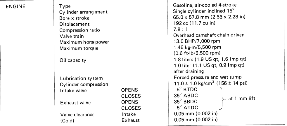

    Here's the engine specs from a Honda 200es service manual. Compression (warm & dry) should be 156 +/- 14psi. 140 is out of spec, but I assume that's cold too, warmer it will be higher compression, the wet test is within spec.
