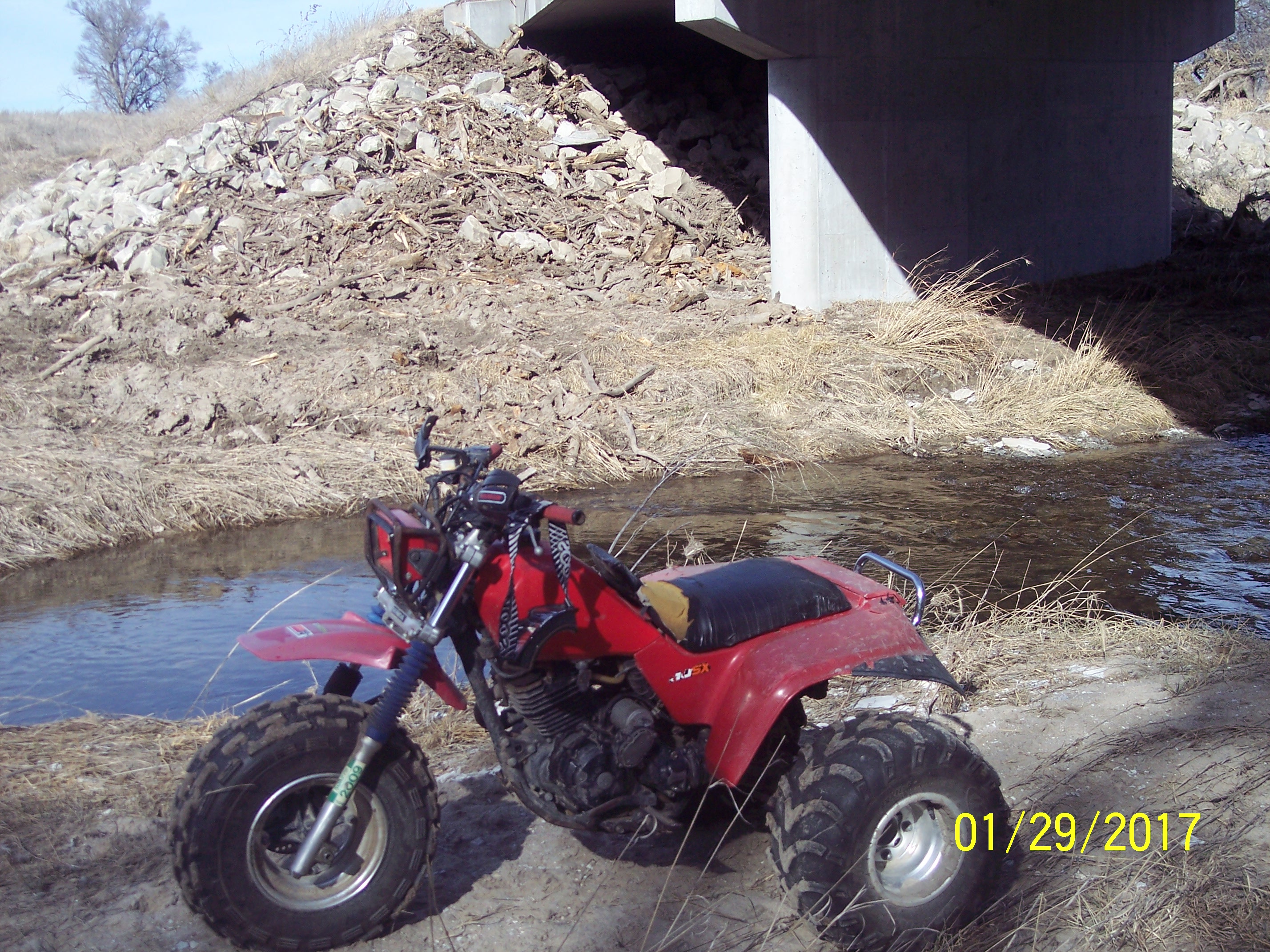

    Right now, I'm running a pair of wheels on the back of my 85 250SX that supposedly came off of a TRX450R. They are 9" diameter. I can't say how they clear the rear brake. I originally ran a pair of 8" 200X rims and had to put 1.5" wheel spacers for them to clear the brake. I found the wheels with used Mud Lites already mounted. I bought them and left the spacers on since I like the added stability. I just can't picture someone running Mud Lites on a sport quad though.Click image for larger version.
ID:	251868Click image for larger version.
ID:	251869Click image for larger version.
ID:	251870 Just so you have an idea.
