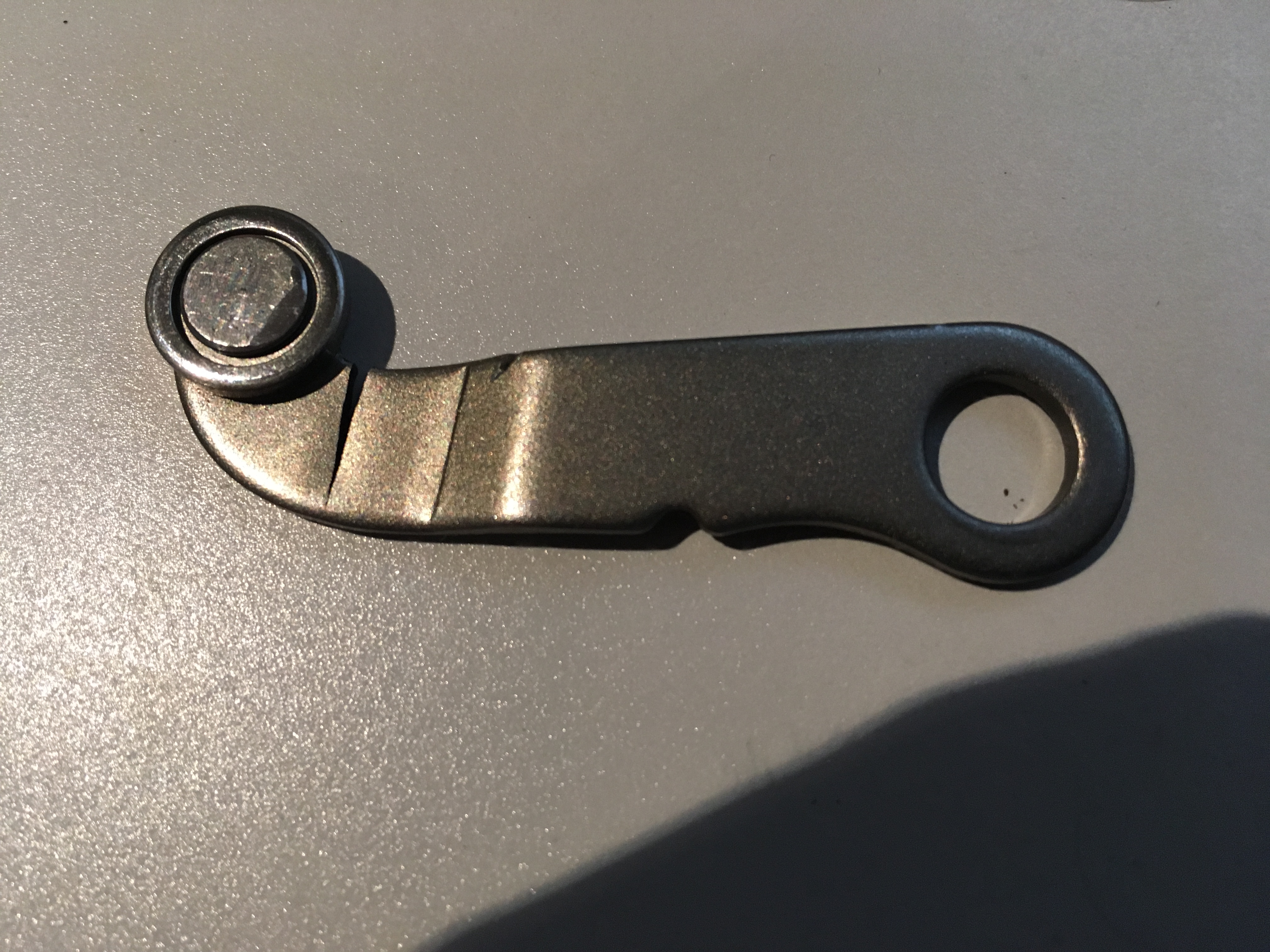

    So I got the Clutch Pack off and then the main gear and sure enough the Shift Drum Stopper Arm was cracked and riding on the outside of the Shift Drum Stopper Plate. If your Honda starts to not shift correctly or hard to shift this is likely the issue. Again thanks to Shortline10 & big speech for the advice and help. This was very easy to fix and anyone can make this fix. Video attached of the Stopper Arm Crack.
