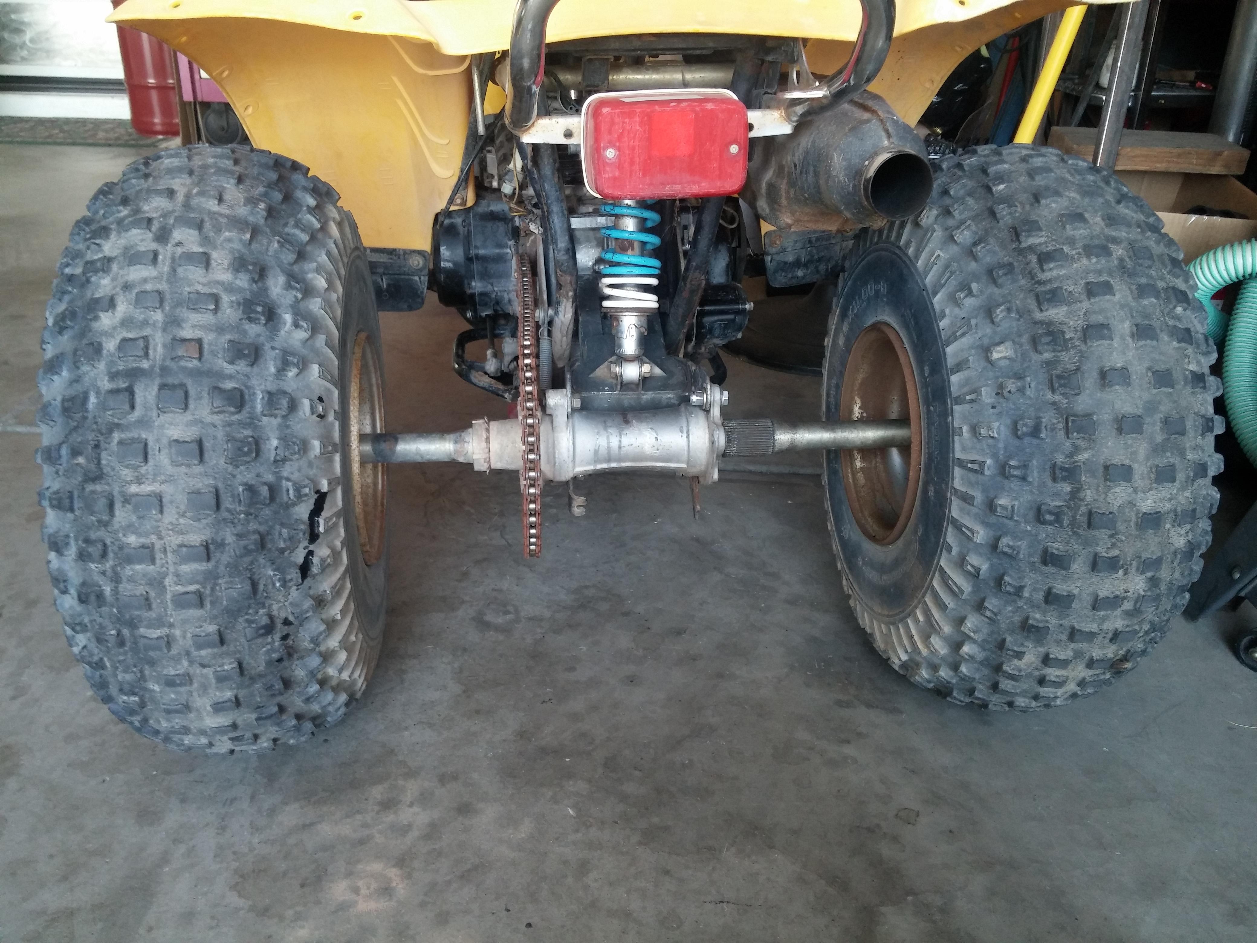

    I'm assuming a stock brake setup would work, but I really have no idea. Here are a couple of pictures of how she looked when I brought her home last night. I want to get her cleaned up a bit and I'll get better pictures and post those later.

    It's definitely a rare bird. I'd recommend keeping it.
    That looks like a works shock, looks like a Pro-tec kit too, but don't quote me on either.

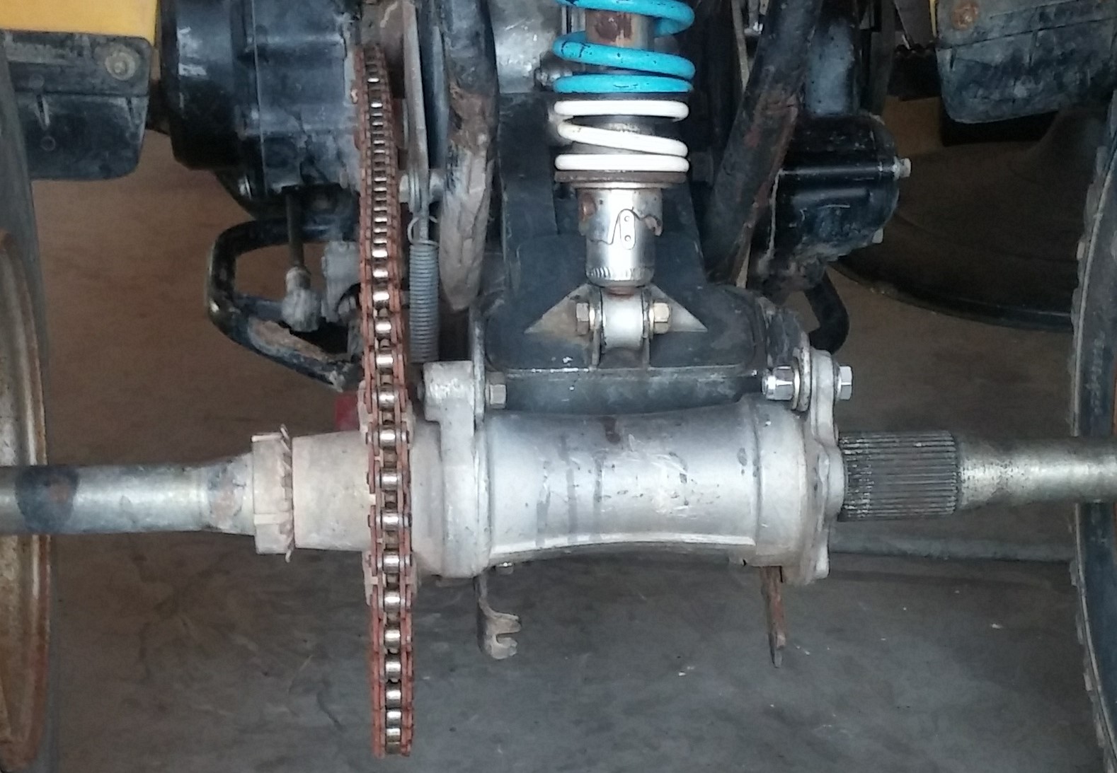

    Cleaned it up a bit and I noticed the chain was a bit off to one side, both sprockets are parallel, but they aren't in line with each other. It doesn't look like there is any adjustment for that, but I'm not sure. I tried to get a picture showing it, not sure how well you can see it.
    Also, the chain is really loose on the sprocket, not loose, like it needs tightening, more like it's the wrong size or just stretched really bad. It moves around on the sprocket even when the tensioner is tight.

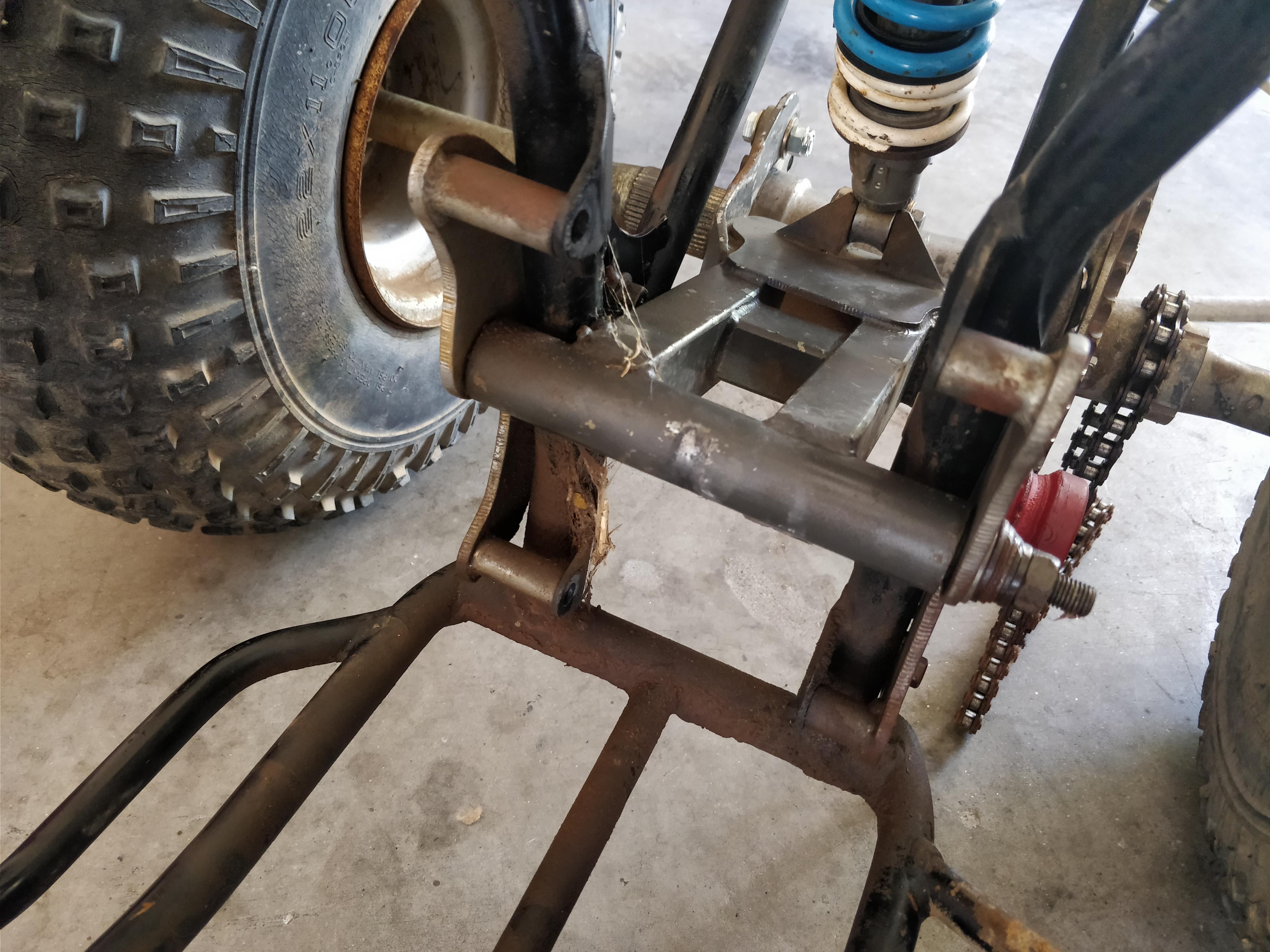

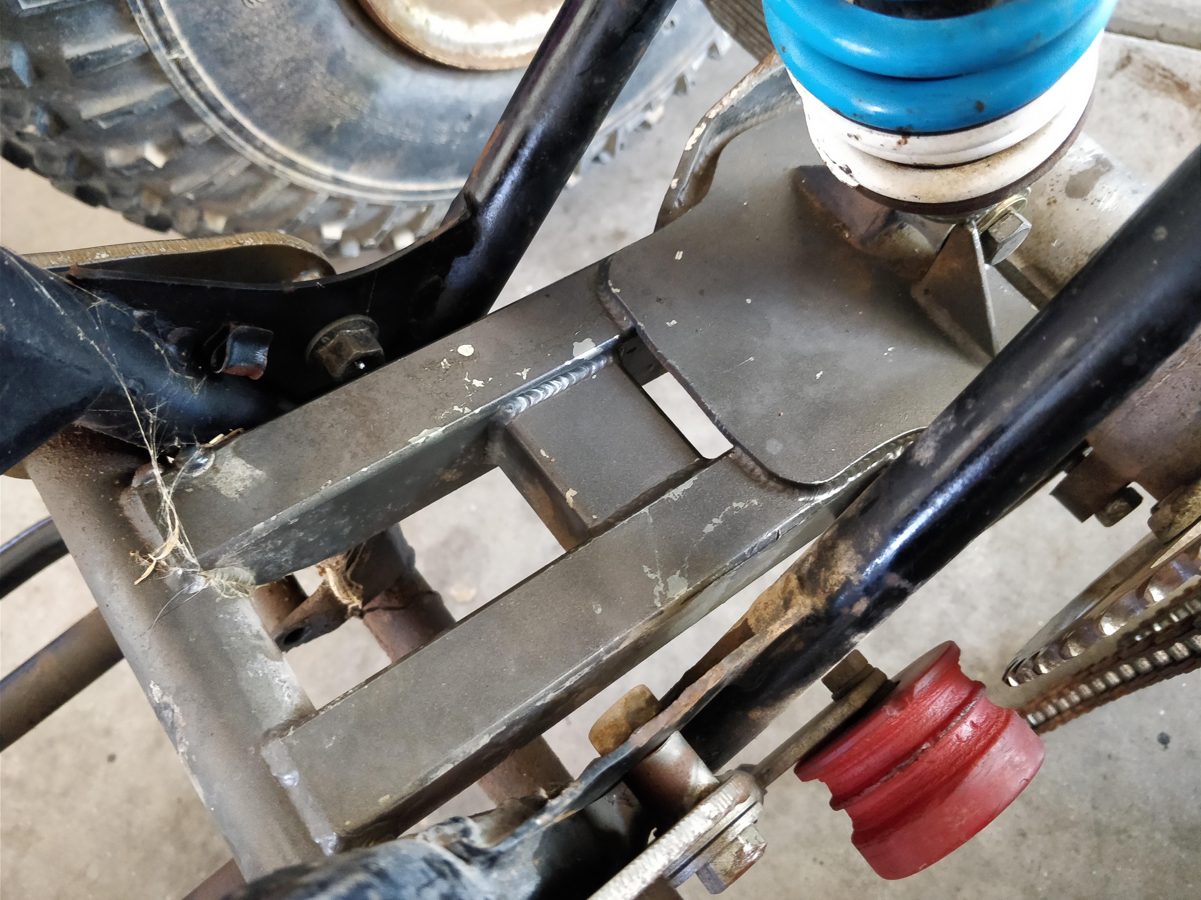

    Does anyone know what suspension kit this is? Or what bearings it takes? I figure while it's torn down, might as well replace the bearings if I can find them.
    I want to also do the carrier/axle bearings. I found some on ebay for $10 with seals, no brand name though. Any recommendations for good replacements?

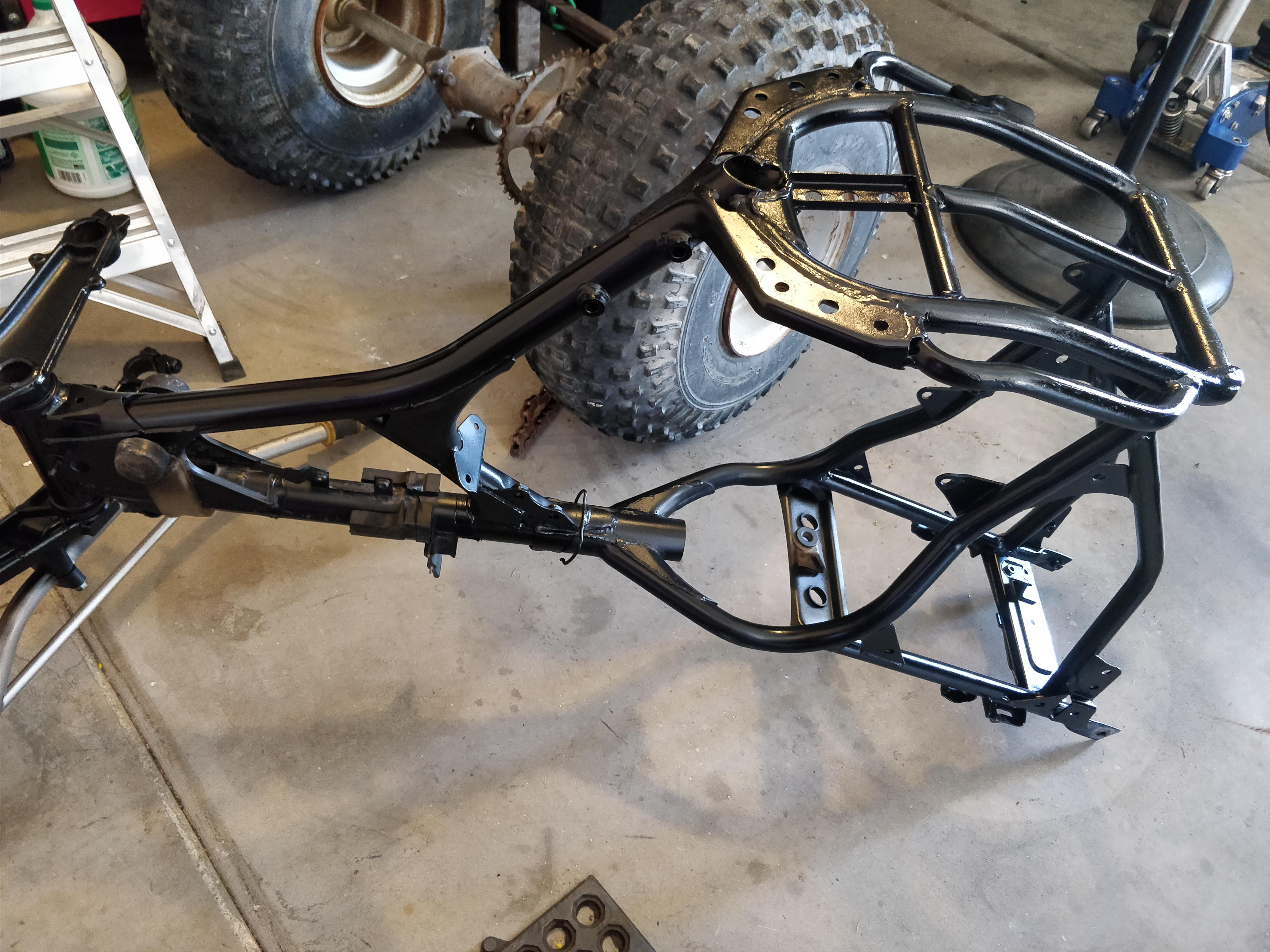

    I guess I'm going pretty deep into this thing, but I really don't want to spend a ton of money, I just figure as long as it's torn down, might as well do it right! Figured I'd throw a quick coat of paint on the frame while I had a chance.
