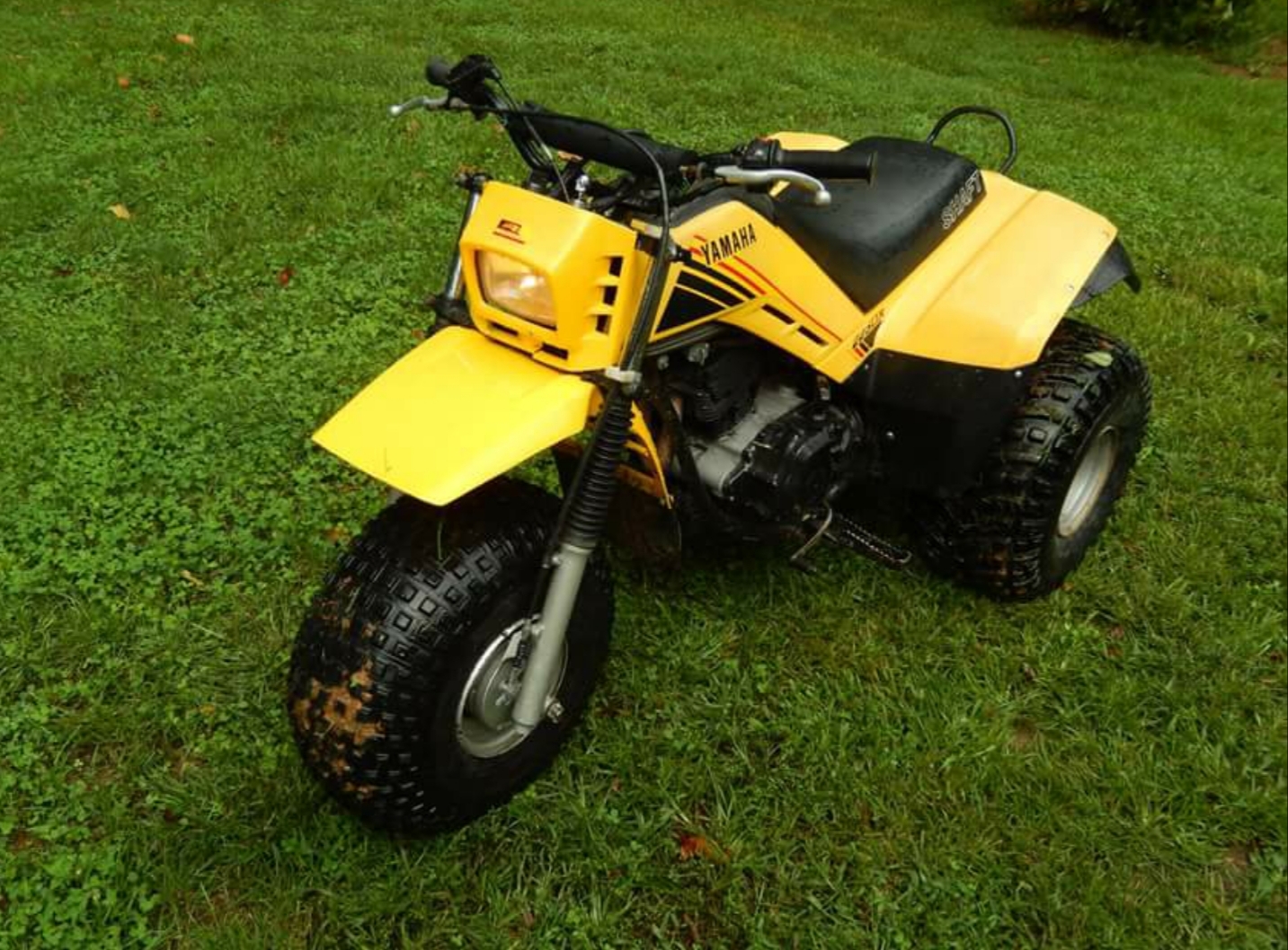

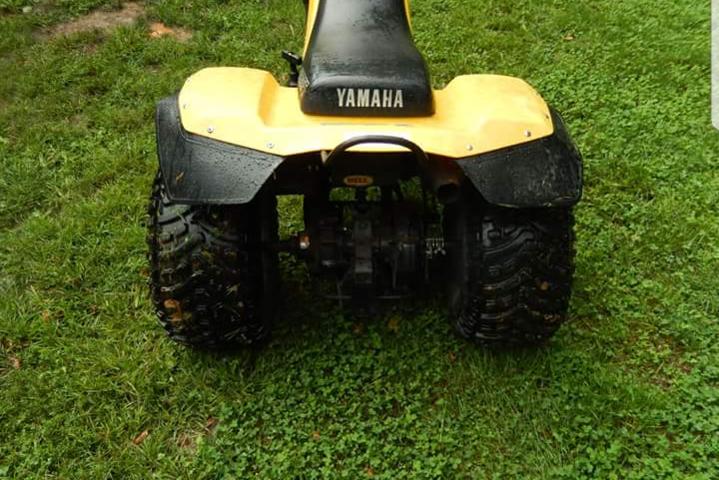

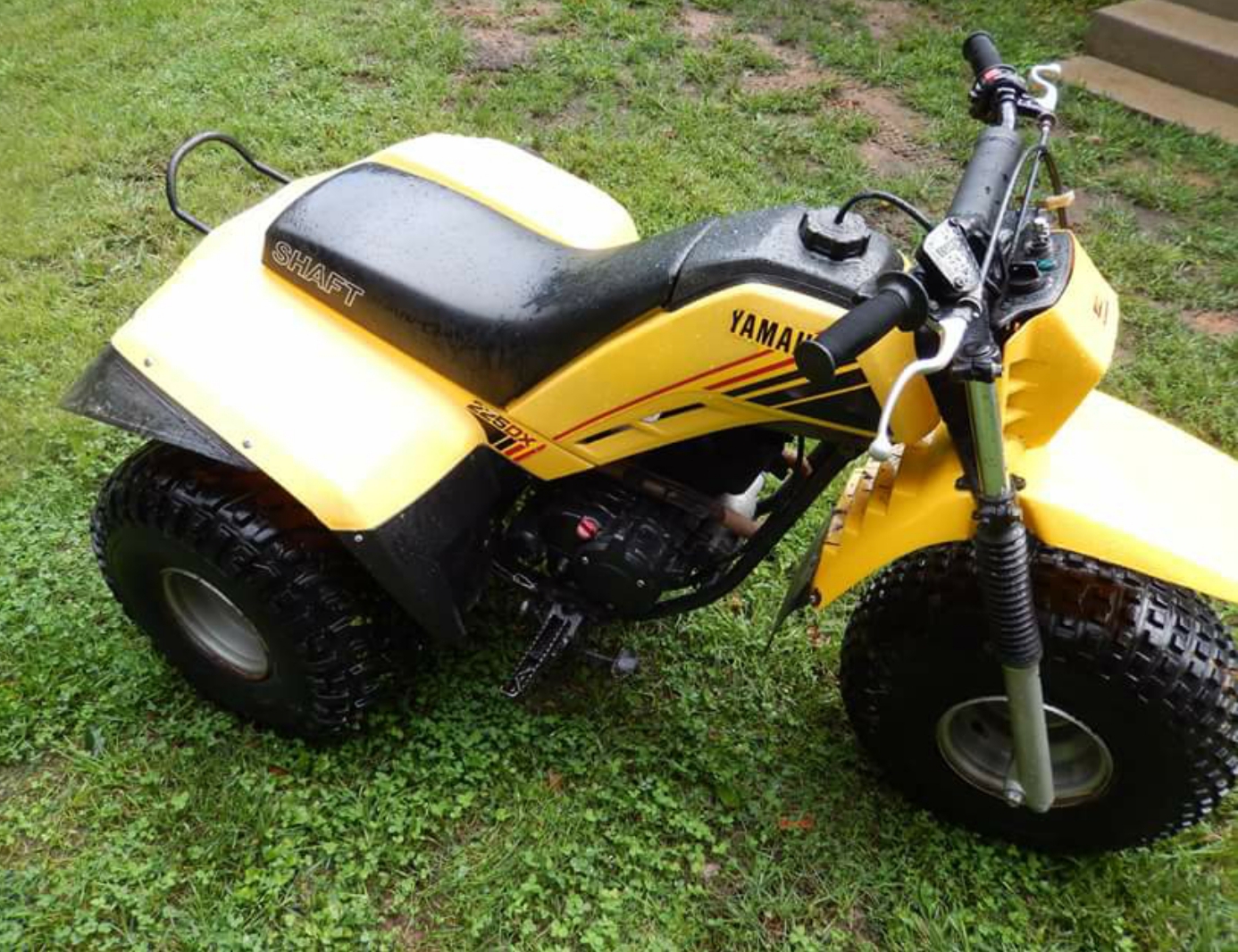

    I got a 225dx a few days ago, looks to have been restored or just a really nice original.
    Has one issue though, it backfires when I let off the throttle. I cleaned the carb and moved the needle down one clip because the plug was black but it still does it. Click image for larger version.

    Usually (but not always) when it backfires while letting off of the throttle, it means that it's running lean. The black plug could be 20 years old and barely firing. I'd try a new plug, put the clip back in the middle groove and see what it does. You should check the air filter too. They weren't great to say the least. If it has fallen out of place or has rotted apart, that would cause a lean condition since you no longer have the restriction of the air filter. This is assuming that it's all stock.

    Update; Set the needle back in the middle and put a new air filter on it. Backfire was better but still there.
    Worked through most of the jet settings but it didn't get any better. So I'm just gonna leave it I guess since it doesn't seem to be running lean by the plug.

    184
