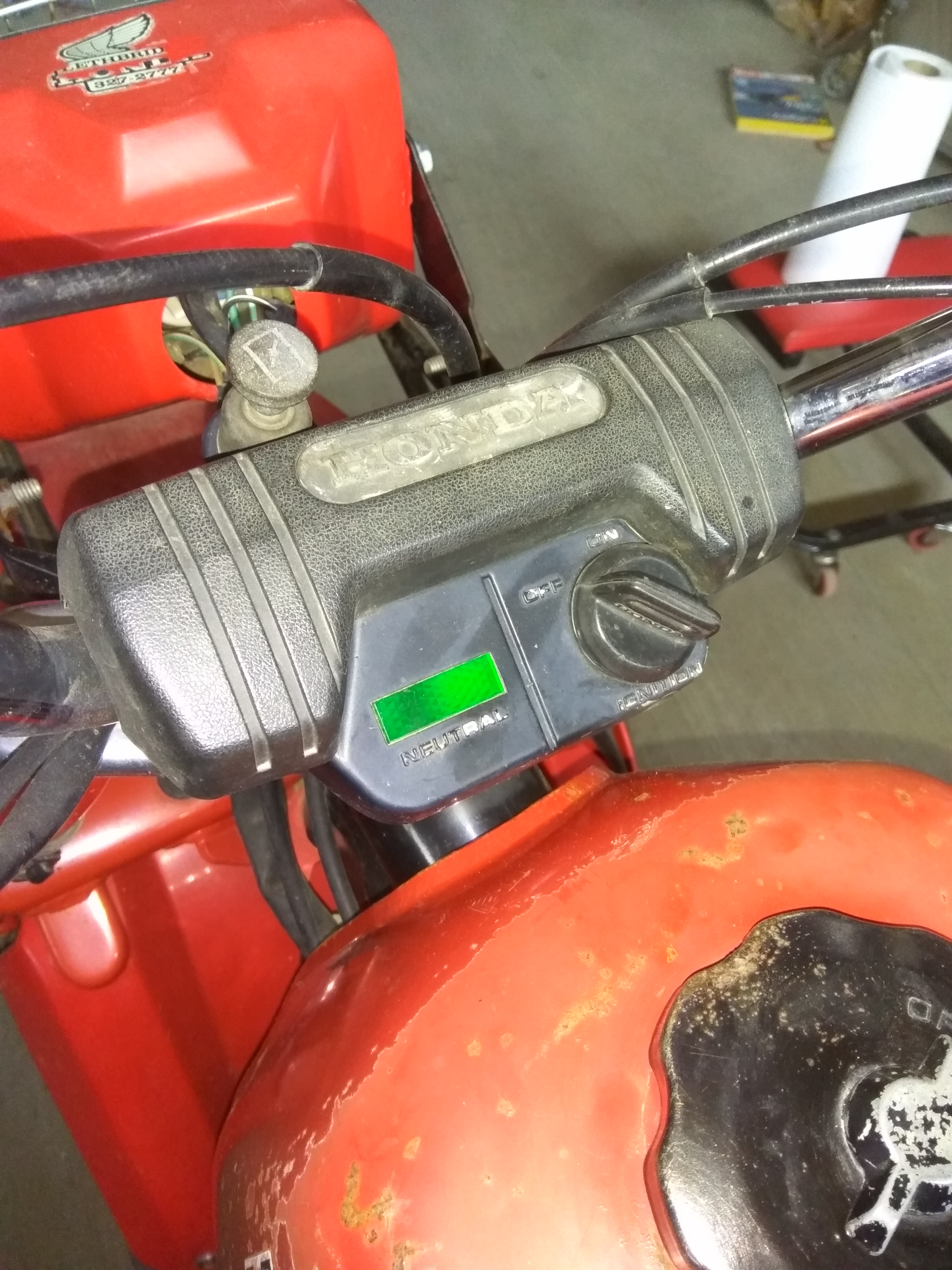

    Hi.
    I'm trying to get to the neutral bulb and need to remove the dashboard (maybe a stretch to call it a dashboard).
    I don't see any screws holding it down but when I pull up I feel something holding, just can't see anything and the service manual has no real info on that part.
    See picture, that's the part with the Honda rubber emblem is what I need to remove. I suppose once that is out I will see how the other part (with the neutral and ignition) is held down.
    Basically I need to check if the neutral light bulb is busted. I know the sender works fine cause I tested it as per the service Manual.
    thanks

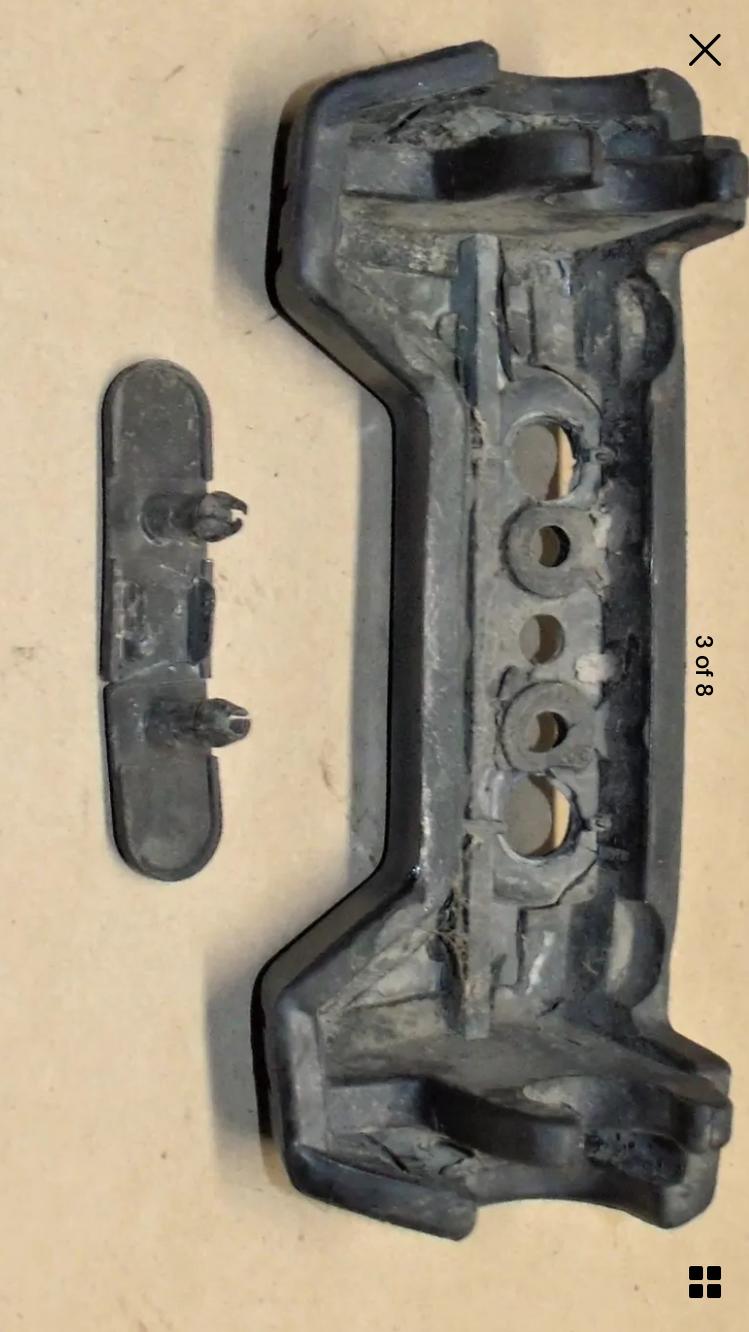

    Sometimes just looking at eBay pics will help: Click image for larger version.
ID:	254575 Click image for larger version.
    Maybe this will help.
    Shep
    Sep 2018
    Calgary,AB. Canada
    25
    Thanks.
    Seems the honda emblem is removable... I hope it doesn't break.. seems brittle..
    I guess under I will find some bolts..
    But before I'll try again if I can get the bulb socket out. Doesn't make sense the handlebar needs to be dismounted just get to the bulb...

    Ok. time to put all tools down..
    with needle pliers I managed to get the rubber socket out..
    The bulb wires were out of place so I put them back and voila!
    The neutral indicator light was working perfectly... but in my anal way of putting things back perfectly (or what I thought) I pushed it a bit too much and managed to bust the bulb and I manage to blow the main fuse
