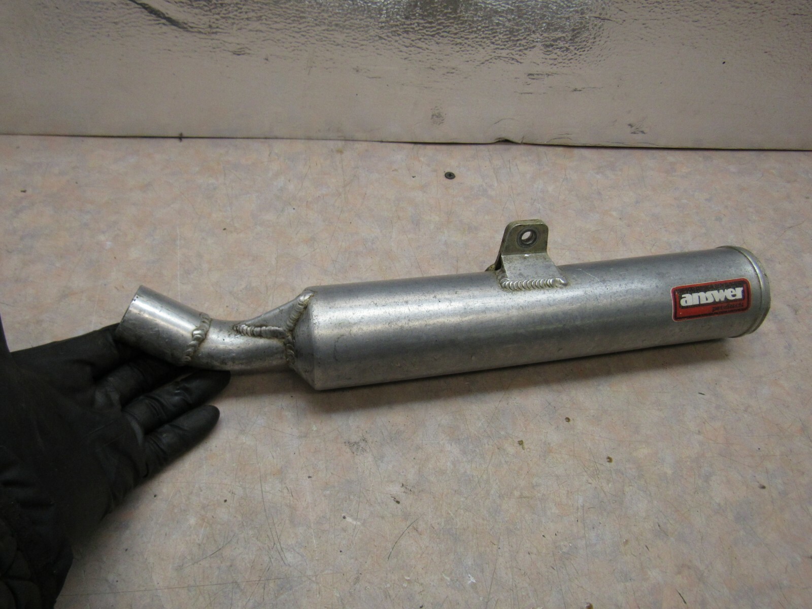

  13. #73
    Aug 2015
    Idaho
    843
    Thanks, forgot to say-that’s the sound of your pipe! The oem pipe I got for free has a hole where it shouldn’t be. Plus, it’s about 100 lbs lighter.
    I bought this after it was posted and started to shine it.
    I’m surrounded by trees and only ride in the forest, although I don’t see a problem running it in the winter, not like much can burn under 6’ of snow. It’s much lighter than my oem muffler, which I need to find out if it has a sparky?
    I’m really amazed how light this R is, already. It’s going to do great in the snow! Which is one of my favorite 4 seasons to be outside, here!
