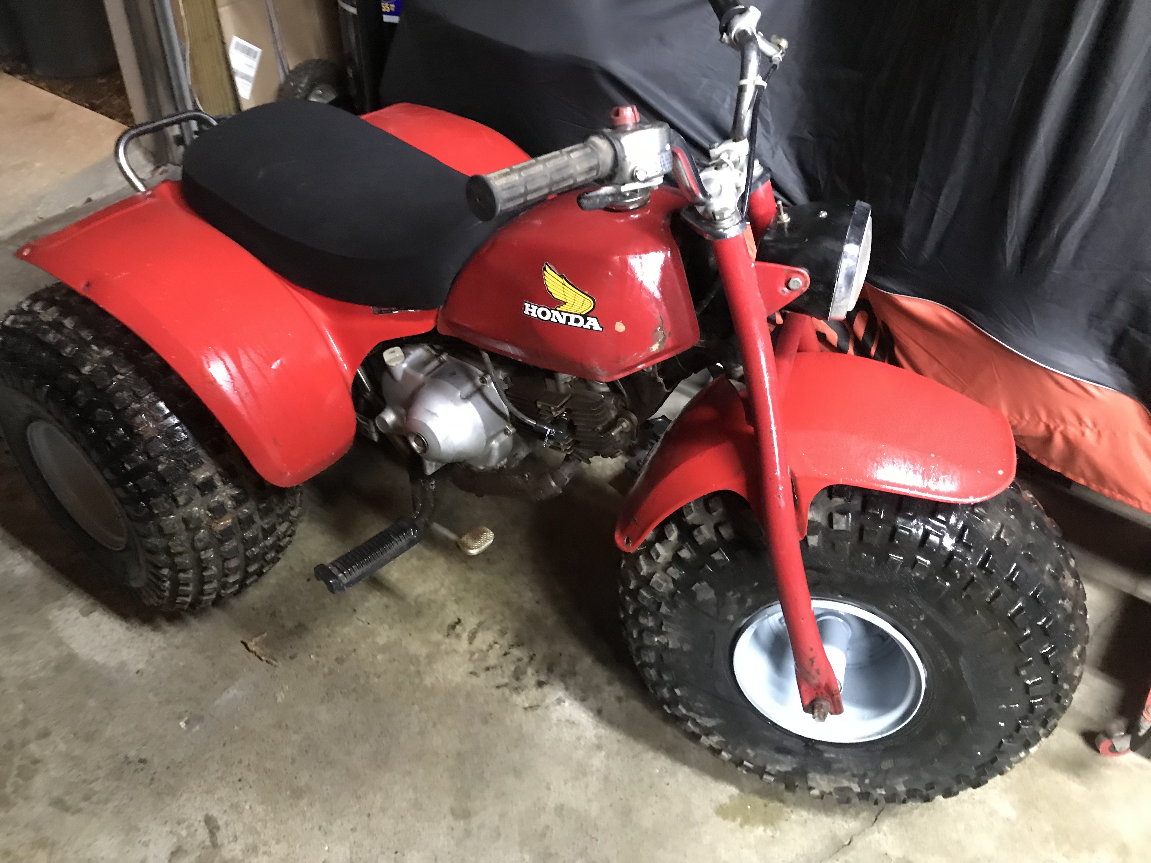

    I found a set of rear fender mud guards for a 1977 Honda 110 . Wondering if they will fit on my 1981 ?

    No such thing as a 1977 110 . The first 110 was made 1979 .
    If their 77 flaps their off an atc90 and their defiantly different .
    79-82 atc110 are the same flaps for reference .
    I may have a set , probably no perfect but usable

    OK good to know. I was just going off what the seller told me . Let me know if you have a set please.

    I also need the headlight . Mine has one but its not OEM at all .. I would even use one from another year Honda if the width is same ? Needs to fit between the stock ears .

    Head light on the 81-82 110 is 12 volts and the same but a 185s / 200s light should work and will broaden your search .
    80 and older is 6 voltes

    I would have repainted and wired the light that came with it. However as you can see in the picture he put the switch inside the light , It also was being used as the kill switch. The wires had pulled out of the factory one which is still on the bar thank goodness.
