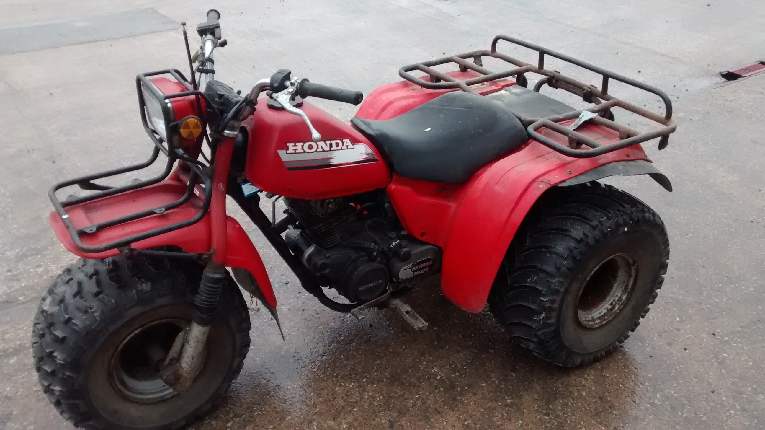

    Dragged the 200es out the shed today to start the engine rebuild, all been well the motor will be out by night !!

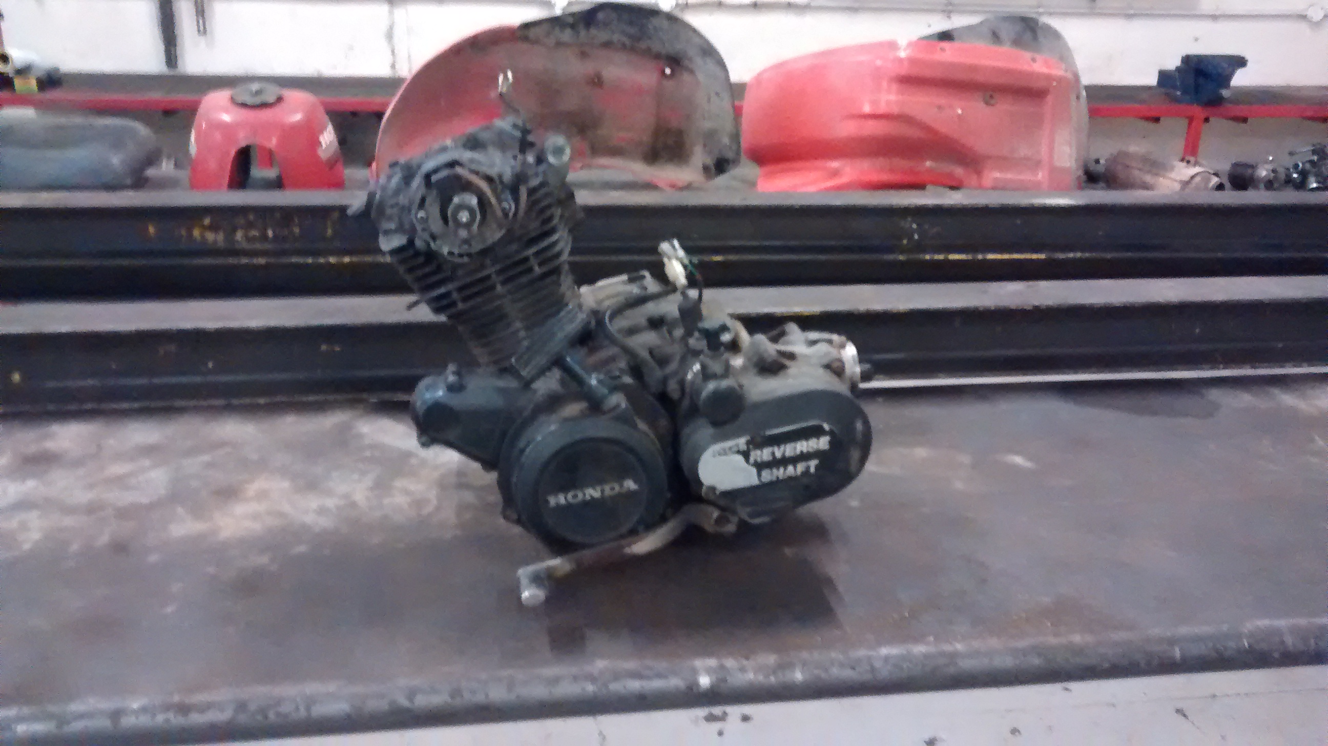

    Success , Motor out a hell of a lot easier than a 1982 200 chain drive I had done last time, just dropped the starter off & it slipped out the front to the left hand side, once everything was undone, " Happy days " can't wait to get inside her !!.
