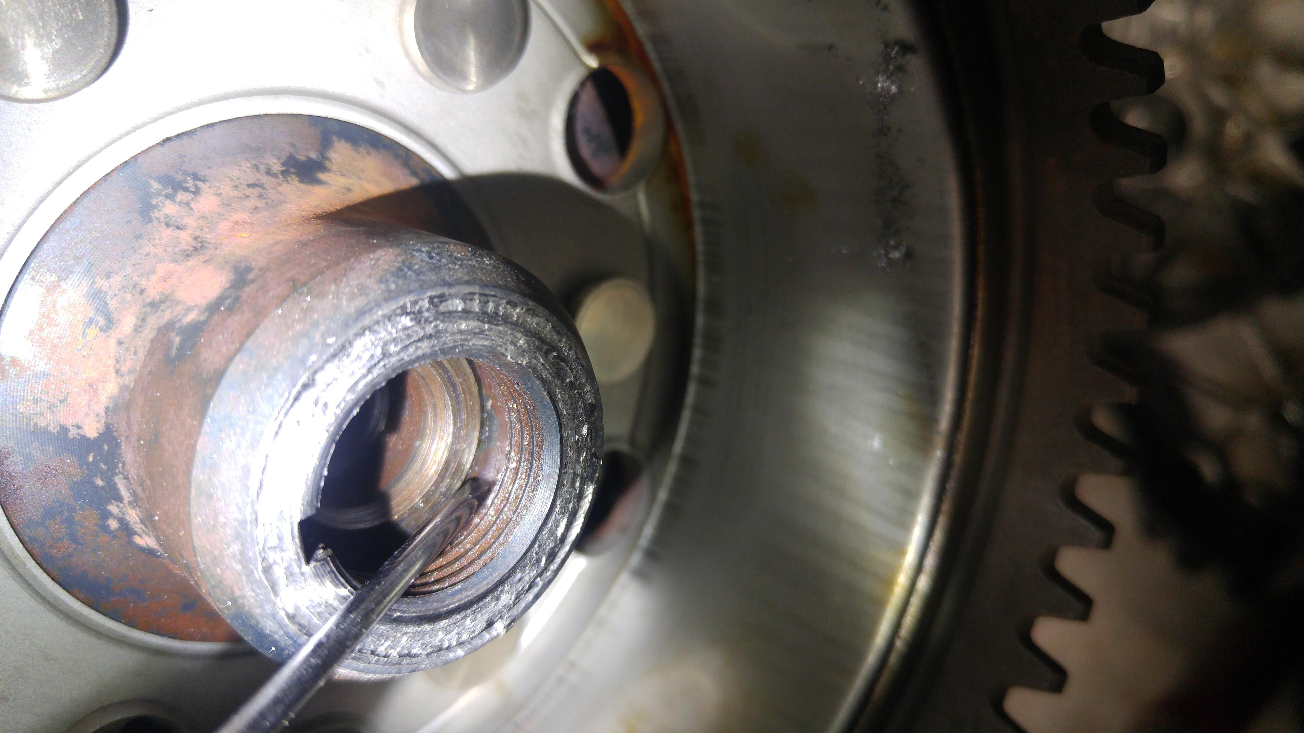

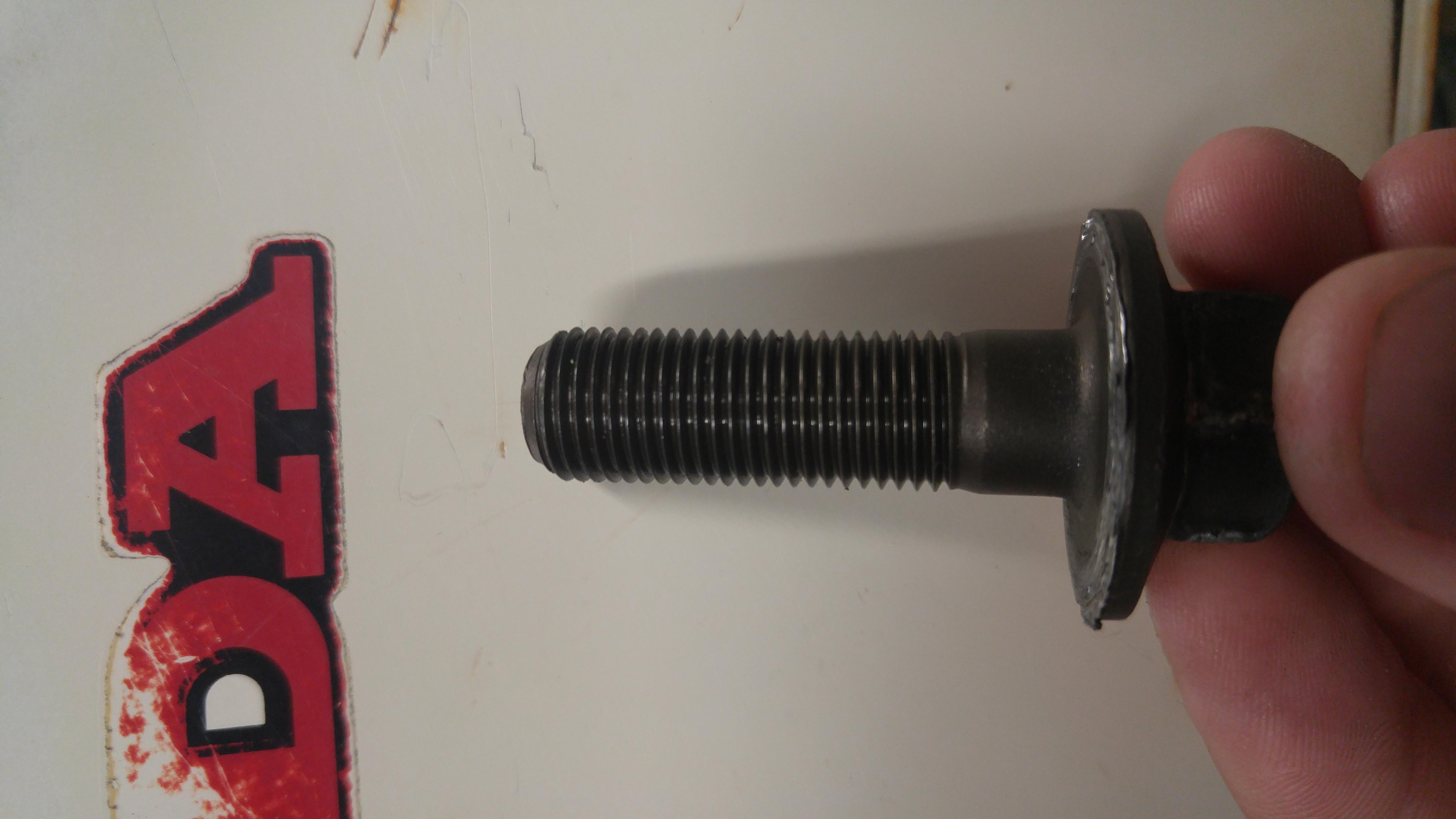

    Im tracking that there is a difference in the goki years. I do not know which i have hopefully it is the correct one but will not know untill i install it and line everything up. But i can not get the flywheel all the way on to the shaft. No the bolt is not cross threaded and no the threads are fine. Yes i can take the bolt out. One pic is of the center bolt you can see the bottom of the head how i said was wearing away as i tried to use the impact wrench. The other pic is of the flywheel with a screwdriver in the gap poing out all the further i can get the flywheel on to the shaft. I know it has to be fully seated but can not get it all the way on. Any suggestions?Click image for larger version.

    Did that flywheel come off that trike ?. I see a lot of Goki kits that already have the gear pressed on the flywheel, meaning that flywheel may be for the wrong year. The 85 and 86 have a different size taper.
    If YOU took that flywheel off and pressed the gear on the only thing I can think of right now would be an issue with the key and the key slot not fitting right, either buggered up or not lining up. The flywheel should just slide on and the bolt only used to keep it there. It's a tapered fit there should be no resistance until it's all the way home.

    I'd say to pull the fly wheel again and see what's going on. Like pointed out above, it should go on by hand, and the bolt is just there to set it tight on the taper which barely moves anything. It's not a press on type of flywheel.
    I think it's important for us to know if this flywheel was on this engine and was working correctly before attempting the Goki install.
    Looked at the photos, and it looks like it's close to being on fully, so maybe it's the 85 vs 86 difference. I've read as a set the flywheel and stator can be swapped as a whole unit, never saw any mention the tapers were different till now.
    Might be worth while test fitting the side cover on and looking where the starter hole is to see how close it looks to lining up. If it's close, testing the gear mesh pattern might be the best action. If it's not right, then there's something going on with the taper/key area.

    Thanks for all the input guys. But this is the one that came off of the machine, by me. And i double checked the key and key slot nothing is interfering.
    Is it possible your flywheel is contacting something on the inside or along the inside edge? If you get that bolt snug, to the point you say it's putting up too much resistance, can you still turn the flywheel back and forth or is binding on something?

    I'm thinking it might be fully seating, but the details of it is lacking in the manual probably. Just an FYI, the crank shaft doesn't end up flush with the bolt surface, there's going to be threads exposed on the flywheel for the puller. I haven't been around enough flywheels to identify if the photos are of the fly wheel all the way on or not.
    Like I said in the post before, does the side cover interfere at all? Ring gear location look about right though the starter hole? It very well could be on all the way already. It's hard to judge though photos for us, so kind of has to be checked in person. Sadly I don't have a 350x engine laying around to see the depth for the shaft vs flywheel surface or I'd snap a photo of what it should look like.
