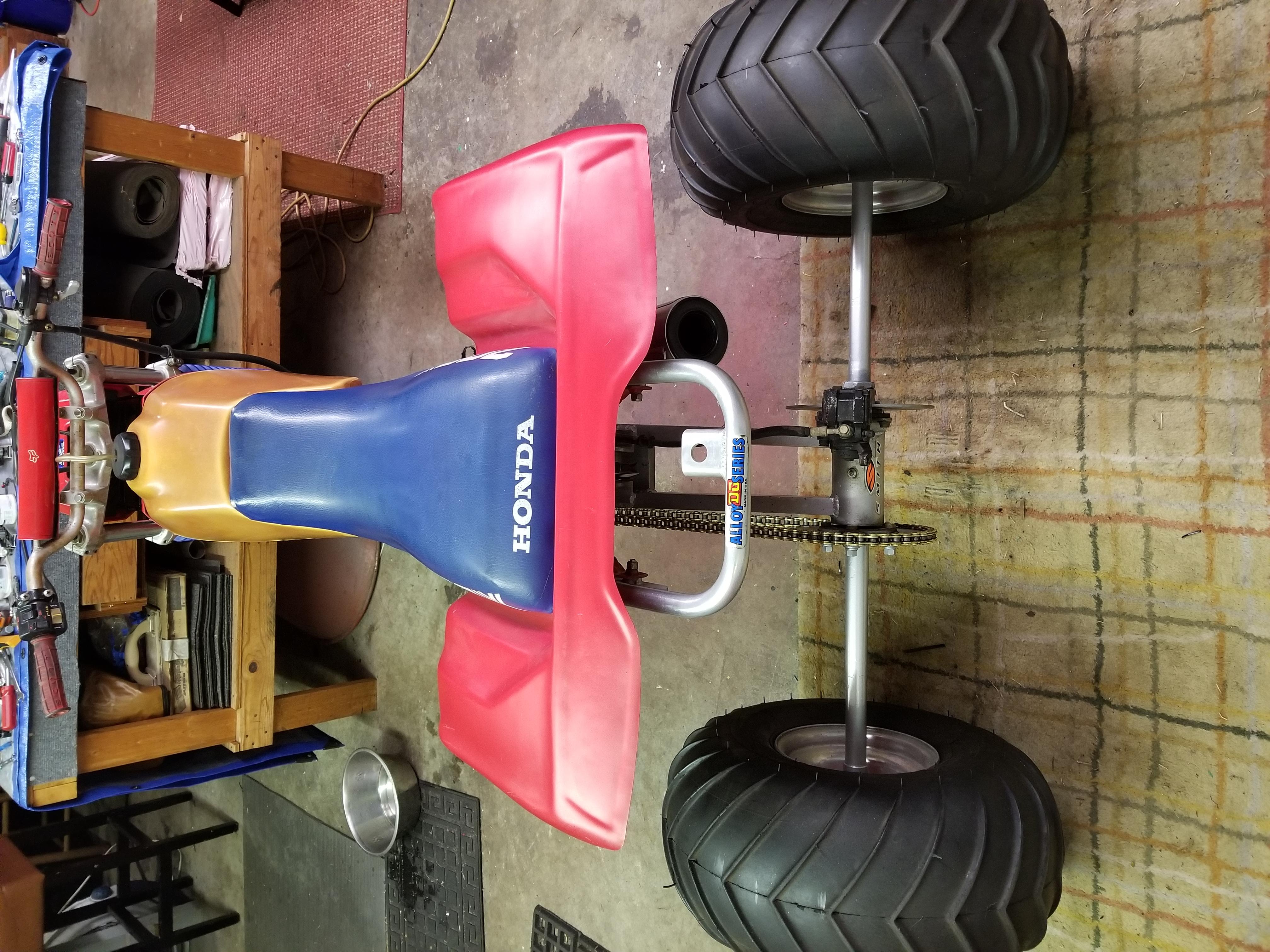

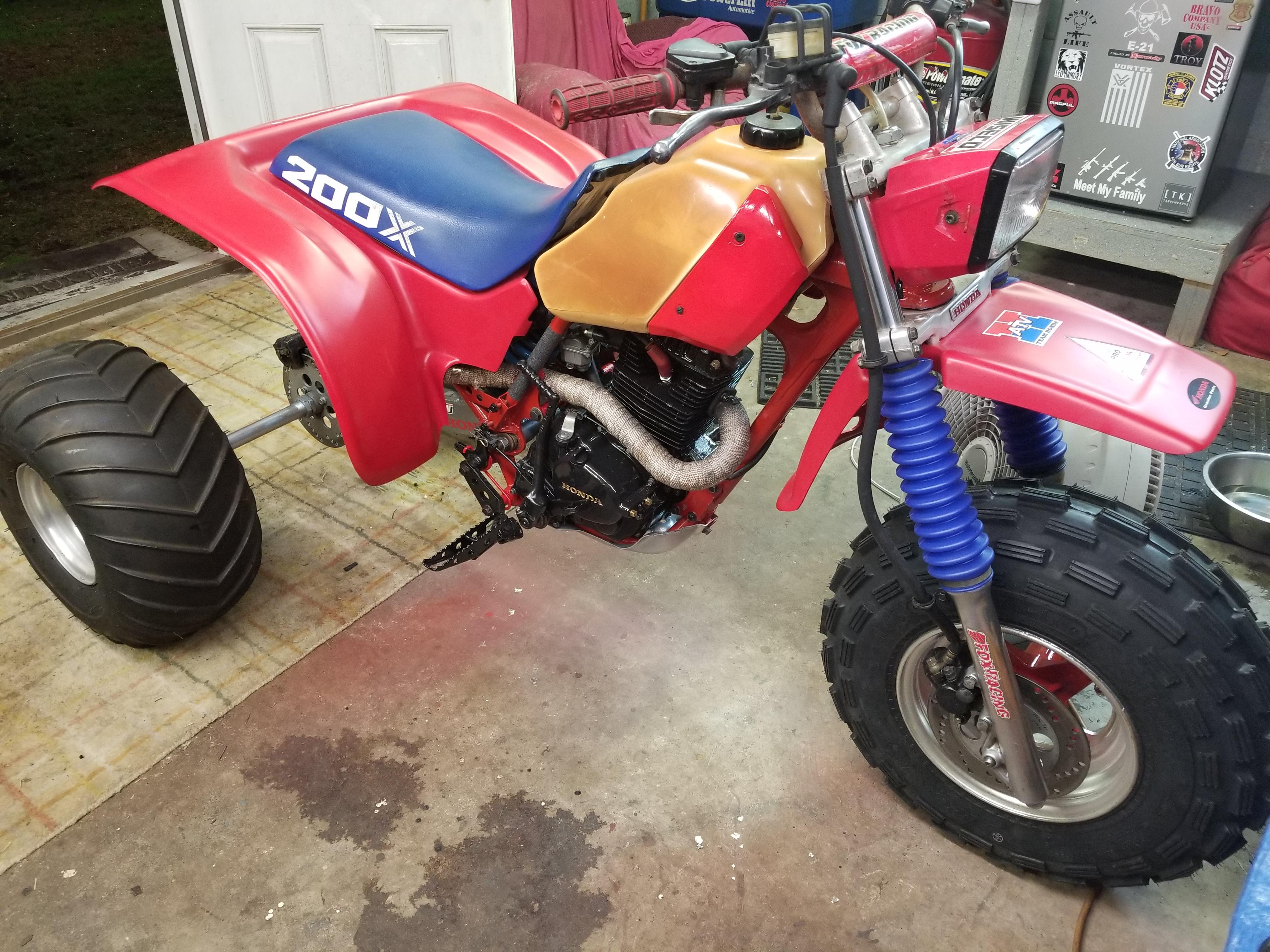

  13. #58
    Nov 2018
    NC
    87
    Scored an original 85 tank, no dents, and a few other parts, now I wait for them to arrive. In the mean time a few pics of my progress.
ID:	256494   Click image for larger version.
ID:	256493   Click image for larger version.
