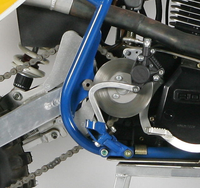

    You're correct, if the chain breaks or comes off, you lose the rear brake. That's no different than a beach cruiser bicycle with only a coaster rear brake, except for the speed, and the same for a fixed gear bicycle if the chain breaks, no brakes at all. You'll still have a front brake though.
    I ain't no Polaris expert, but I knew what type and where the rear brake is. It's not hidden, you can see it. A brake on the crankshaft would fry really quickly, because of the RPM, and there's other issues with that location. BMW (motorcycles) tried putting a manual clutch on the crankshaft, and it worked OK except for hard use, where it would fail prematurely.
    It's still a disk rear brake though, regardless of where they put it. The size is because it's on a transmission shaft, there's a gearing advantage compared to directly on the axle. It's not exactly a one-off design either. Other machines have used a brake on the transmission or output/counter shaft.
    ATK motorcycles (made in USA) put theirs on the countershaft. They also used a type of anti-squat drive for the chain, in an attempt to prevent engine torque from affecting the rear suspension. Neither is in use today, on production machines, and I'd guess, for reasons.
