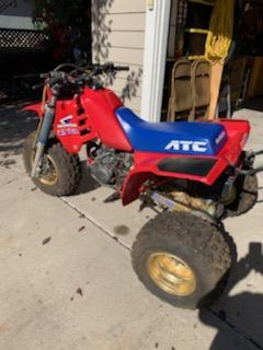

    Thank you again everyone I really do appreciate all the help. now that the holidays are over I think I can find time to start tackling all this. And the service manuals was a great help, I went downloaded that thing right away, very much appreciated!!!
    Here is a few pictures of the bikeClick image for larger version.

    MAN! Is that thing ever NICE!
