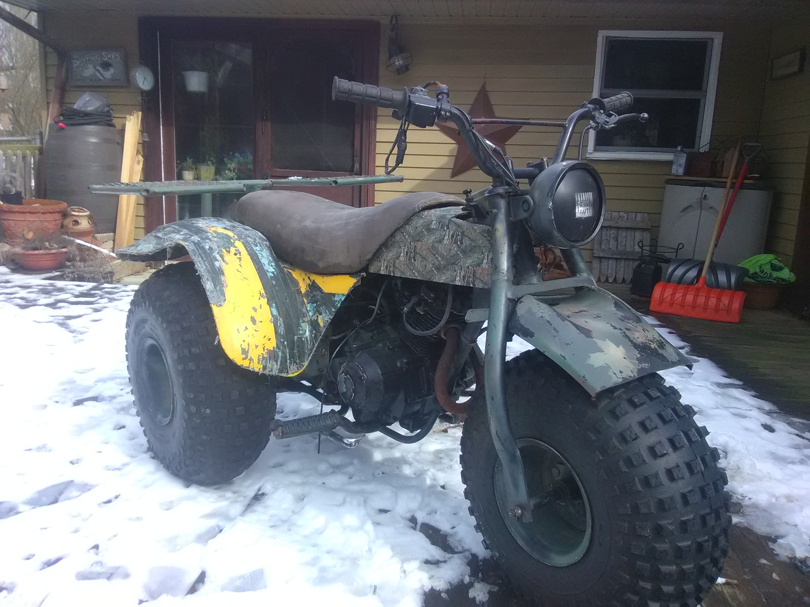

    Ok well I traded my Moto 4 for a 83 Suzuki alt125 the guy said I had carb problem well I fixed that problem by ordering the carb kit all original, it started up ran like crap then ran fine now it won't start, it's getting good continues spark getting fuel to the motor great compression timing is right and no vacuum leaks, not sure what's wrong with it, could the points be bad on it, any tips would help alot,Click image for larger version.

    You said it's getting fuel but I just had to ask. The fuel pump is OK?
    Yes the fuel pump works fine, I'm starting to think it's the spark plug cuz it's getting spark just do t know if the plugs failing under pressure cuz last time I rode it it started acting up then it would just idle then it wouldn't started sanded the plug down started right up ran fine. Now it won't start
    Have you adjusted the valves? I'm not positive that would be your problem but it's feasible. Either way it's a good thing to have your valves adjusted properly.

    Good point haven't checked them. I'll get to it
    got it running valves were a little loose ended up checking the plug again and only being 3 weeks old it was shot replaced it, The thing runs fine now thanks for the tip
