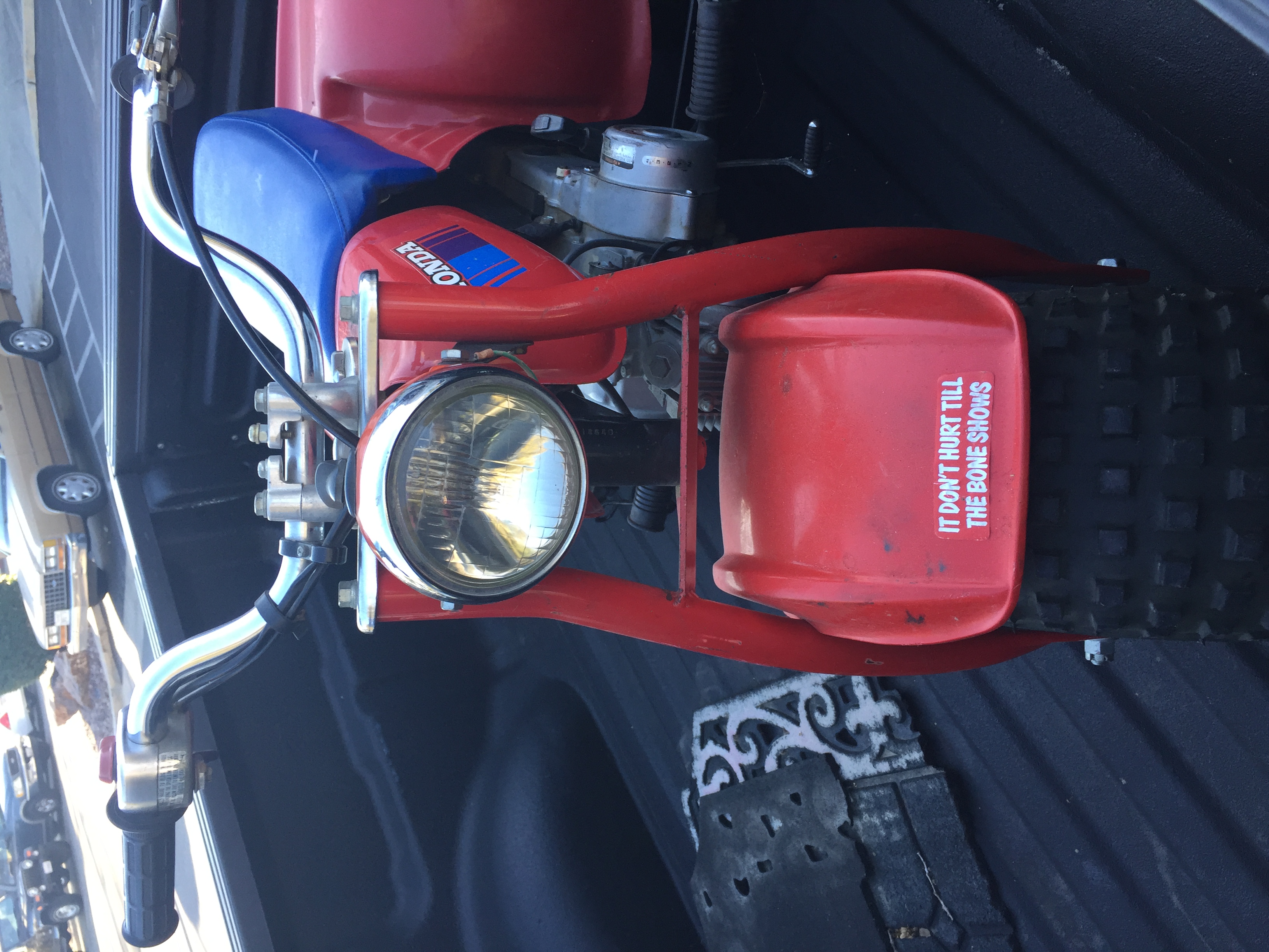

    Slow down tiger, lol. Simple things first:
    a) my guess is the carb is fine but may need to be set to factory specs. The carb may stop leaking once some fuel sits in it and the float is adjusted. Also if the two carb bowl screws are tightened too much it'll distort the top of the bowl causing the leak issue. You'll need a flat edge to check true; but it's easy to fix. Do you have the manual?
    b) try running it with the gas cap loose; it may be plugged up
    c) unscrew the spark plug wire boot and clip off a 1/4" of the cable and screw it back in
    d) is the plug the right one?
    b) the points are probably dirty or off.
    e) If the exhaust is fine I wouldn't change it; you're looking for some jetting woes. These things can be finicky to dial in on a good day.
    Report back with pics!

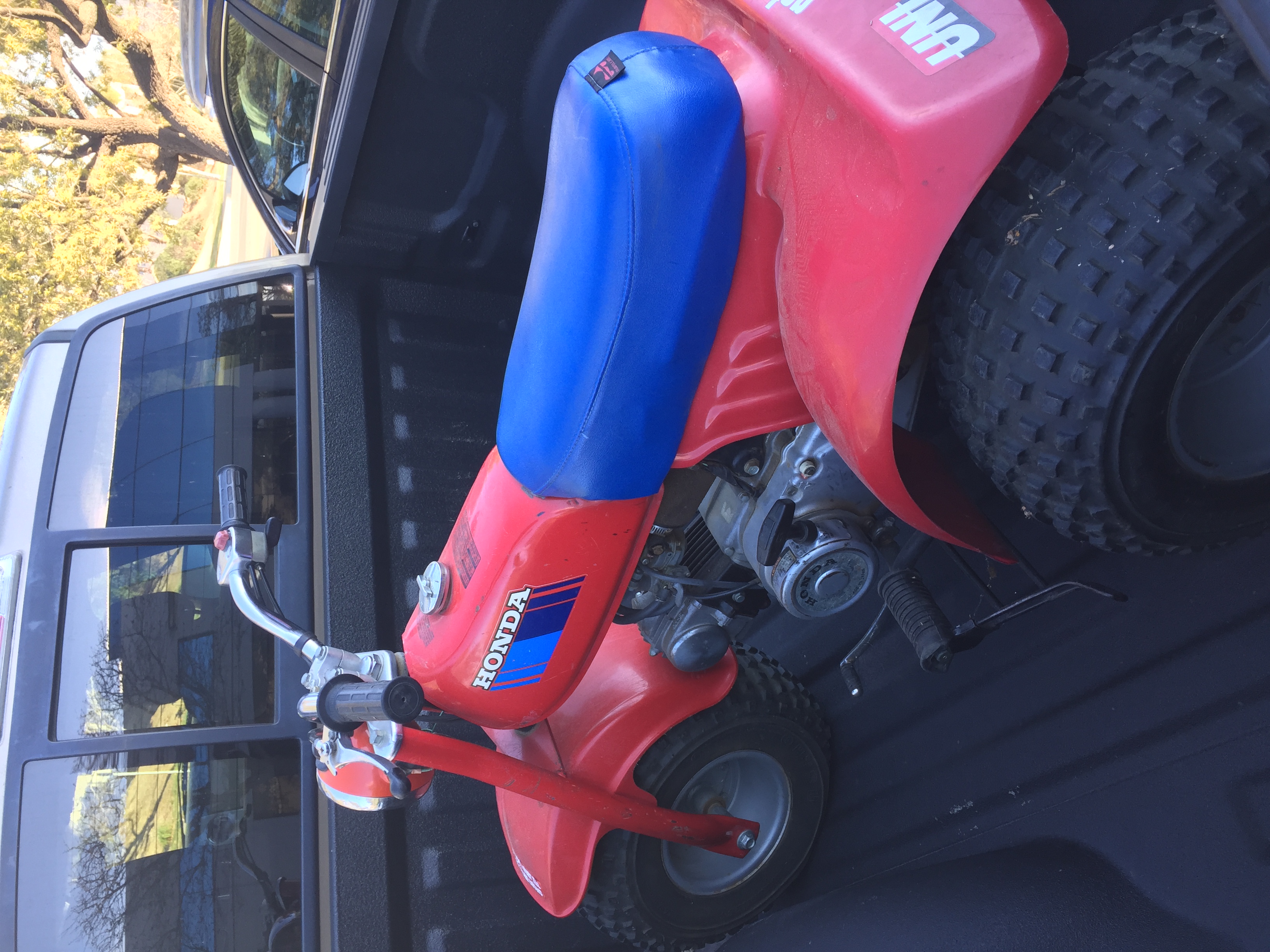

ID:	257221Hey coolpool, thanks for the response!
    I adjusted the valves cold at .002", checked the points and timing, seems good. The plug is the one that was in it, NGK C7HSA, but it is pretty dark. I'm buying a new plug Monday as long as I can find one locally. Clipped plug wire and threaded back together. Ran it without gas cap, doesn't seem to make a difference. Worked on it tonight with a buddy, still not running right. Fires on first pull, idles perfect, but falls on its face under load. Runs pretty good with choke half to fully closed. Carb is no longer leaking, and is clean, pilot is #38, and no blockage, main jet is #58, no blockage. As stated, new e posed uni filter. I swear it seems likely me it's starving for fuel, pops and backfires until I choke it, which is cutting back air, then seems to run pretty damn good. Frustrated and at a loss right now! Was hoping to have this dialed this week, we are leaving for Ocotillo Friday AM. Any suggestions?

    Now for the update: took the carb apart, put a 62 main in it, left the stock 38 pilot, retuned the carb, put a new NGK plug, seems to be running really good, no popping or backfiring. The choke actually stalls the engine now. Was to late to take it for a test ride, hopefully tomorrow.
