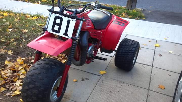

    Carthage NY 250r rules
    2,355
    Get a 230 quadsport rear rim either gold or silver with slight fileing bolts right on.its 9 inch if you want 10 inch get 85 or 86 quadracer rear rim.I have ran this quadsport rim on my 81 250r for years Im using 82 250r front hub same bolt pattern as 185s 200s.Click image for larger version.
