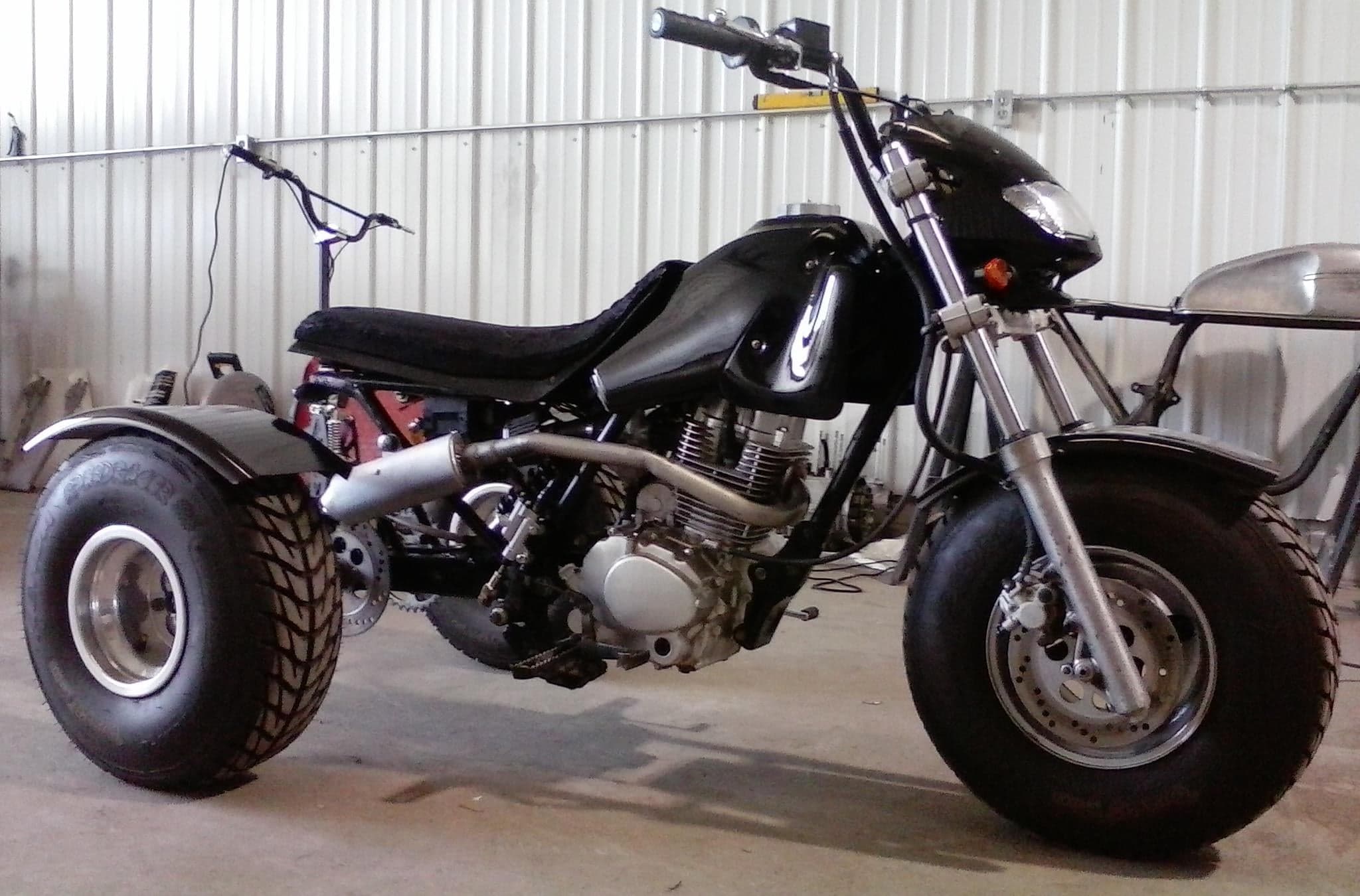

    These motors are excellent. Shortline it is the 90s and 110 atcs that need an adapter, these motors will bolt right in like bob says. Any doubts in chinese built motors are unfounded. It's the electronics that are sub par.
    This chinese engine ran perfect for 1300 miles over 5 days through the desert and mountains, and another thousand past that before i sold it running like new. Click image for larger version.
    233cc with reverse. 70mph top speed.
