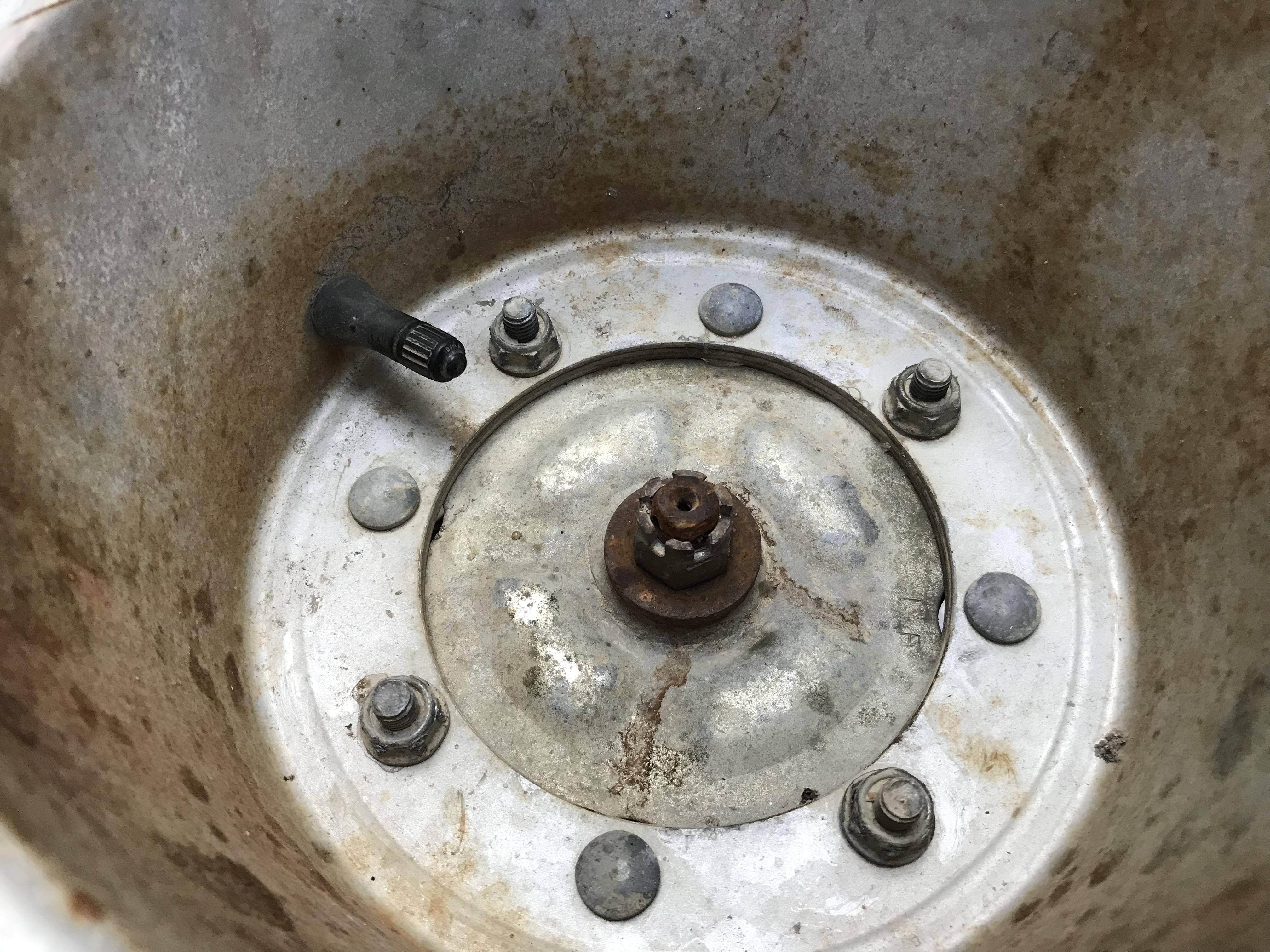

    Okay will do, I appreciate the replies. It seems to be coming from in front of the smalll sprocket behind the subtransmission. I tried to get a closer look by pulling wheel off but whoever had it before me rounded the bolts on both wheels. How do you guys suggest to get them off? And obviously replace -Jake

    Depending on the space around the bolts you might be able to get vice grips on there and turn them with channel lock pliers or a big adjustable wrench, another option could be cutting a grove into the nut if the hub bolts don’t protrude past the nuts, and using a large flathead screw driver, one with a four sided bar not circular and using a large adjustable wrench to turn the screwdriver, you’re going to want decent leverage. If you post a picture of the rim showing nuts and space around them we’ll have a better idea of what your best bet. I’m sure there are other ways I haven’t thought of. There are sockets and different things specifically for stripped nuts / bolts but I’ve never tried them, maybe someone else has and can speak to their effectiveness or has another idea. I’ve cut groves into stripped phillips screws on cases before and got them out with a flathead screwdriver, and gotten lots of stripped bolts out of things with vice grips
ID:	257756 simply can not see where the leak is. It’s such a tight spot, I think I’m going to have to remove sub trans. I’m going to check the OEM diagrams and see if any seals are involved like suggested and check my bolts. But that is my what both my wheels look like. I think the vice grip idea may work too windy and mucky out to try today. Am going to be working on it tomorrow so let me know what you think the best approach is

    Yes it definitely looks like there’s enough space for vice grips, might have to be the thinner ones though. Good luck

    I have another thing that you could try. Take a GOOD QUALITY impact socket that's a little bit smaller than the normal size. Put it on an extension and, using something such as a dead blow , drive the socket onto the nuts. This will do two things,give you clean edges for the socket to bite on plus the vibrations from the driving will help to loosen the nuts slightly if there is any rust holding them on. From my experiences, which don't include a 125, these nuts are 12mm. I'd try a 11mm socket.
