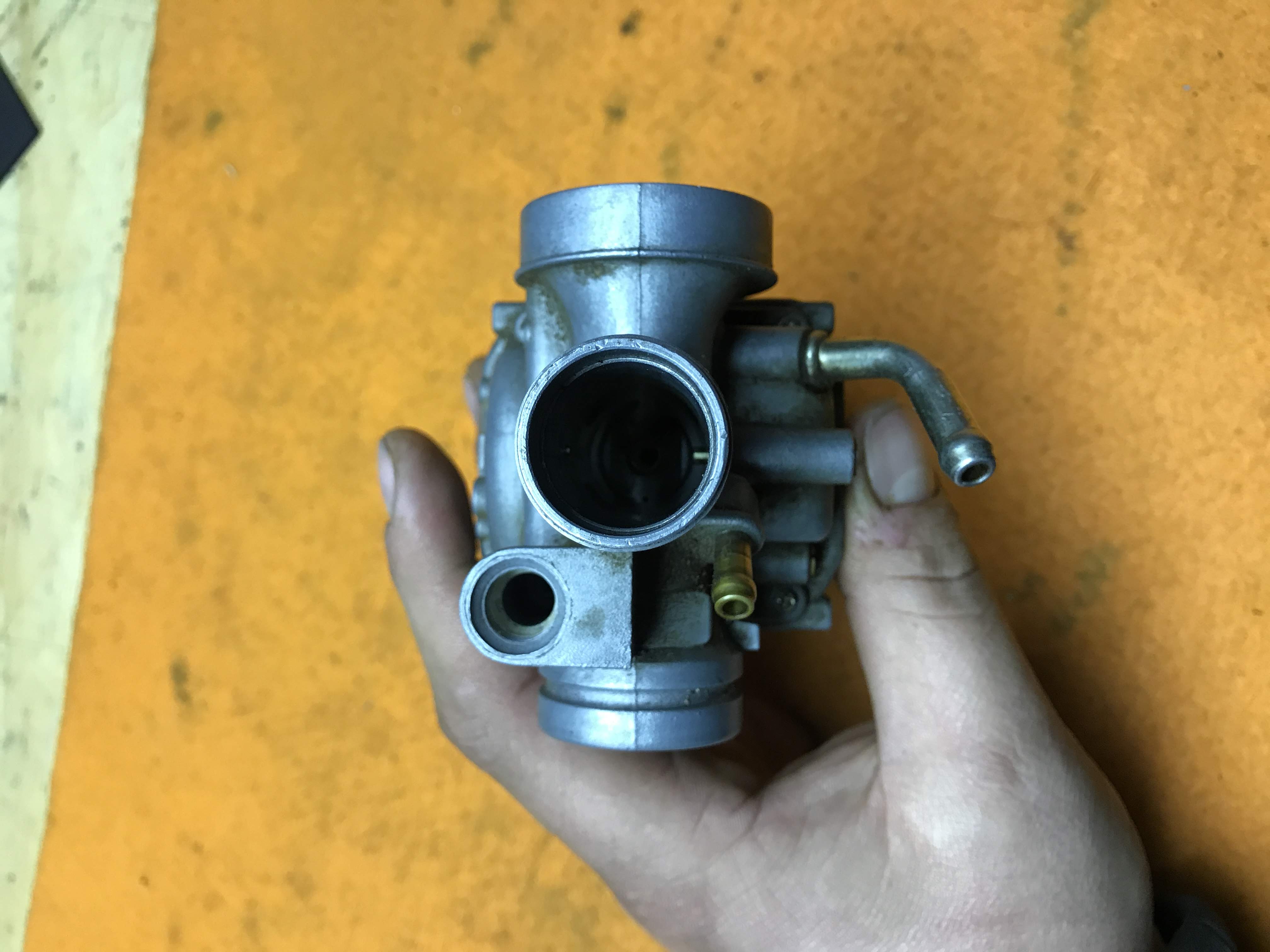

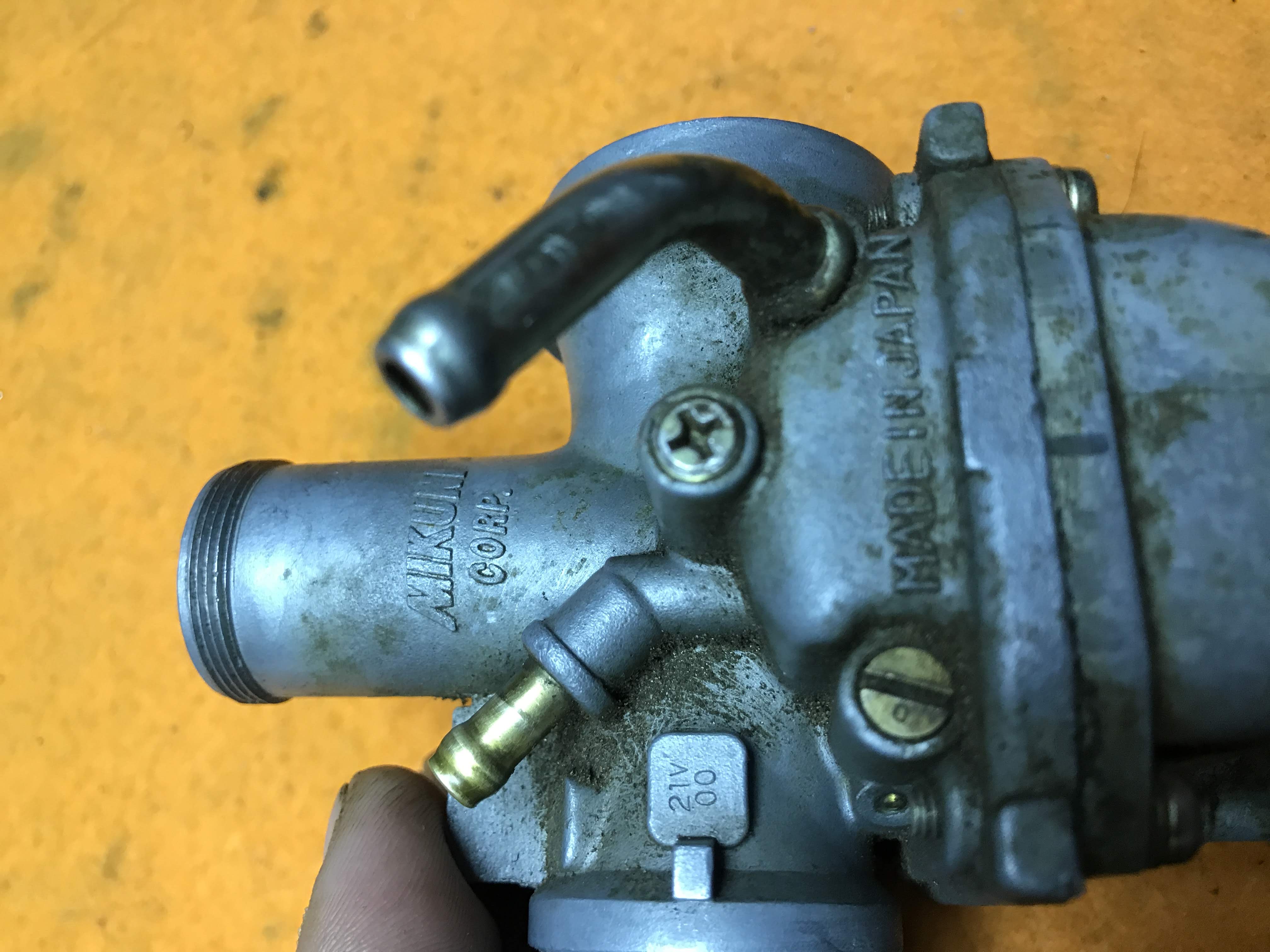

    I recently underwent the task of trying to get an old family YTM 200 up and running and seem to be running into carb issues.
    I purchased what I thought was a direct replacement, but has a bolt on connection versus a clamp on connection.
    Here are pics of the old carb...

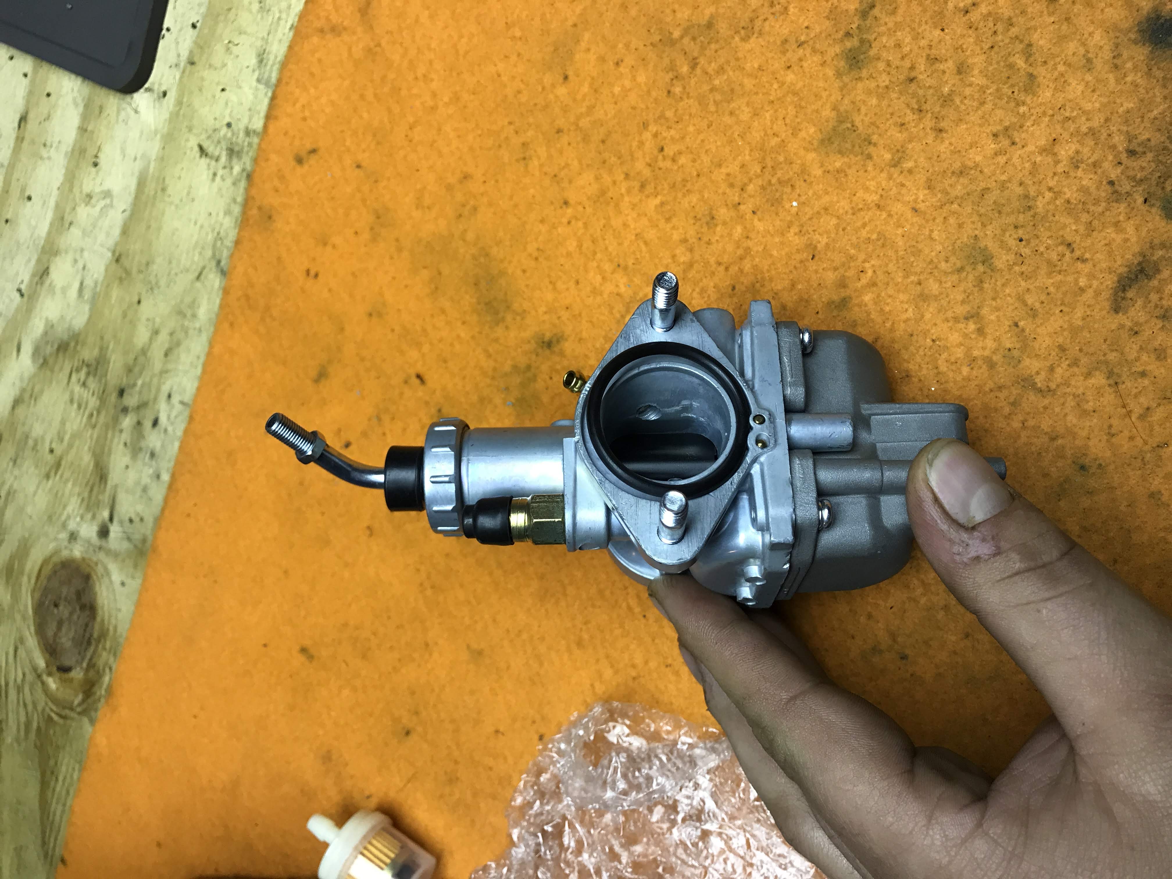

    Here is a pic of the replacement i received
    From what i gather, Yamaha switched from clamp on to bolt on somewhere around 1983 or 1984.
    Can i use the new carb with some sort of adapter?
    Thanks
    Chad

    I'm no expert, but I'd bet that you could buy the intake (the piece that bolts to the engine that the carb bolts to) and use it that way. The cheap, Chinese carbs don't always work well. Their quality seems to be hit and miss.

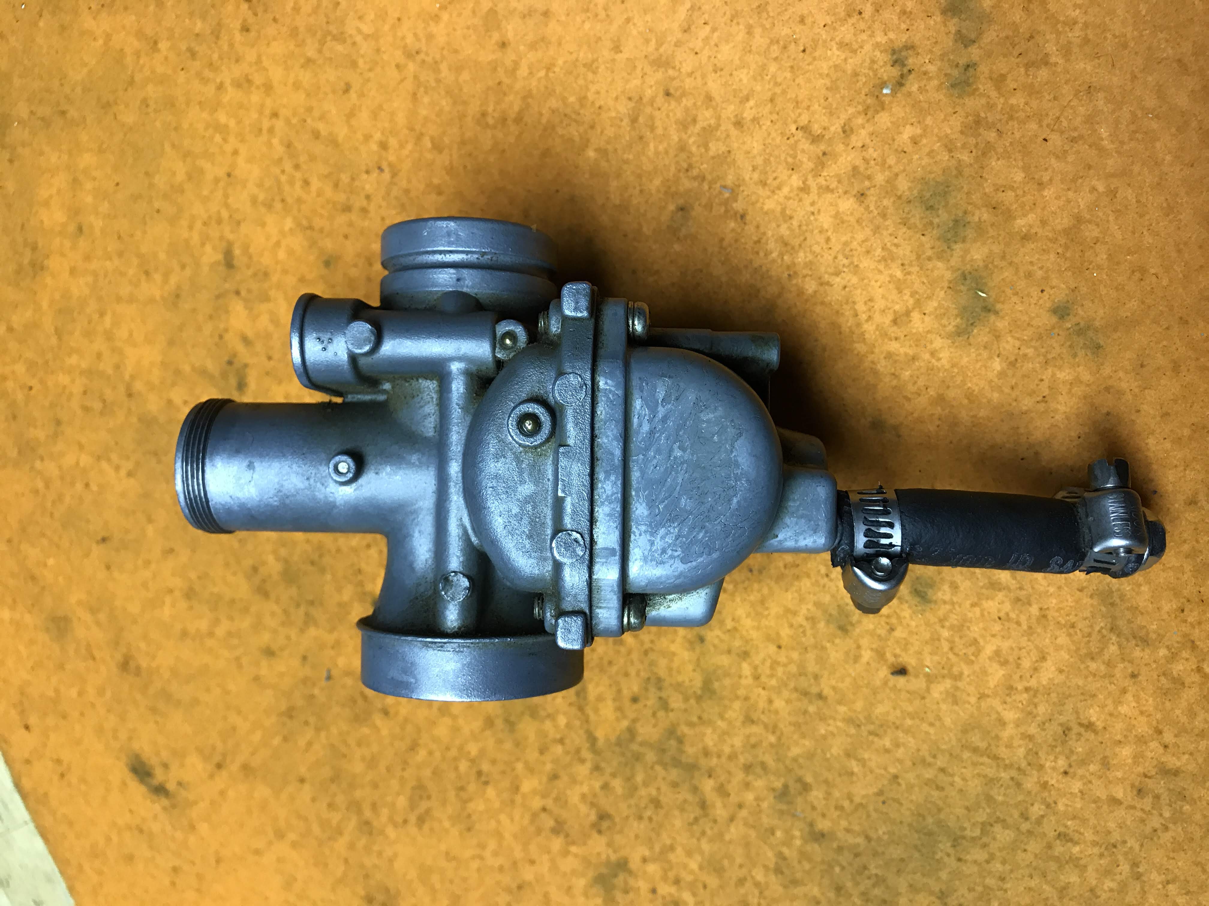

    Hi All, I just bought a YTM 200 and the carb leaks fuel like crazy from the bottom spigot. You can see in the pic this one has a hose that is plugged. I wondering what is causing this issueo is this a drain of some sort for the bowl for maintenance and should do the same as pictured?

    Yes, there is a drain bolt on the bottom of the float bowl. Without seeing the photo, I can’t determine what you’re talking about when you say the hose is plugged, but Yamaha did have a one-way valve option on the vent tube. Maybe that’s what you’re talking about? I guess the other option is that the bleed screw at the bottom of the float bowl is damaged and somebody decided to just plug the hose.

    I think he was talking about the bowl drain hose. In the pictures in the first post, that is plugged with what looks like a bolt.
    Gotcha. I didn’t look at those photos.that’s a lovely upgrade on that carb
