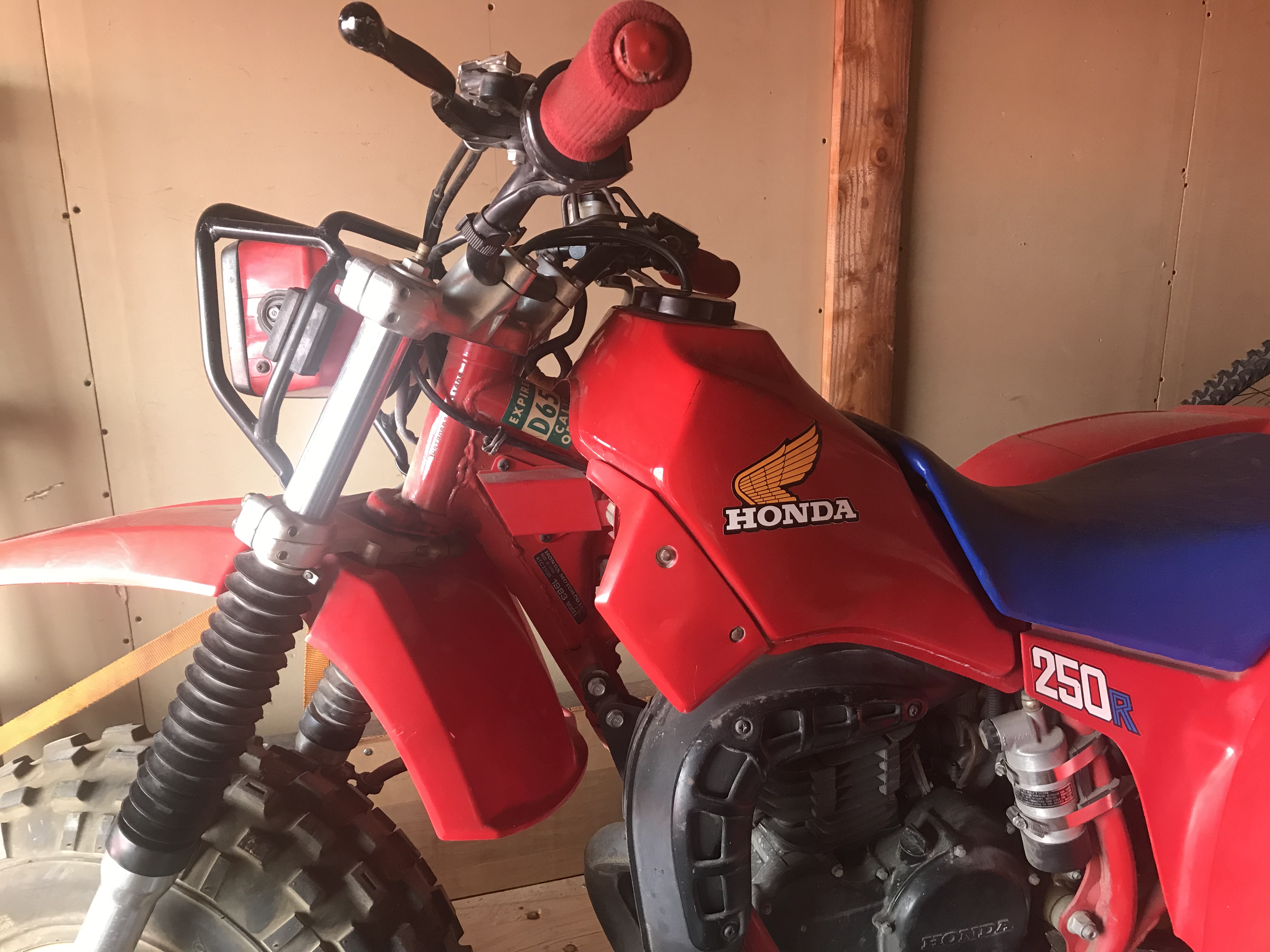

    New poster. We have 2 250r(s) coming from California.
    1981 - 300R - beater
    1983 - 250R - minty

    These bikes seem to be in decent shape. But haven't been ridden in years.

    The '83 is in excellent shape. The only issue so far is the rear brakes. Rear brake caliper was frozen. We are nearly finished with that rebuild. Also, rebuilding rear master cylinder.
    The '81 300r is a brute. Some previous owner installed a HUGE mikuni carb.
    And took some plasticized material and spread it all over the boot - i suspect to seal some cracks. Oh, and got rid of the air box. LOL.
    So, the 300r is a beater and needs some TLC. Will PM you. thanks.

    So to close this out. Success. After rebuilding the brakes on the 83 250r we took the trikes out.
    The '83 is so mint it still has the chalk marks on the tires. Well we broke it in with some Georgia red clay. Which BTW is impossible to completely clean. No matter.
    Impressions. The '81 300R is a brutal ride compared to the '83. Even though they have the same bottom end and the '81 300r should be faster, the '83 beats it in a straight line and, frankly everywhere else.
    The 1983 is such a great year - near perfection in our opinion. While 1981 is more akin to an 1970s CR. Raw and overpowered for the frame and suspension.
