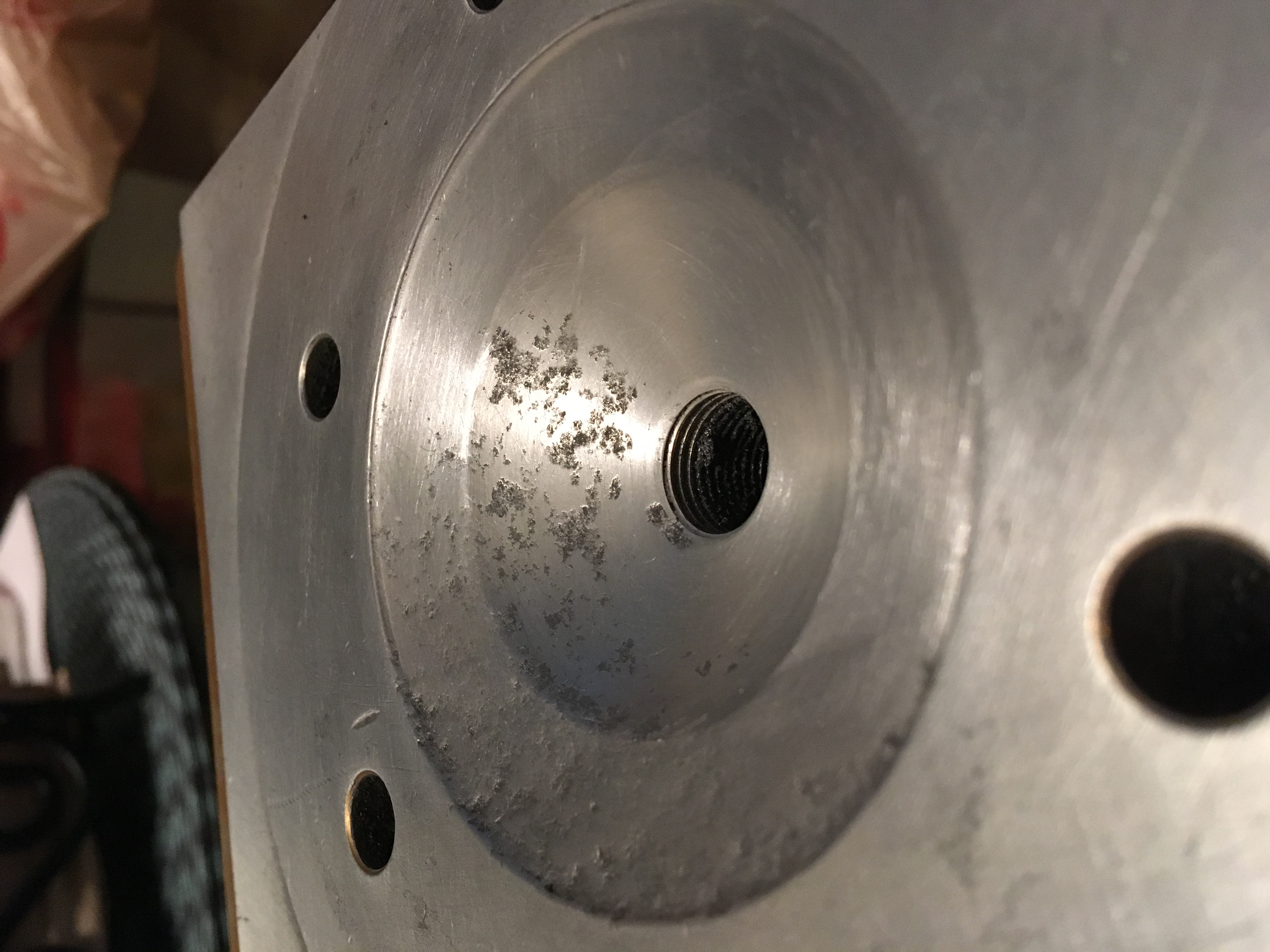

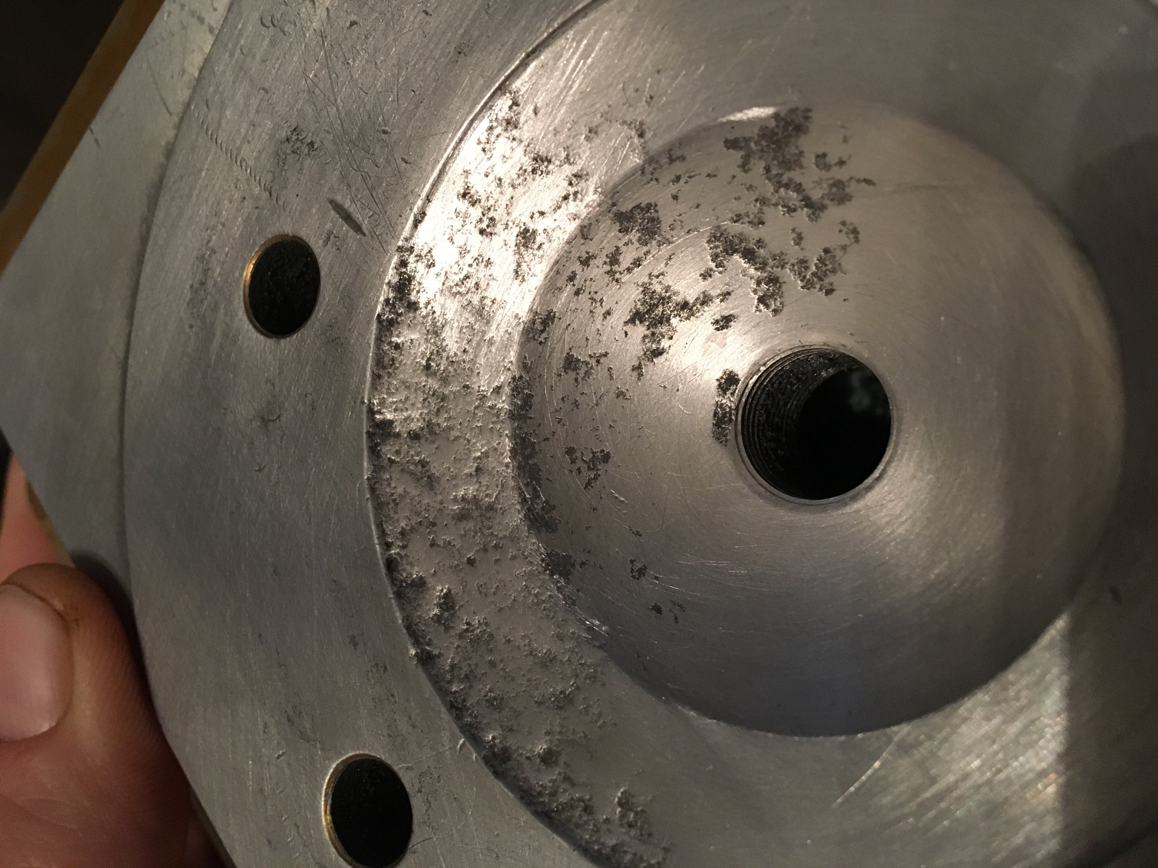

    I agree I’m overthinking it. I just want as much knowledge going into this cus I’m much newer to 2 strokes then 4. With car engines i try to stay as surgical as possible, since I feel it’s the difference of getting 250k vs over 300k miles out of it and you’ll really only know once you get up there. Here’s a pic of the DG head. It’s got some pitting already by the prior owner and I’ve been told it’s fine as is. I’m wondering if I should machine the pitted surface and deck it or just leave it. This is why I’m searching for all this info because I plan on doing the milling in my shop.

    Unfortunately I am the only person on the site that can't view photos in most formats because the moderators have blocked me from seeing them, lol, so I for one can't offer you any suggestions for the pitting unless you can post your photo in a format that does not require a link to be clicked on, but hopefully someone else here will see the photo and be able to offer some good suggestions, however, unless there is a bazillion fairly large craters in it, it will be fine providing the surface around the craters is smooth so there isn't any "shards/peaks" of metal sticking up around them, because these can sometimes get hot enough to ignite the fuel mixture before the ignition does which could lead to an "unfavorable" outcome.

    Yeah there’s no sharp points, it’s just a lightly textured surface on the exhaust side. I’ll probably just run some 800 grit on it to shine it up and clean out the carbon.
