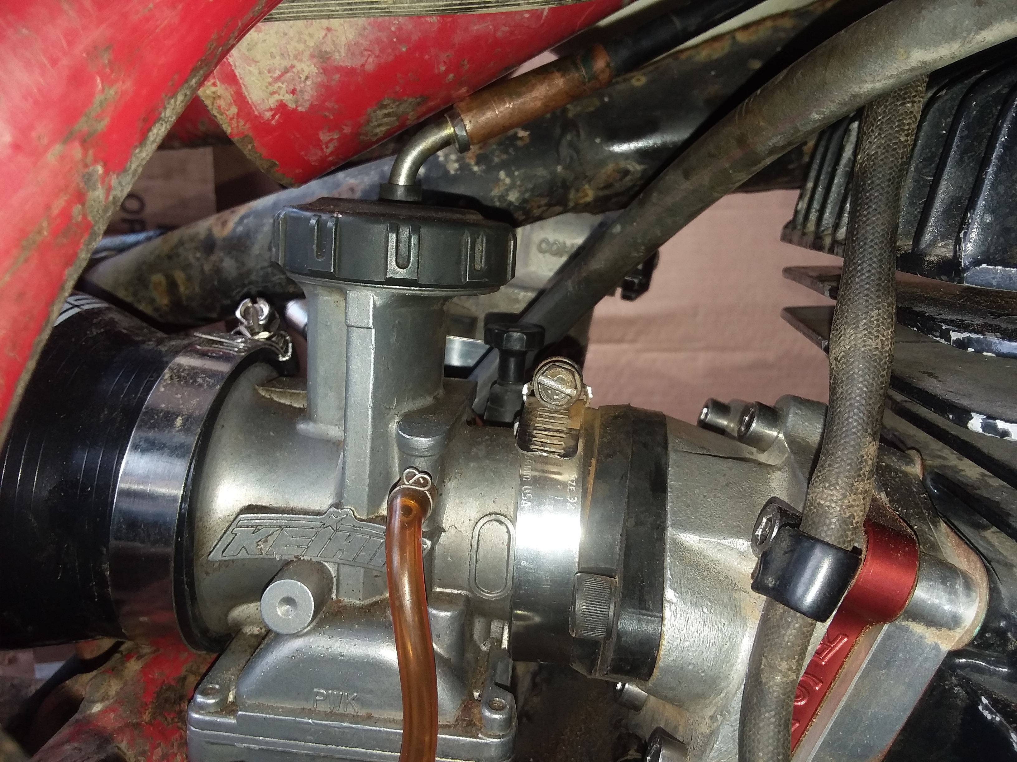

    Its hard to do but posible.I stuffed a 38 mill carb with esr reed block 13 mill reed spacer and a DG intake in my 300r. Im using my stock airbox with lid removed.Click image for larger version.
