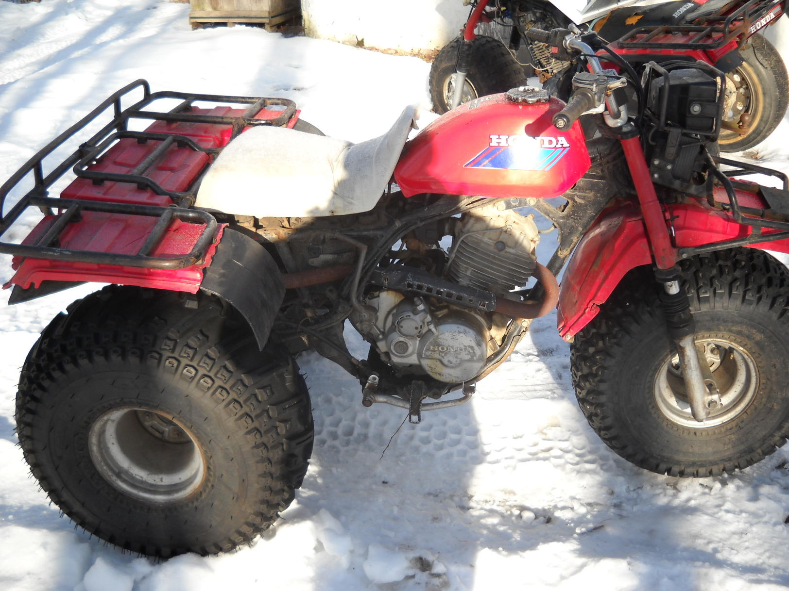

    Hi all, I am looking to ask a few questions about the atc i have purchased recently. Its in pretty good shape, i'm in the process of stripping it down a little bit to clear up some of the frame and give it a overall new coat of paint on the frame. I have two technical questions.
    Firstly, I would like to replace the inner chain guard as its fairly rusty. I noticed that it looks like i need to take part of the left case cover off that houses the Hi Lo gear shifter. Can any of you provide me with some tips or some things to be aware of when removing this?
    Also since this bike is chain driven, I am planning on replacing the front and rear sprocket plus the chain. The previous owner told me the rear sprocket was worn down a bit, so i'm going to replace it. Do most of you guys run Oring chains? or should i look at the standard style chain?
    I always wanted a atc, and am happy with the purchase. It came with a truck full of spare parts!

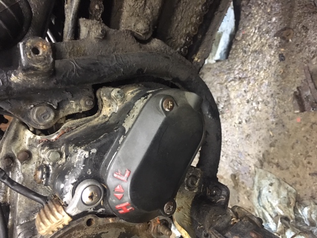

    I managed to pop the chain off today. Still unsure about digging into the hi lo gear box to get access to the front sprocket. Any advice? Found a good deal on a o ring chain.

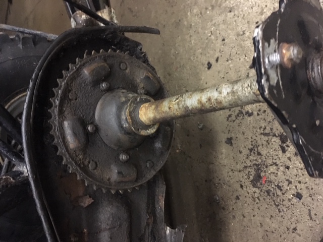

    I appreciate the response, I was looking at the manual. I read through most of it the other day as im trying to get a good grasp of this atc. Based off the 200e repair manual it says i need to remove the left case cover and subtransmission ( hi low) in order to access the drive gear(page 26). I'd like to inspect this gear as i know the rear sprocket is worn. As well i'd like to remove the chain guard, however i don't see in the manual about mentioning the chain guard other then where to acess points to inspect the chain. On page 114, it goes into some details about removing the Sub transmission, however im still pretty uncomfortable doing that as it looks a little bit intimidating with the shifter fork and gears and such. I may be overthinking it, but I always am interested to do some research so I can try to prevent breaking things as I need to maintain budget of being a student.

    If you're going to replace the rear sprocket, you might as well replace the front one too. Those and the chain all wear together. Of you mix new and used parts, the used one will make the new ones wear faster.
    Jul 2018
    TN
    1,065
    The 200E sub tranny is not bad. The ES is a bassturd lemme tell ya.
    If you do decide to do it, pull the tank and drain the oil. Then you can pitch the whole machine up on it's side. It will make things easier.

    I looked at the manual and it seems simple enough, I wouldn’t think it would all fall apart or anything when you take the cover off, but even if it did all you would have to do is put everything back in the same place it was, like it shows on page 114.
    There’s also a nice internal drawing on page 10 showing how everything is arranged

    Sounds like you got things covered pretty good, one thing to add about putting the machine on it's side, when you pull the cover off, the oil in there can suck thrust washers off and the shafts, so using gravity and working slowly a lot of times you can keep things more together. I've only taken apart the 200ES sub trans for parting out which is the shaft drive version of the same base engine. Never had a 200E or 200M yet.
    If your chain cover is in good shape, I'd say to clean up the chain path well while you're replacing everything, and be sure to reinstall it again after the new chain is in place. Yea it's a bit of a pain to lube the chain etc, but it keeps a ton of dust off the chain, so the chain should last so much longer, heck the one on your machine is likely the orig. My 99 350 warrior has been though something like 6 chains, but it's rode in dusty/sandy areas, and also muddy areas. I really love shaft drive because you just have to change oil once in a while and it's pretty much set and forget, kind of like a car/truck diff.

    Also do you guys have a good way to tell if a sprocket is completely worn? I got a spare set of sprockets that came in my spare parts pile, one of them looks very newish but i can't tell if its worth throwing on for a while or not.
