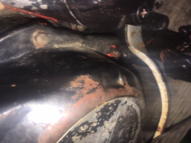

    Well guys, will have the front sprocket tomorrow. So anywho, i went at the bike. Drained the oil out of it. Im a lil stuck, before i go any further would like some input. So i took the Hi Lo gearbox off the bike, I can see that i still need to take the left side cover off. Do i need a holder or something weird to get the bolt of that holds the stator in place? I am assuming its normal thread. How do I get this side cover off to expose that front sprocket? I really don't like how these manuals fail to advise the procedure of changing the drive sprocket / front sprocket out. I can tell without holding the crank somehow I won't be able to unbolt it.
    Any advice.

    Pretty sure that cover just pops off, I recall there was a hidden bolt holding it though
    Here's an ebay listing to help spot any bolt holes you might have missed pulling a bolt from.
    https://www.ebay.com/itm/1983-Honda-...frcectupt=true
    Once you're sure you have the bolts out, there's normally a couple flats on the case to tap off with a soft like a raw hide , rubber mallet etc. A steel works too, but be mindful it can break the case if you hit too hard. Once it starts moving, it should slide off fairly easy. I'm guessing one of the lower bolts is hiding or covered in dirt/grease.

    Appreciate the link, will try at it again tomorrow. So the stator bolt doesn’t need to come off in order to remove the cover? Additionally the Manual mentioned removing the neutral switch which has a clip on it. Mine just has like a stud sticking out in the location of the “ neutral switch and no clip to remove.

    It's been a while since I took a 200 down that far. I think normally the gear indicator has an E clip on it, but it's a pretty tight press on so if someone was in it before, maybe they lost the E clip.
    Your engine looks a little different from what I'm used to, maybe the 200E is a slightly different design. This is what I'm used to seeing in the image below. Baiscally take a screw driver to stop the catch from spinning and pull that bolt out, it slides right off and remove all the case bolts to pull the cover off and the neutral indicator.
    https://i.gyazo.com/2d9b09bcfbc1a0b7...17a0c8cc1a.png
    Looking at the 200E manual, I see the cage is a different design. Can you reinstall the cage and still get to the nut under it? If not, maybe you happen to have some junk spare bolts around to throw in the little hub thing to use a screw driver/prybar to stop the engine from spinning. If all else fails, pull the spark plug and push in a bunch of rope to lock the engine up so you can get the nut loose. Common trick for chain saws atleast. Might want to make sure you're on the compression stroke so the valves will be shut.

    Well I got the cover off, and the one under came out easily. Took your advice and took two bolts and screwed them into the holes where the pull start cup bolts in. I then put a wrench on the bolts and let it bring up against the foot peg. And it worked out perfectly. I can see the front sprocket finally. It’s actually in better shape then I thought but I’ll be putting on the new one regardless at this point. Appreciate all the help highly. I’ll touch back when I have more trouble. Also since I couldn’t find much more information about the front sprocket changeout , I’ll do a write up with the pics and videos I took. After going through this process now it seems easy!
