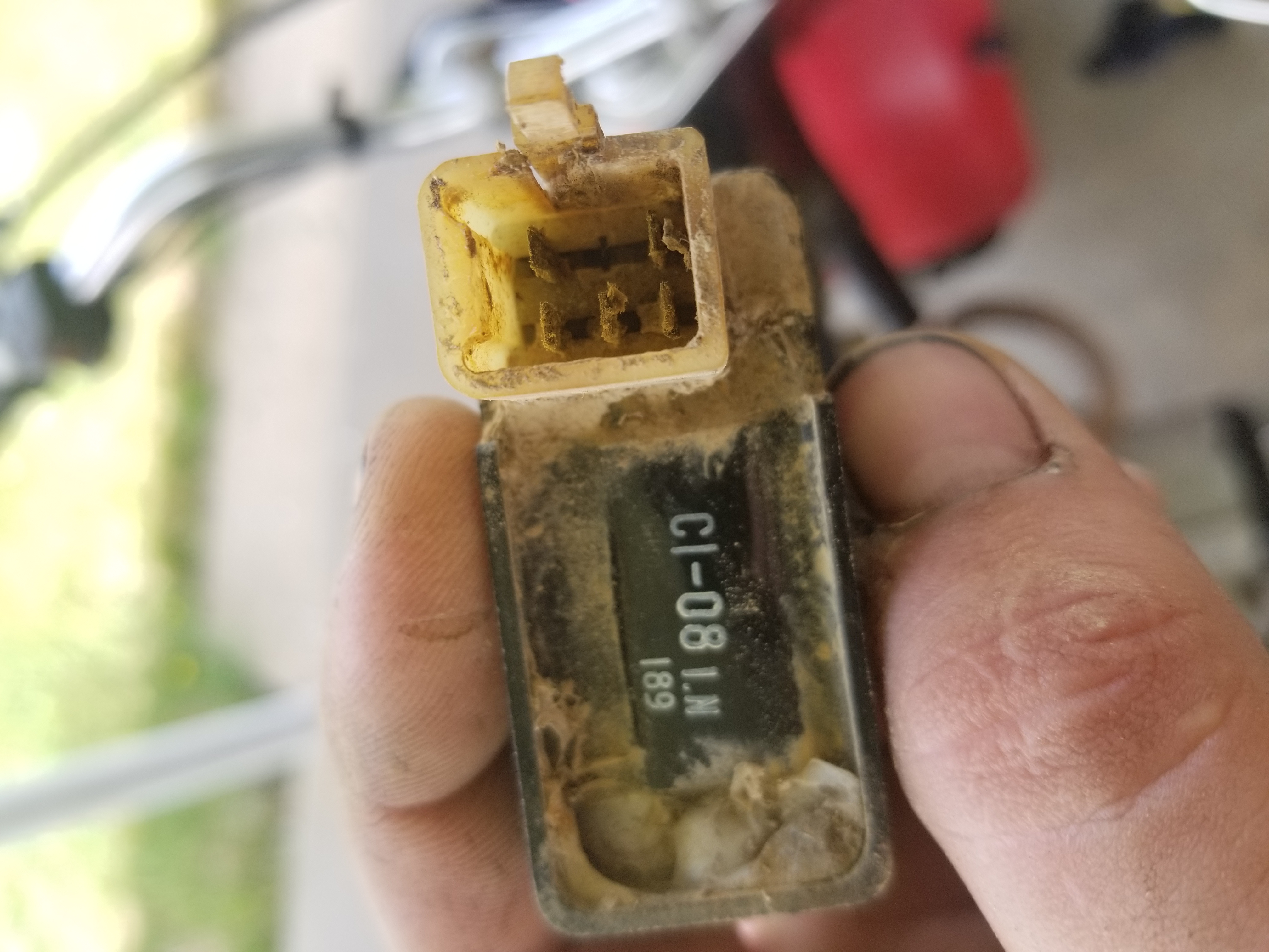

    The only bad ground I can think of that would cause this is the green wire between the CDI and Ignition Coil, and the Ignition Coil to frame interface.
    The marking on the CDI is what OEM has, so it probably is OEM.
    The CDI typically fails in a couple different ways, complete dead with it does nothing, and intermittent which can be broken solder joints inside the housing for the connector. The capacitor inside is 30+ years old and most good brands of capacitors start to fail around 20 years (age kills them, not so much the use). It's not uncommon for the CDI to be at fault. If you can't find anything else bad, then normally the CDI is blamed. You could try to do the multi meter test in the service manual on it, last couple people that tested them had them test bad that way and replacements fixed their issue.
    There's a Chinese CDI with a teal connector that seems to do fine, only problem with Chinese stuff, you never know when they change the design and there's no model markings at all. The other option is to buy a CDI from Mike, his uses a different connector (more modern style), so you'll need an adapter off him too. Full disclosure, I make the adapters for him. The CDI you'd need is labeled as for a 200x which uses the same mechanical spark advancement system as most 200cc series engines from this era. The CDI might have some extra ignition timing added in to be more aggressive since it's tuning is from a stock 200X CDI. I'd think your machine should respond well to it though since you've done some mods to the engine. Anyway, I linked his site below, talk to him about it. Prices are pretty reasonable from what I've seen.
    http://mikesatvfix.com/
    If you have another 83 and older 200 series machine around, likely the CDI is the same pin out and has the same ignition spark curve in the CDI, let me know if you do have another and I can try to check into it. Swapping with a known good unit is one of the best ways to test for CDI issues.

    I cant tell be the picture on there website, but is the adapter wire a square plug? Like the picture attachedClick image for larger version.

    CDI looks like it was stuck at the bottom of a mud hole lol. Might want to just try to clean it out and see how corroded the pins are.
    If Mike doesn't have the right adapter on hand, I can make one for the same price he'd charge. I can't recall if I made any for him for this old of a machine or not, 84-85 used a round connector, and 83 200x used a different type of square connector (two in fact). Basically all Hondas 86+ used the same connectors as Mike's CDI, and most 83 and older used the same as yours.
