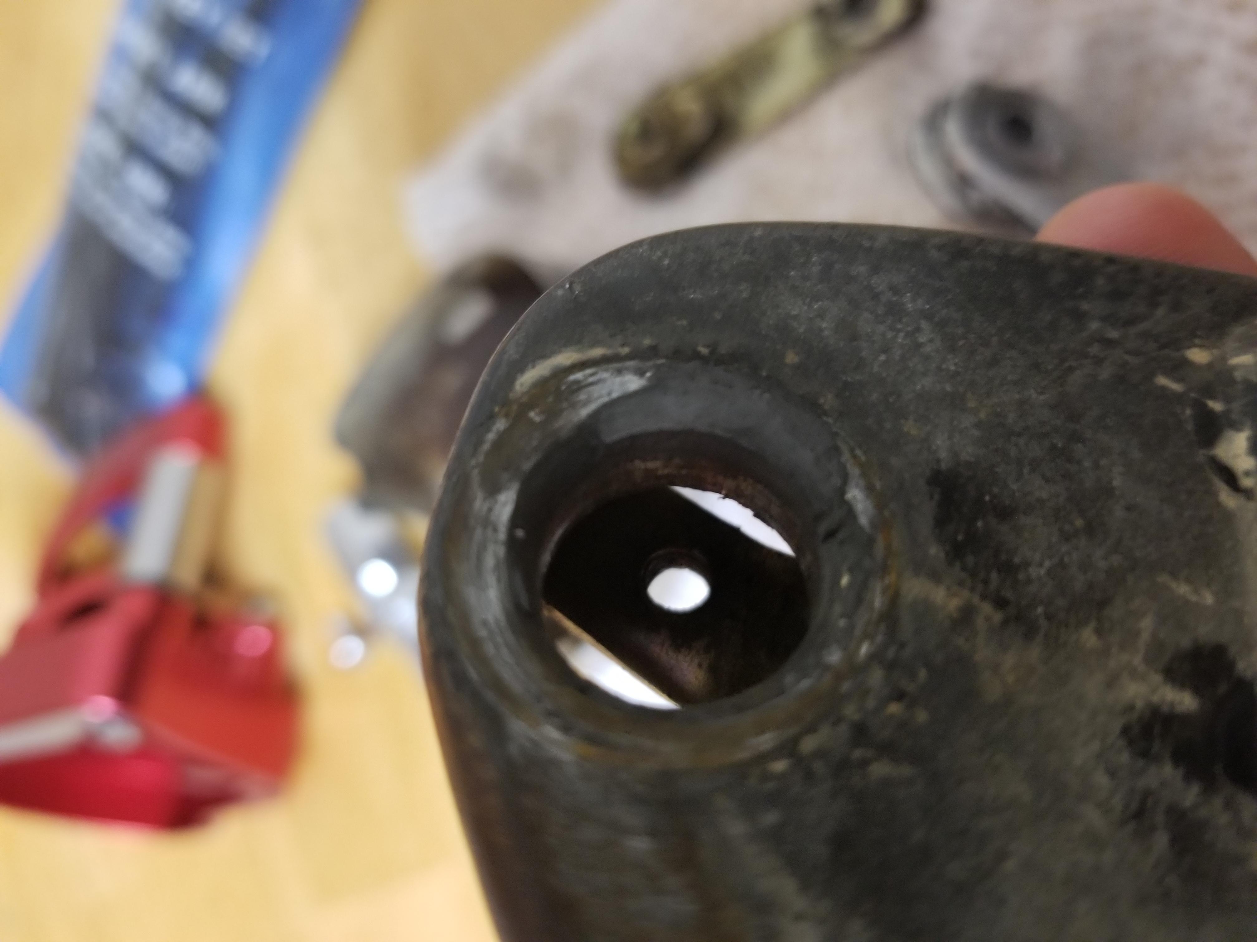

    So my new cable finally arrived thanks again shortline10 �� and It wont fit the new thumb throttle ��♂️ just my luck. Of course the adjuster on the new throttle cable doesn't come off and the cables is a different thread pitch, anyways back to factory it goes. I decided to try a mock up and seems to work good so I decided to try and give new life to an old throttle. I decided to pull it apart clean it up and make sure it's good to go.
    Well I've found the thumb as it goes into the housing had some slopes I pulled it apart. The thumb section has some pretty decent wear from 34 years of faithful service��. And so I found that there seems to be a plastic bushing for it. My question does anyone know of a replacement for this bushing? Or is it find some plastic pipe and make it work type of deal? Pictures to come.
ID:	259606Click image for larger version.
ID:	259607Click image for larger version.
ID:	259608Click image for larger version.
    Hopefully these work

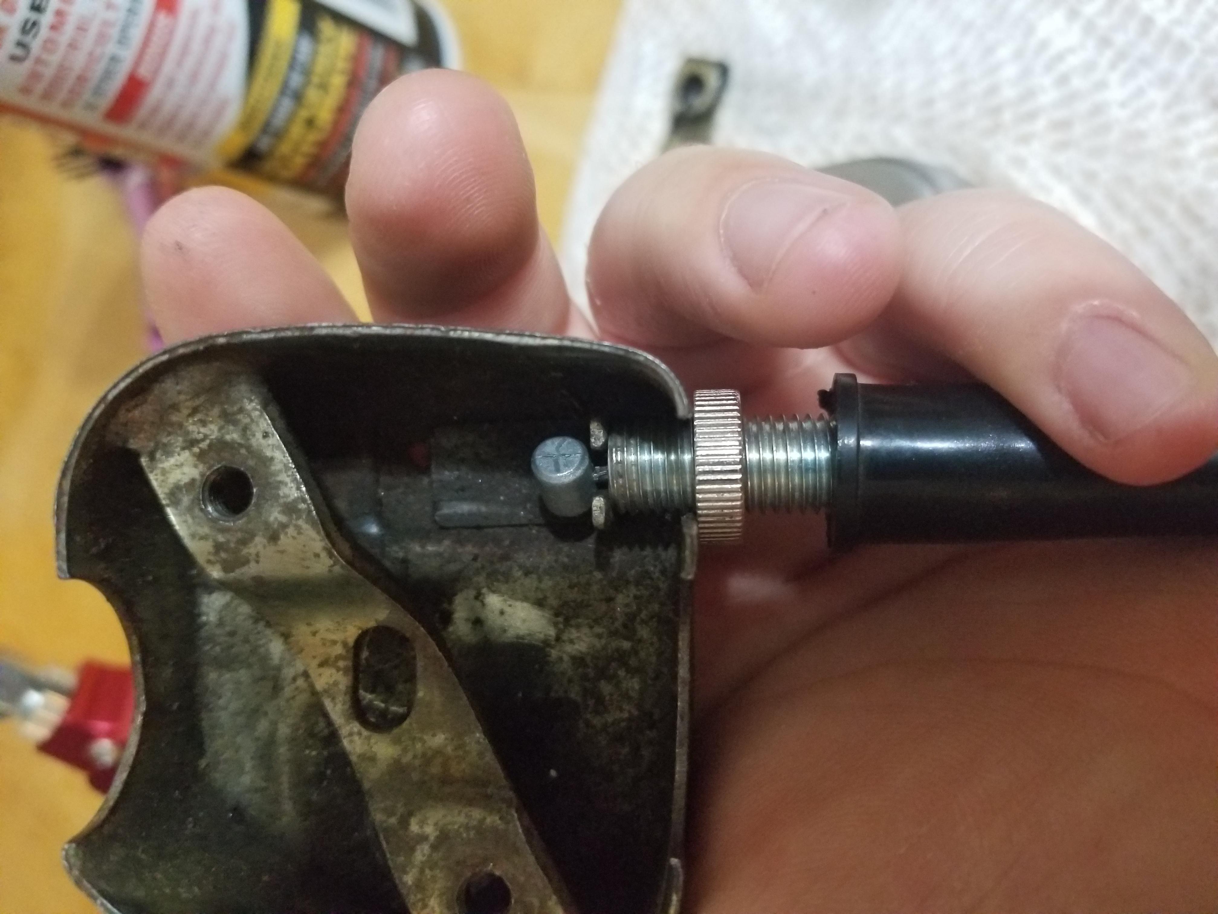

    One last thing when this new cable is put in does the threaded section seat all the way against the tab as I have it here? Never really messed with cable adjustments before so figured I would ask.Click image for larger version.

    That’s not the factory 200x throttle assembly , what you have looks like it’s off a utility ATC .

    Well to be honest I had no idea jokes on me I guess then. I've tried looking online but there most of the pictures I could find had bad resolution quality so I just assumed it was the factory.

    This is what the correct assembly looks like .
    https://www.ebay.com/itm/Honda-ATC-t...cAAOSwUpJdS0w~

    The picture shortline showed you is the OEM setup.
    I'm confused too because the new cable adjuster appears to be threaded inside as if you are supposed to put the two adjusters together. Have you tried them screwed together to see if the cable length is correct?
