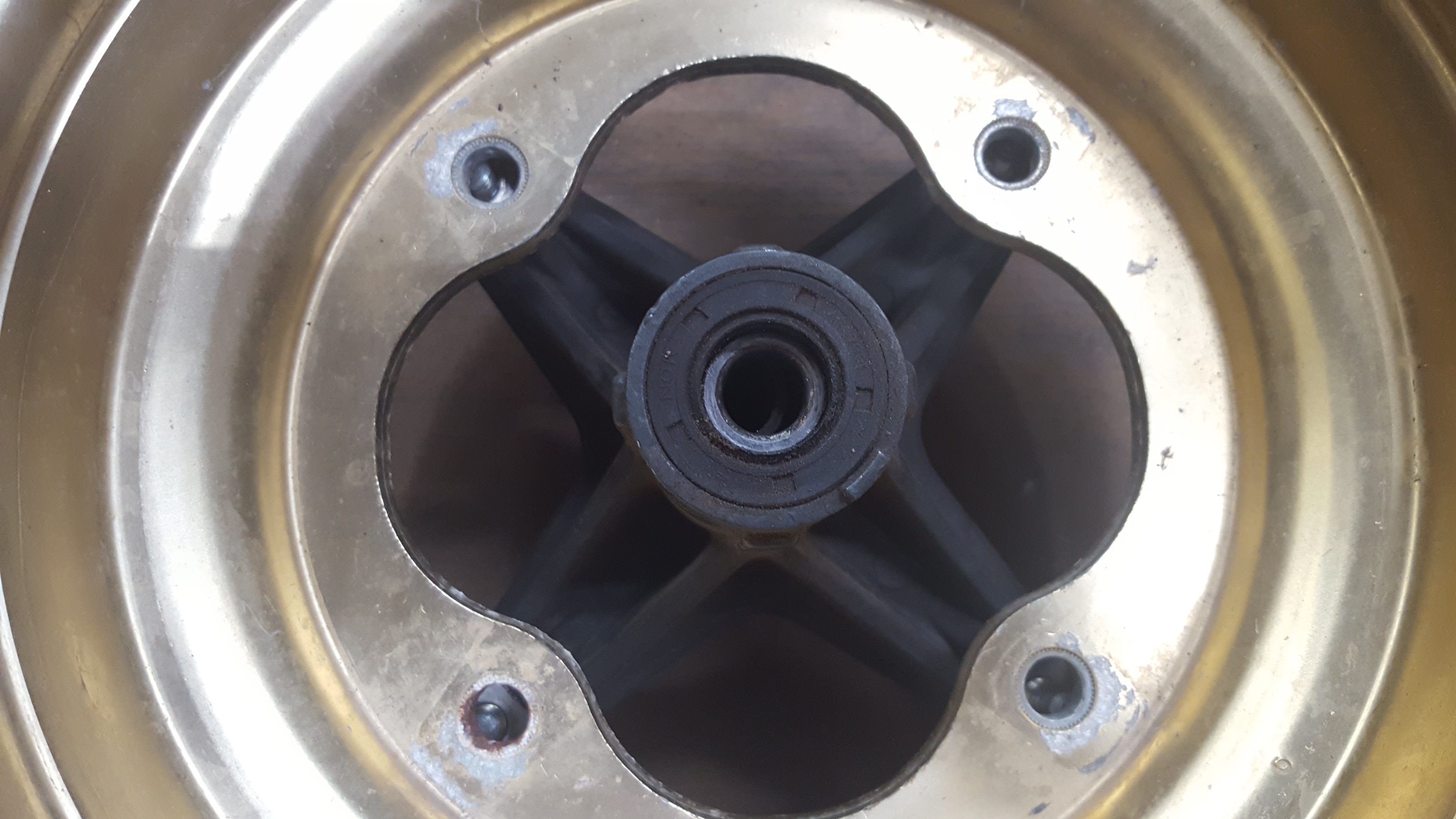

    Oh crap, is the front hub different 200x vs 250r?
    I have an 11inch gold enkei rim but the pattern is bigger than my 200x hub. Crap! That's what I het for not checking.
    Options? Different hub or different wheel?
    to add another problem my 2 inch spacer wont fit the OE 8 inch wheels.
    Mrc.

    The front rim you have is 3rd gen 250r. The bolt pattern is smaller than 83-85 200x. It will be cheaper to buy a set of rear hubs like listed above than buying new studs.

    You can get an 86-87 200x,85-86 350x or 85-86 250r front hub for your rim.Or get 83-85 200x or 83-84 250r front rim for your hub.

    I opted to buy a new front rim 83/84 gold 250r and a pair of 300ex hubs and 8 flat lug nuts with coned shape washers.
    Thanks for all the help.

    ATC300r, I wanted to come back to this thread and thank you for your incite and help, I got a new front rim that matched my currant 200x hub and a pair of new 400ex rear hubs along with some cone washers and lug nuts, it all fit together perfect tonight, I am just waiting on my rear tires. Thank you again.
    MrC.
