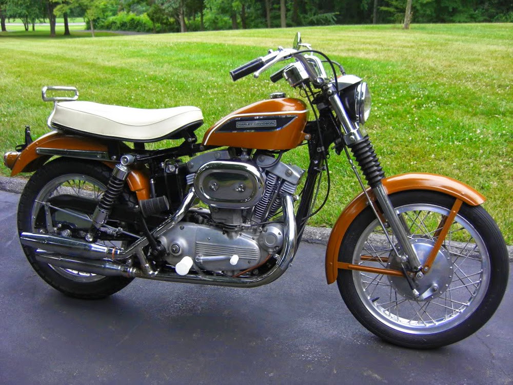

    The original peg location may work, but a lot is going to depend on the seat. Keep in mind,the original Sportsters were meant to be competitive with the British bikes of the time and those bikes were THE desert racers of the day. They had thicker, and longer seats, that sat higher and farther forward than the new bikes. The Sportster was HDs performance bike, getting overhead valves before any of the bigger bikes and a unitized transmission. Harley continued that into the late 1990's by introducing new technology on the Sportster first.
    http://www.classic-motorcycle-build....r-history.html
    Here are some other internet images that have seats more accustomed to your application. Two of these are the later rubber mounted engine Sportsters, which also have larger fuel tanks. I got a chuckle when HD promoted the new rubber mount engine frame as stronger. Well, duh, it had to be because the engine was no longer a stressed member. It also added a good (bad) amount of weight. Engines bouncing around inside the frame, at idle, don't look quite right.
    https://thekneeslider.com/gb1200r-br...tom-sportster/
    The braking balance is looking kind of comical though. A stereotype of Harley riders is they are terrified to use the front brake, hence the enormous rear rotor, which is even more accentuated now. I done a quick search and didn't find a XL600R oversized brake rotor kit, which are typically available from supermotard parts companies. The kits are a larger brake rotor and new caliper bracket. I think a XR650L brake caliper fits the XL600R forks, and if that's the case, you can use a caliper bracket for the XR650L. You'll just have to source or have a custom rotor made.
