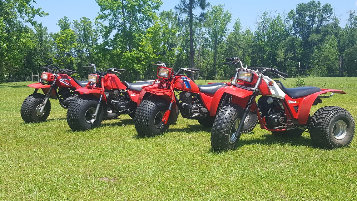

    I hear people say just a rider, I personally feel all but a few should be riders, enjoy it, you earned it, you took the chance, you fixed it.
    My definition of a rider is a nice complete bike, NOT missing fenders, headlights and seats, that's a piece of crap.
    All I can afford to build are riders, but there nice, I am proud of them, and people always comment when they see them.
    My riders below.
    MrC.

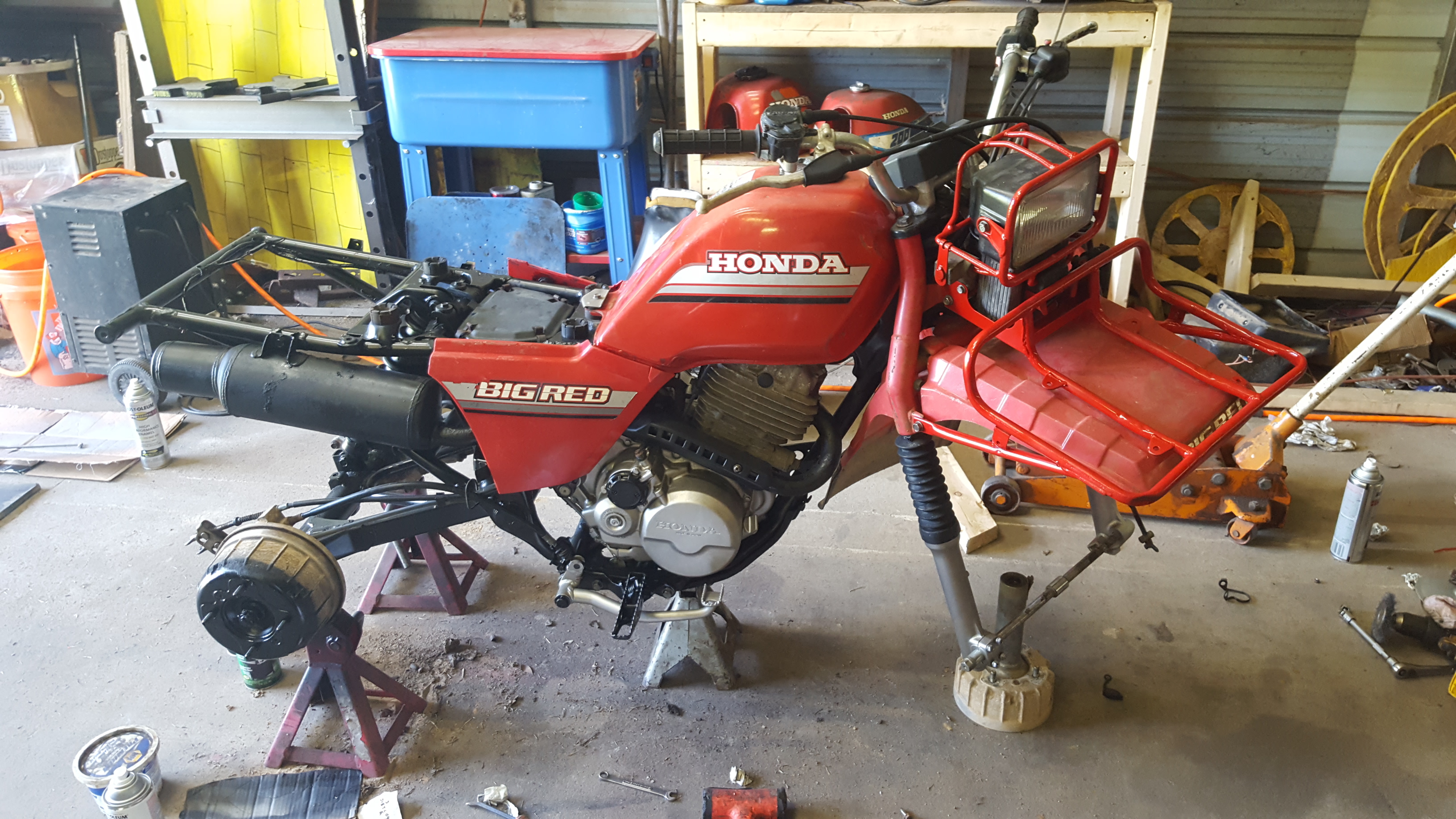

    Should I save it.
    Got more parts in. Changed oil and filter. Oil that was in it looked fairly good. Installed headlight cage rack and a led after making some brackets. Also put on rear rack that came in today. It’s been a lot of fun so far. In need of a seat and fenders. In my search for parts came across a gas tank,front and rear rack for a 200 big red. Got them cheap, so I bought them.
