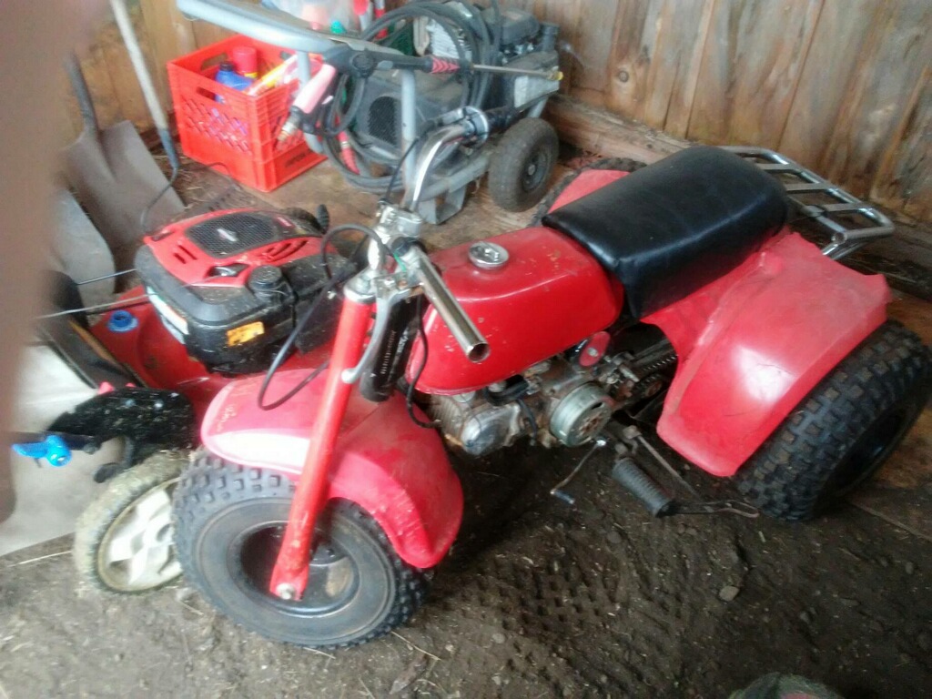

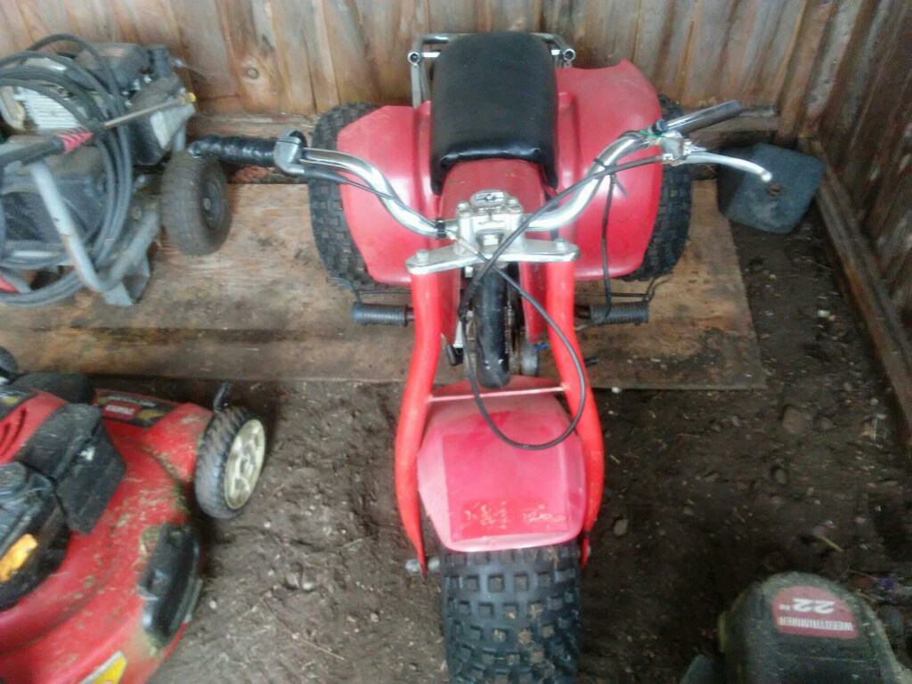

    Shoot. Major posting fail!!
    The rig is up at my buddy's place. He is shooting some pics and I will get them uploaded ASAP.
    It is in pretty rough shape with no decals and cruddy plastics. But the peg guards are there and there is a rear chrome rack that may or may not be stock.
    Stand by!!
    May 2020
    Portland, Oregon
    13
    Ok.
    Pics!!!

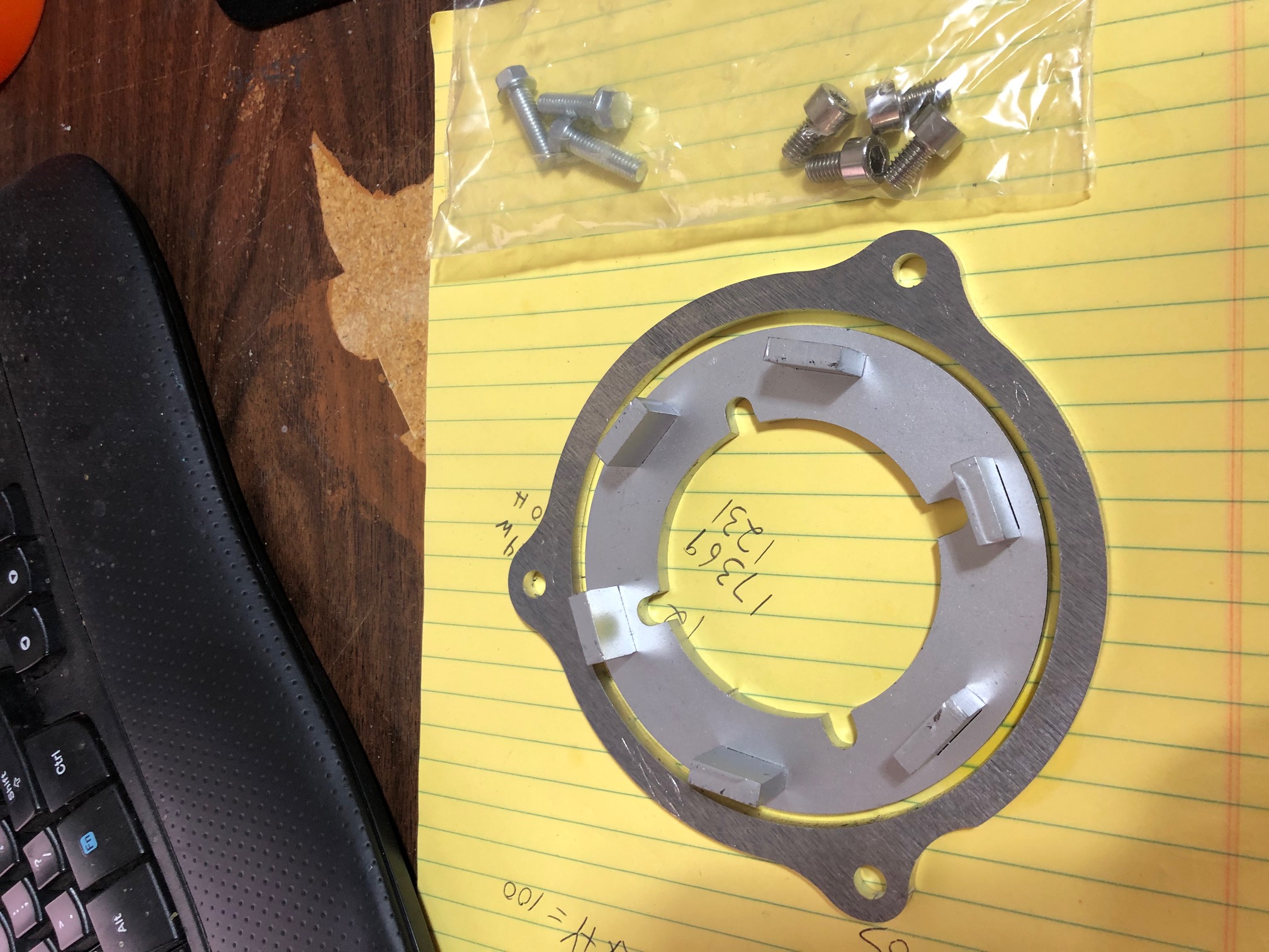

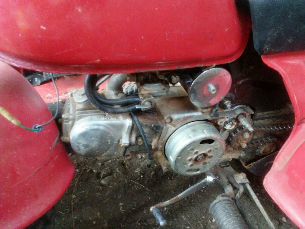

    Here are the parts we have acquired
    Flywheel Case

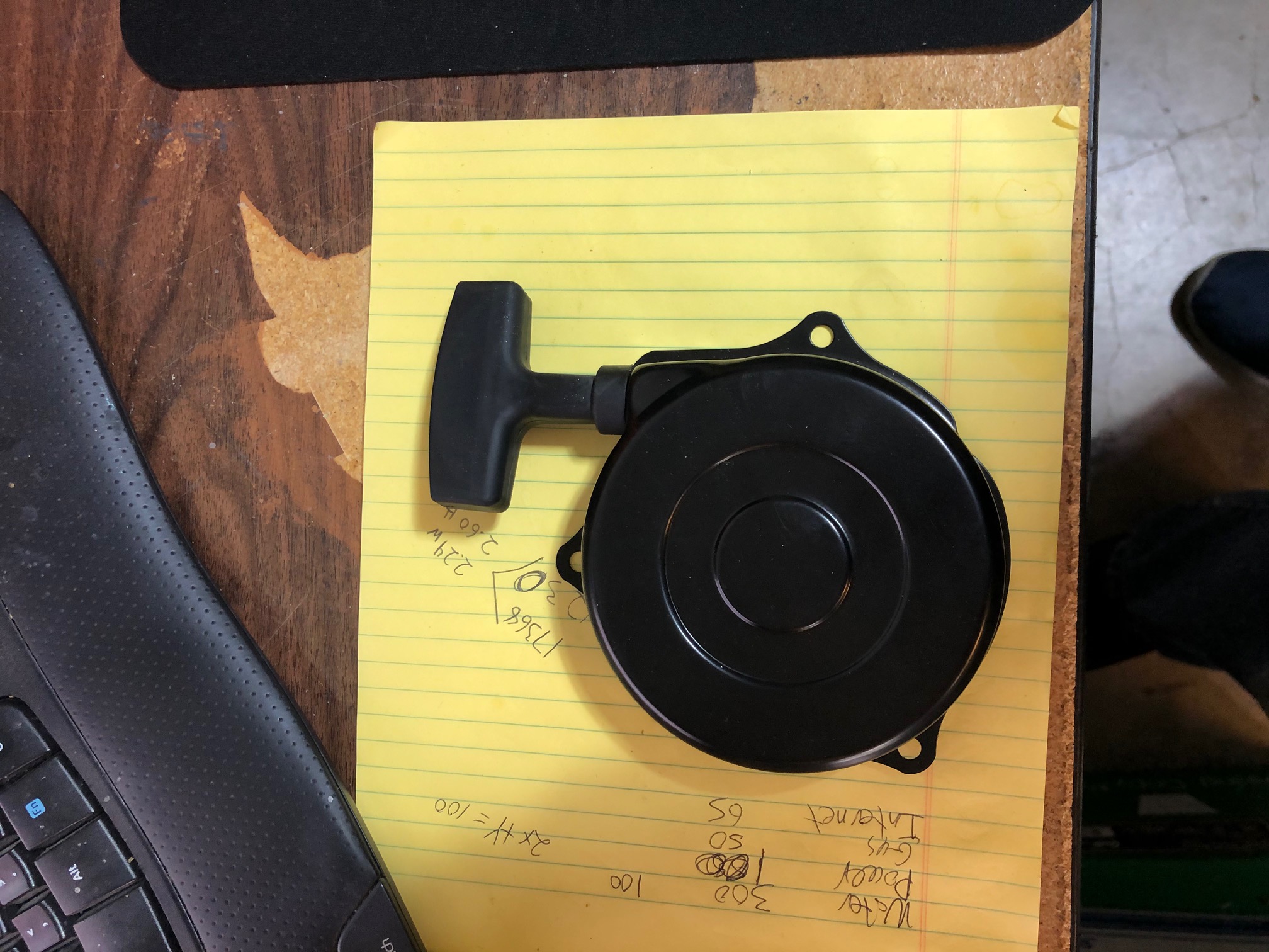

    Pull Starter for a TRX90 - NOT compatible with an ATC70
    Adapter plate we thought would get that TRX90 Pull Starter to work - NOT x2
    So I will be calling a few shops around the country tomorrow in the hopes of finding somebody who might have pity on a fella and offer some guidance. The result will be the purchase of SOMETHING that will hopefully let me use one or the other of those two "NOT" parts in some fashion.

    Your left side cover looks like it’s for a trx70

    Couple of things PDX, that machine is in about how most are found these days, and it's well worth putting some coin in it. It's not hard to sell these for 1K in good running order.
    1. On the "Home" page here there is a VIN decoding link that should tell you what year your machine is. The VIN is on the steering head.
    2. I'm not too sure how much faith you want to put in a knockoff carb? I've heard more bad than good; and you'll have to clean it when you get it too. Make sure the stock air filter is in there too, that seems to make a difference in how it runs.
    3. Have you cleaned and checked the points? That will affect performance too.
    4. Check your valve adjustment and get a real number for compression. That motor should pull easily on flat ground in 4th even if you're a bigger person.
    5. Your frame is slightly bent, that's why you see burn marks in the front fender. Super easy to fix too. Here's a link to a thread to fix it. http://www.3wheelerworld.com/showthr...ghlight=atc+70

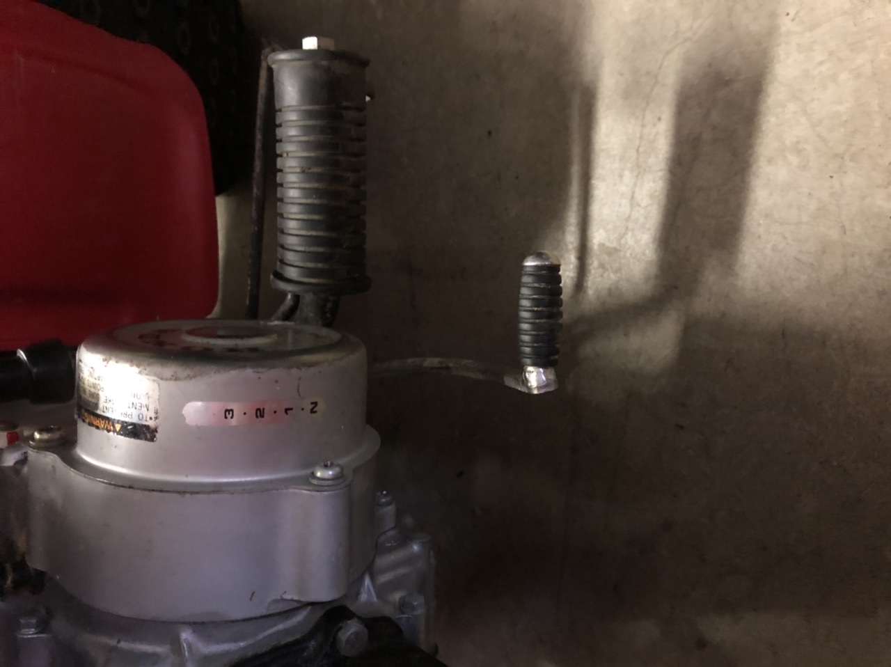

    My ‘85 has the recoil with a n-1-2-3 up sticker-clearly not the ‘correct’ one. Not that it matters-The description on the one be shipped came off an 85’-So, I’ll keep that and have a spare. If you end up needing the case and pulley, hit me up.
    Edit: ends up I’ve got the correct recoil. The 4 is washed away. Click image for larger version.
