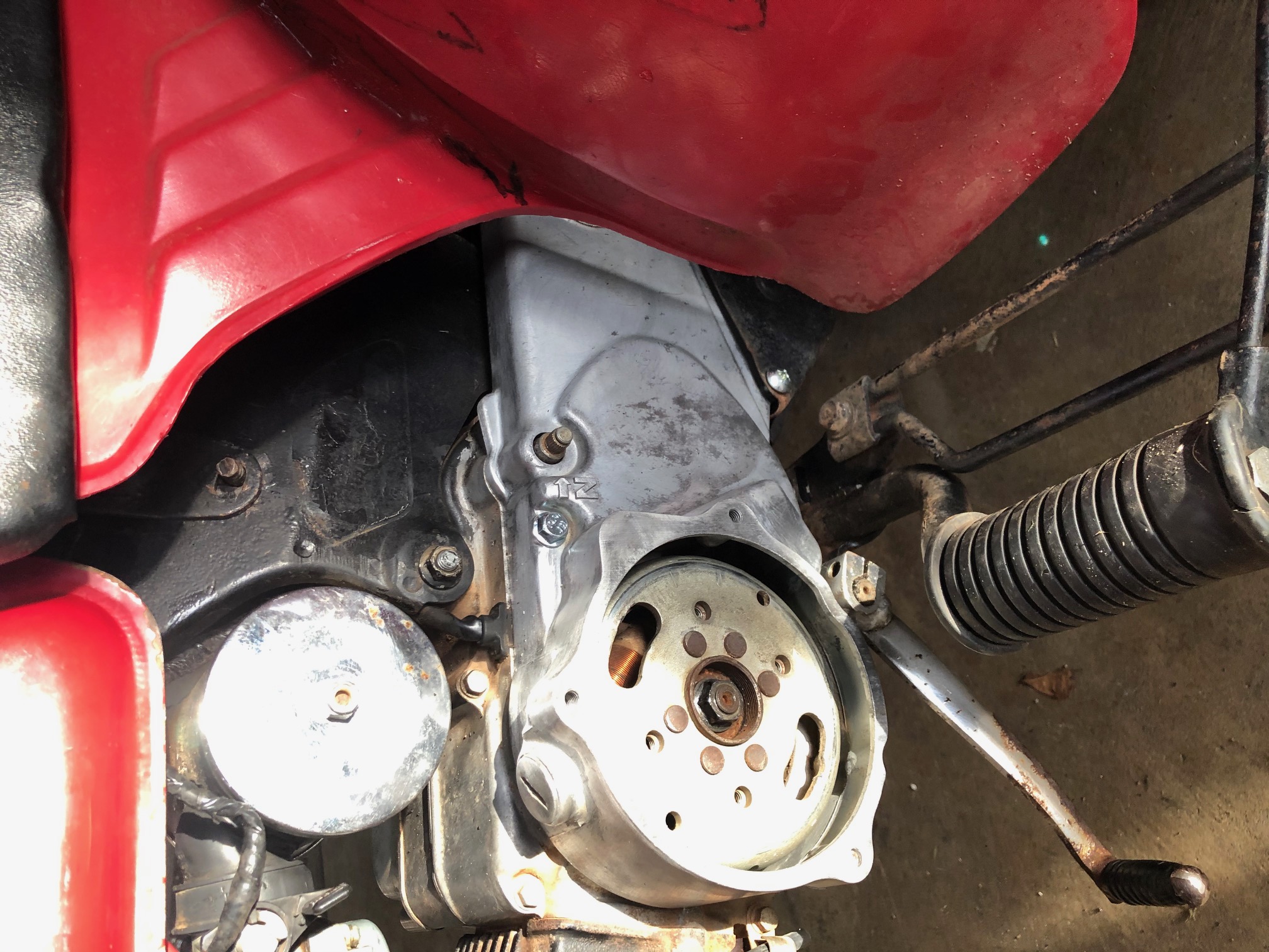

    Your left side cover looks like it’s for a trx70
    Definitely not Atc 70. Looks like an extra hole at the top

    Sorry guys, it took a couple of days to get the VIN for various reasons...
    JH3TB030XEKk912992
    So from the VIN decoder it is an '84 ATC 70. It definitely has a 4spd down shifted transmission.
    We are going to go through the points and valve lash and a few other things this weekend. Hopefully this case cover I have will work, but if not, I just might bite the bullet and jump on JD110's offer. The case was listed as for a "78-85 Honda ATC 70..." so thats eBay for ya... fingers are still crossed.

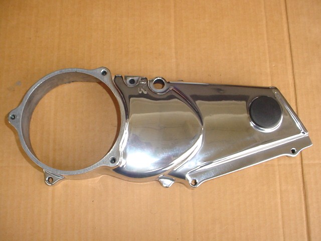

    JD110, that cover looks just like the one I have... even though a couple of posters have indicated the one I have is NOT for an ATC 70... So, that pic of your box of goodies gives me some hope that I have a functional cover but until I can attempt a mount(this weekend) I am still unsure. Thanks for understanding the noob factor on my end and I will keep looking/reading/learning.

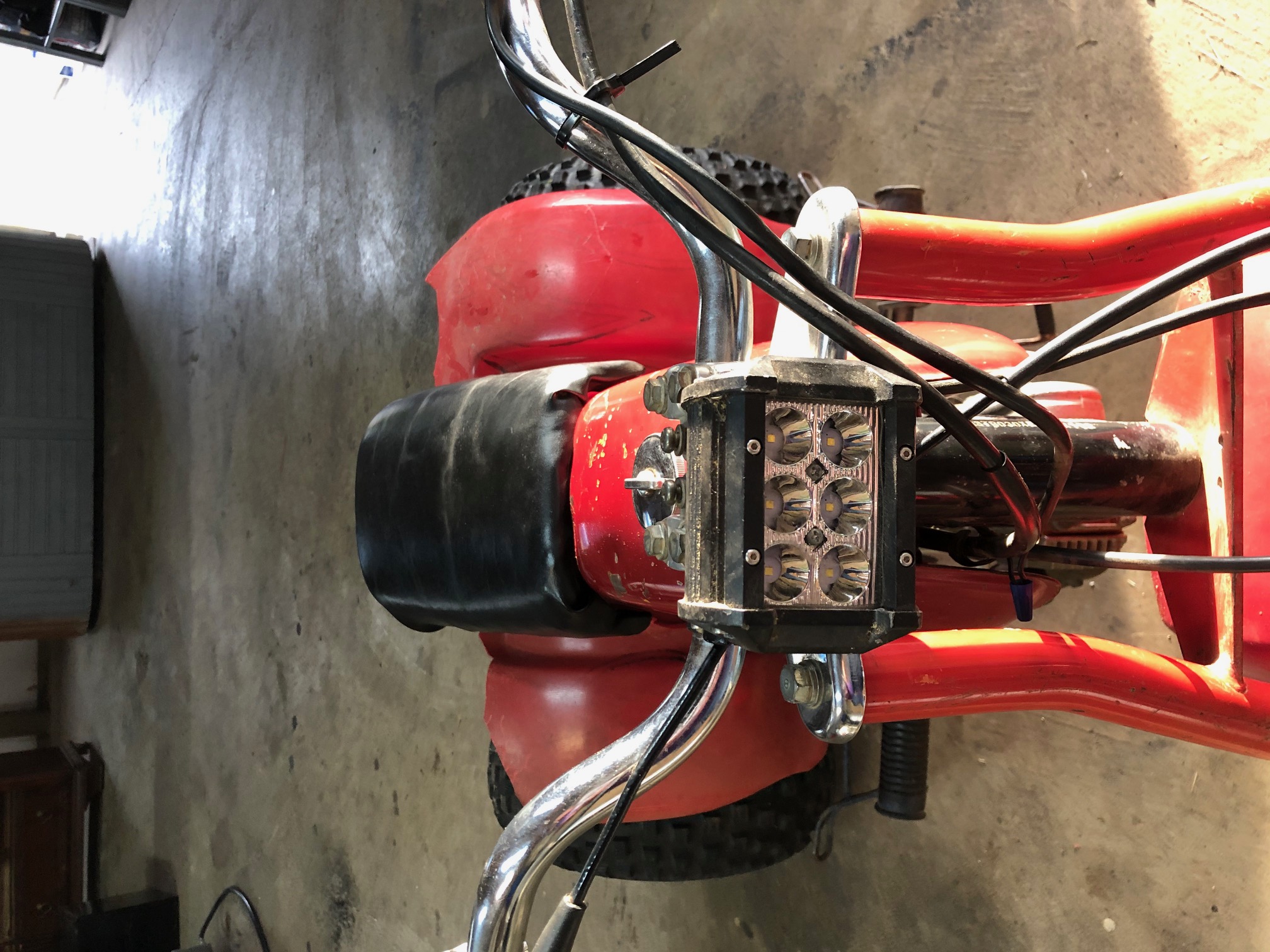

    So, if that white plug is a 6v connection, I should be able to hook up a 6v light of somekind as long as it isn't a huge power suck right? No 500w Halogens or anything like that. Maybe a nice little 6v LED rig of some kind. I can probably make one from some bits and pieces I have around my electronics bench...

    Look closer at JD’s cover , it’s definitely different and it was designed for a CDI motor .
    Your cover is off a trx70 like I’ve already posted . Totally different recoil set up .
    Yes 6v and around 20-25 watts for the bulb

    WOW!! I was not even looking at the recoil mount orientation or the various "bumps" on the one I have compared to whats "in the box" at JD110's. Now I am egg on face again.

    As these little 70's are latest craze with our Glamis group, here's a couple pic's of my '84 left side cover just returned from polisher. Looks just like JD's. The white plug could have three wires, for the bike to run they do not need connected to anything. Lt Green with Red Strip is neutral switch, Dark Green is ground and Black isn't connected to anything. Sad news is Honda didn't wire the '83 - '85s for lights, there should be a yellow wire in that plug. The light coil winding is there on the stator plate you need to solder a wire to it to be able to have 6volt light.

    That left side case fits just fine actually. It has those noticeable "bumps" on it that allow for clearance on TRX's I assume, but they don't get in the way of anything at all. That case cover went on fine. And we have a solution for the pull start on the cheap!! Even figured out how to adjust the chain a little tighter(but its pretty worn so a new chain is in order).

    The other item is a 6led headlight setup running off that molex connector. Not going to blind any body but... it should work.
