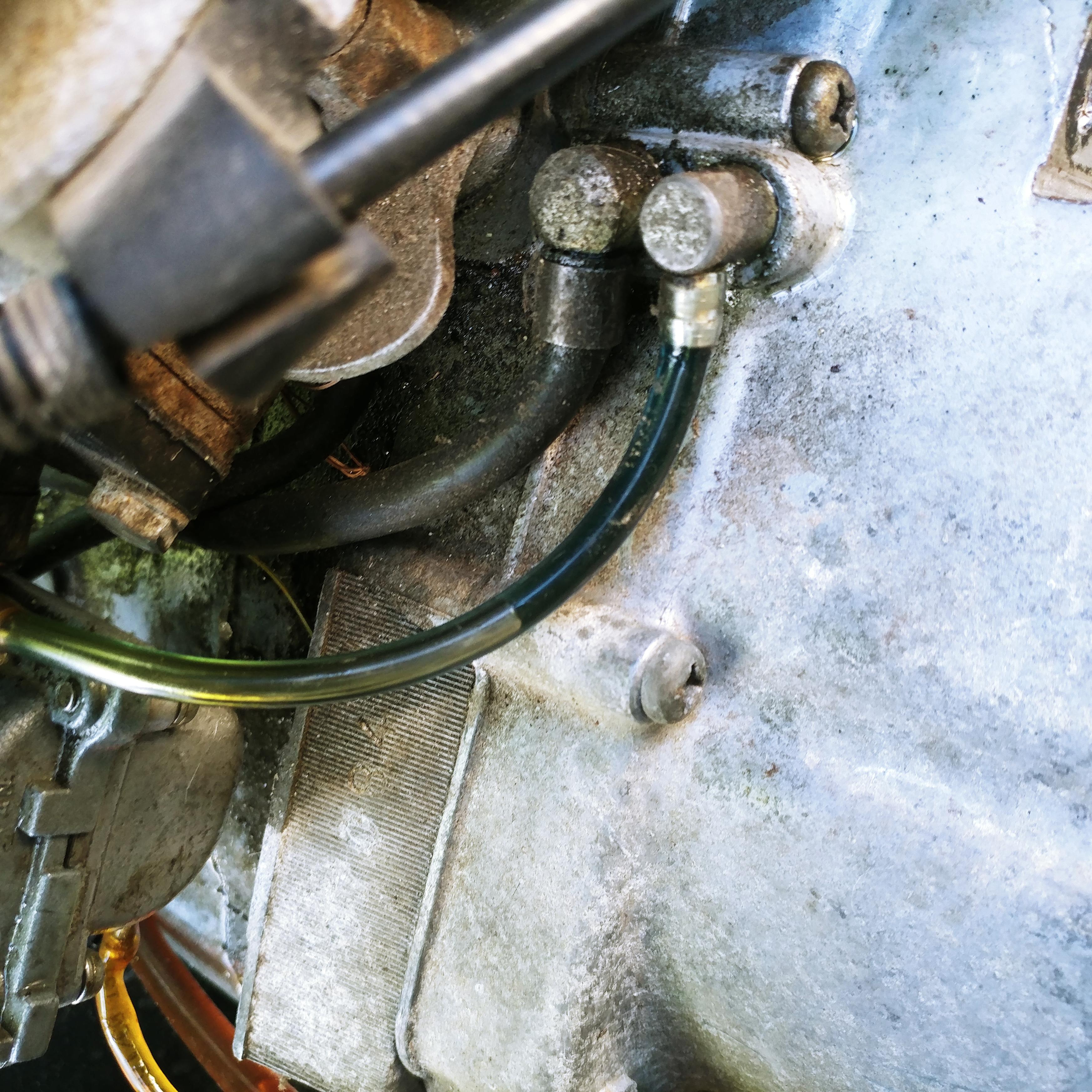

    The injection pump looks good and it turs great with the throttle but as you can see the oil only get's half way to the carb then stops.

    What about the oil tank vent? Has to let air in to let oil out.

    I will check out that vent thanks for the heads up.

    the reason why the oil isn't getting to carby is that the oil lines & pump hasn't been primed & bled, easy to do- there are online manuals explaining this procedure. Sounds like your crank seals need replacing, the motor doesn't need to come out, you need to take clutch side off, (gasket replacement needed) & remove starter assembly on other side to expose both crank seals. I'm about to do mine as well.
