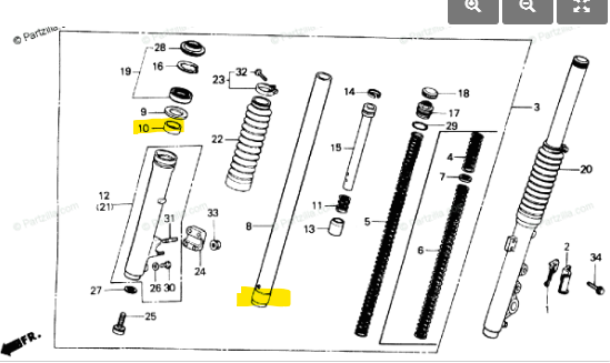

    Above is the diagram for 1983 250r forks per honda. They only show there being one bushing at the top. Even though there is a bottom bushing on the ones I have.
Name:	1985 250r fork diagram.png
    The 1985 diagram shows the bottom bushing but doesn't have a part number designator. This diagram more closely resembles what I have except I have the air valve at the top. Is this just a mistake by honda?

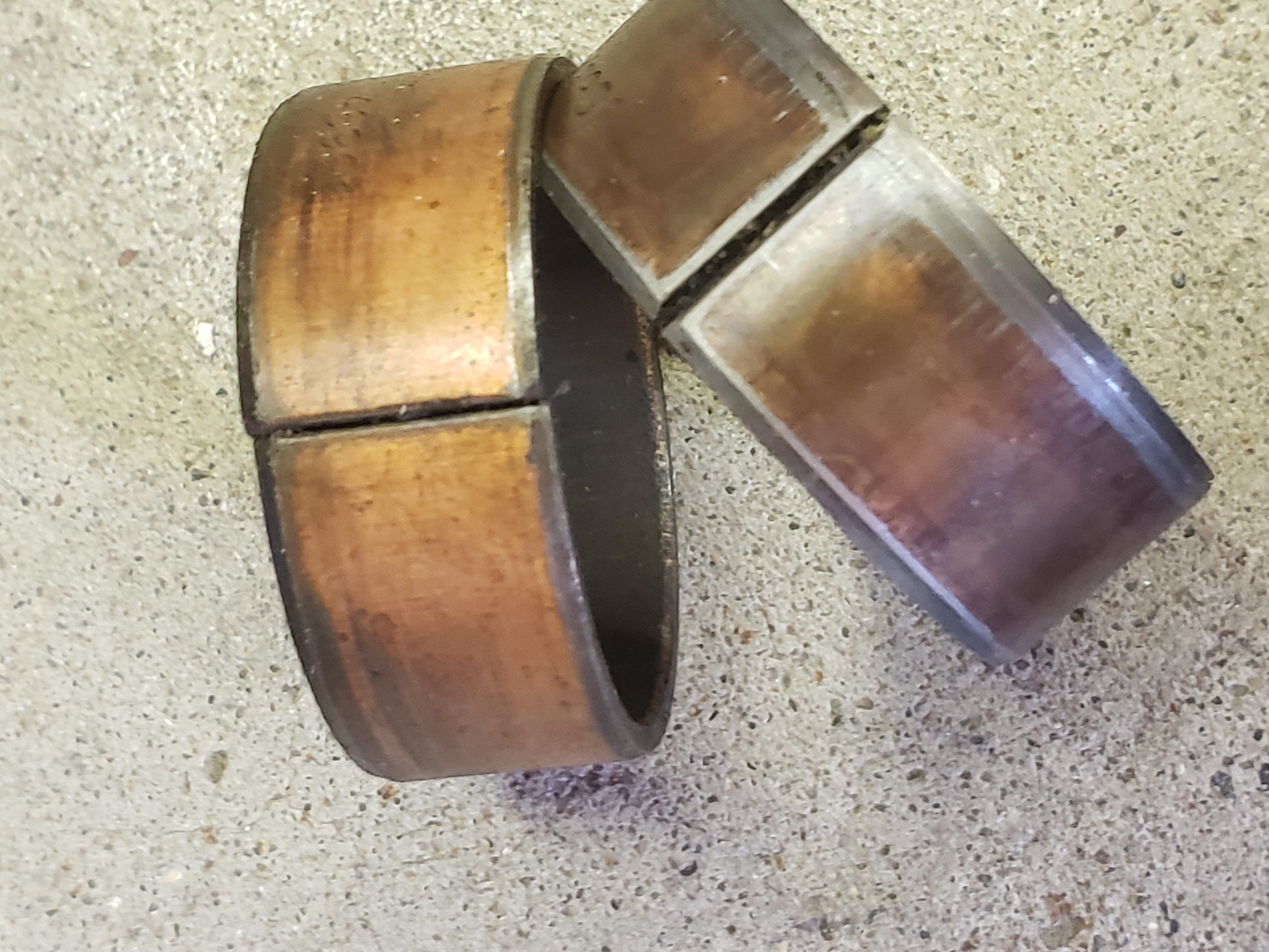

    For example -
    Good Condition Bushings:
    Poor Condition Bushings:

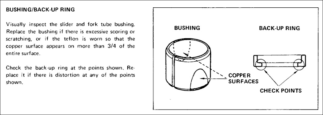

    Here is the inspection process per the service manual for the 83 250R
Name:	Bushing Wear copy.jpg
    NOTE: my example pictures aren't entirely apples to apples comparison. The example of the "worn" bushings are just as an example. These are actually the upper bushings which are coated on the inside. The outside of the upper is always copper colored like that. BUT, as an example of what a worn lower could look like, it is representative.

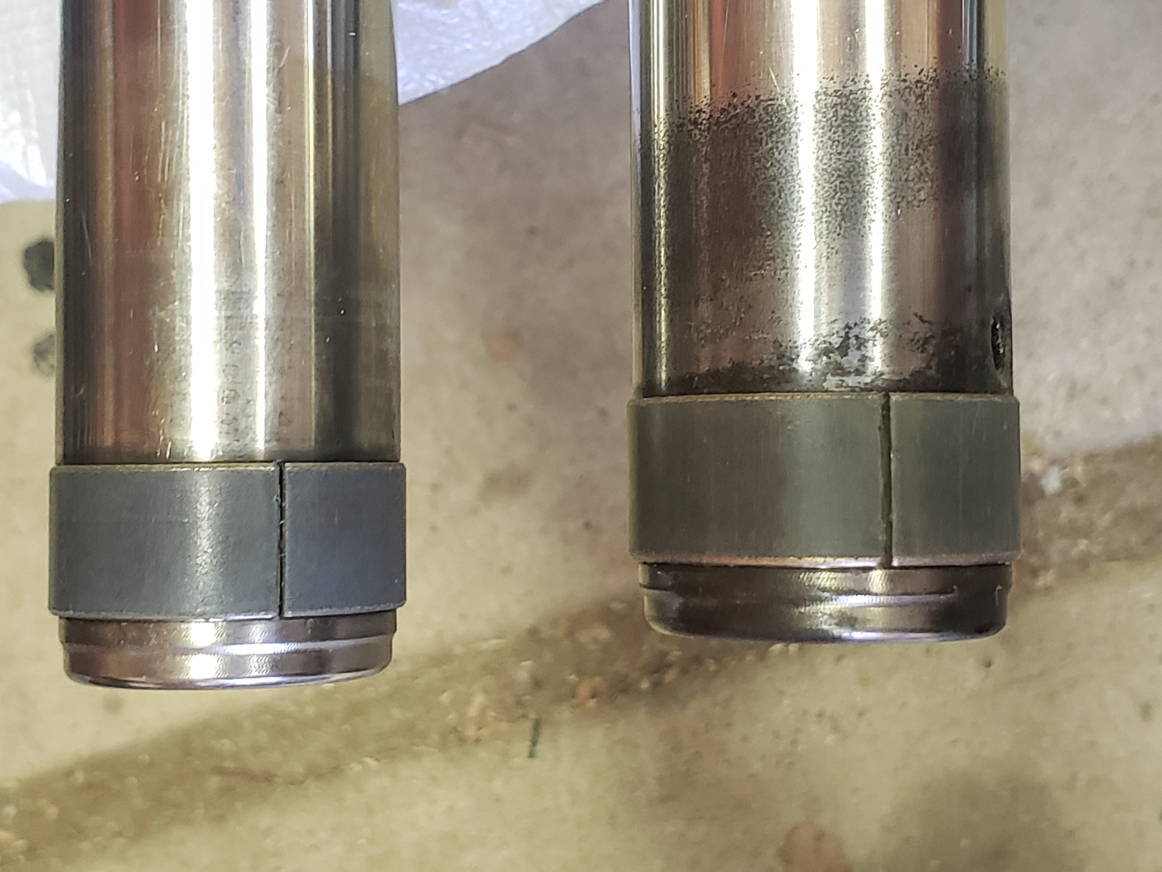

    Mar 2014
    Kansas
    6
    Per your direction, I inspected the bushings. The uppers appear to be almost brand new. The lowers have some copper showing through the teflon but its less than 1/4. Thank you for your direction and I will be replacing the seals and refilling the forks.
