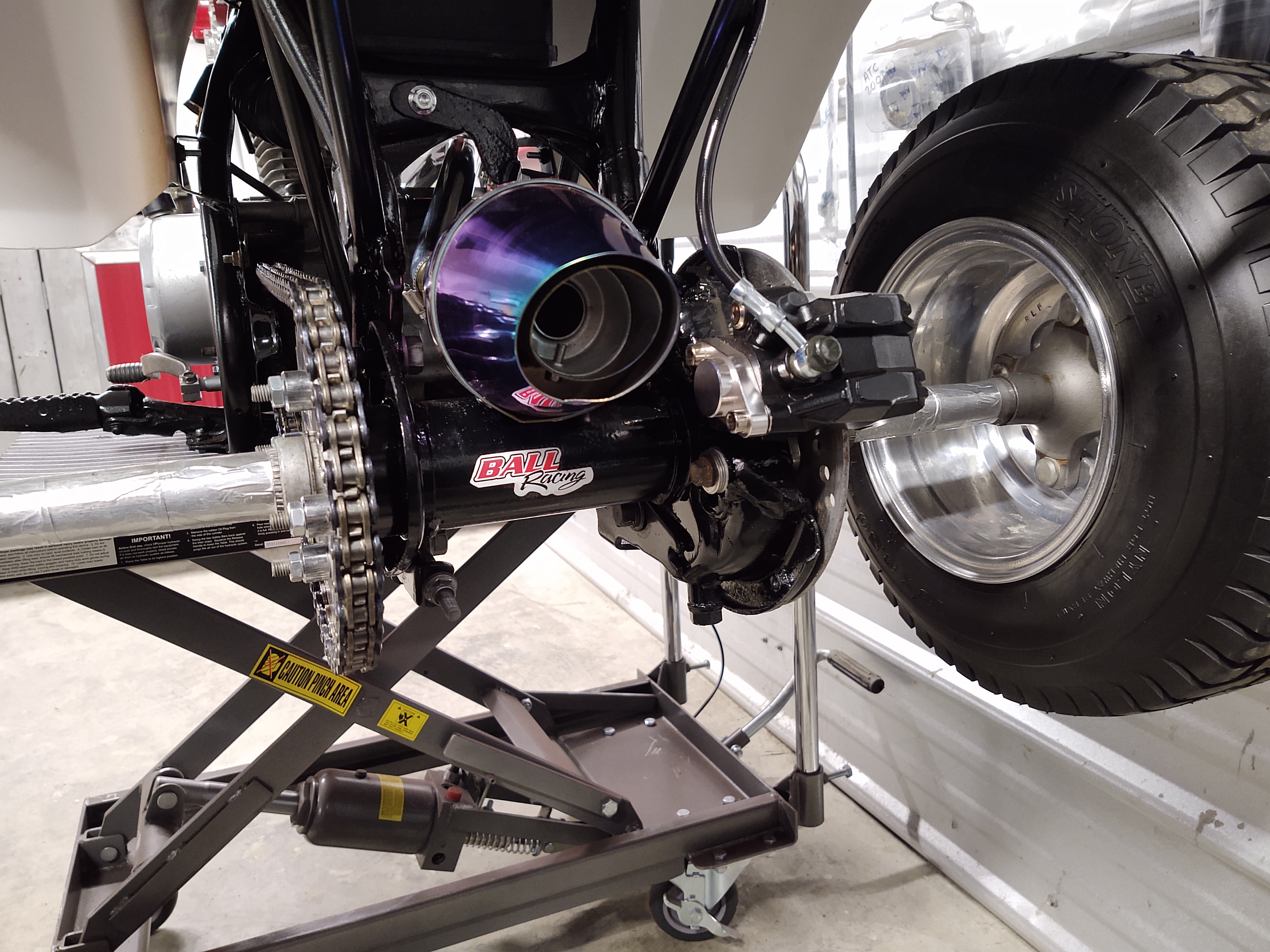

    ATC200X (83-85) disc hub and disc are direct replacement for stock brake hub (some spacing required). It will slide right one and they are plentiful on eBay.
