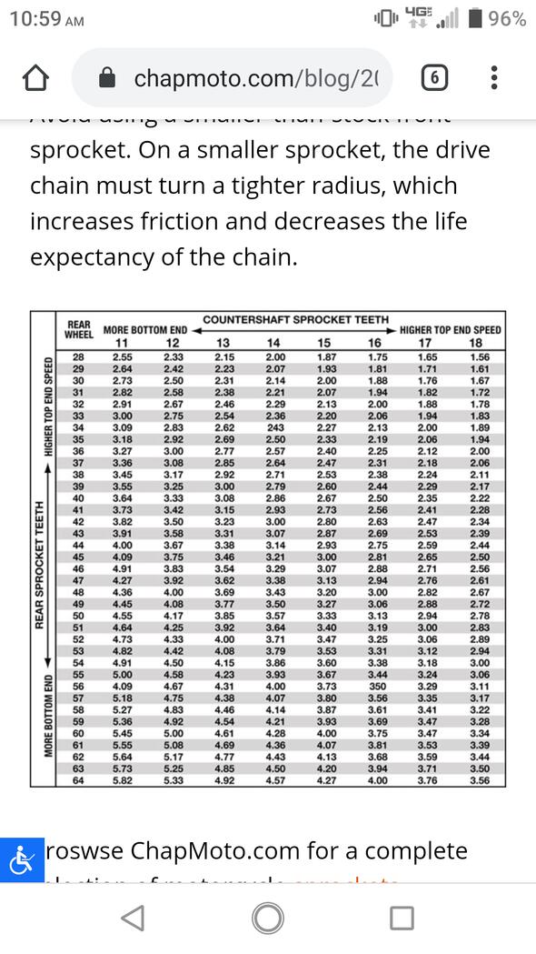

    Just found this chart if it will help anyone else out.

    If you want more low end your going to want to go to a smaller front sprocket or a larger rear sprocket.
    *I see now that thats what the chart you posted explains lol.

    What are your goals with your machine? If you want a faster road bike, go higher geared and/or larger tires, if you want more grunt for hills, mud, off roading, wheelies, etc, go lower gear, or assume Honda has a good sweet spot and stick with the stock ratio.
    You can calc it as rear sprocket/front sprocket to give the gear ratio for number of turns the engine output shaft turns per turn of the rear axle. So a 40/10 combo is 4.0 gear ratio. If you want about 10% faster speed, then times the number by 0.9 (90% of current number) which would give 3.6. With that target, here would be your options:
    36/10
    40/11
    43/12
    I got those numbers by front sprocket times gear ratio, aka 10 * 3.6 = 36. Math, yay fun stuff lol.
    If you have different numbers in mind, post them and I can run through the math real quick. Same goes for the tire size, you calc how far the tire travels per turn (circumference of the tire) and you can compare different gear ratios with different tire sizes. If you make your tires 10% bigger, but make the gear ratio 10% lower, then your overall performance should be very similar to before, just more spinning mass/weight so slightly slower take off.
    Here's a page with the stock gear ratio and more. The sprocket gear ratio is called the final reduction.
    https://atvmanual.com/honda/atc185s/1983-specs
    The service manual doesn't seem to say what the stock sprockets are, but if the front sprocket is 11 tooth, the math comes out as the rear should be 41 tooth.
