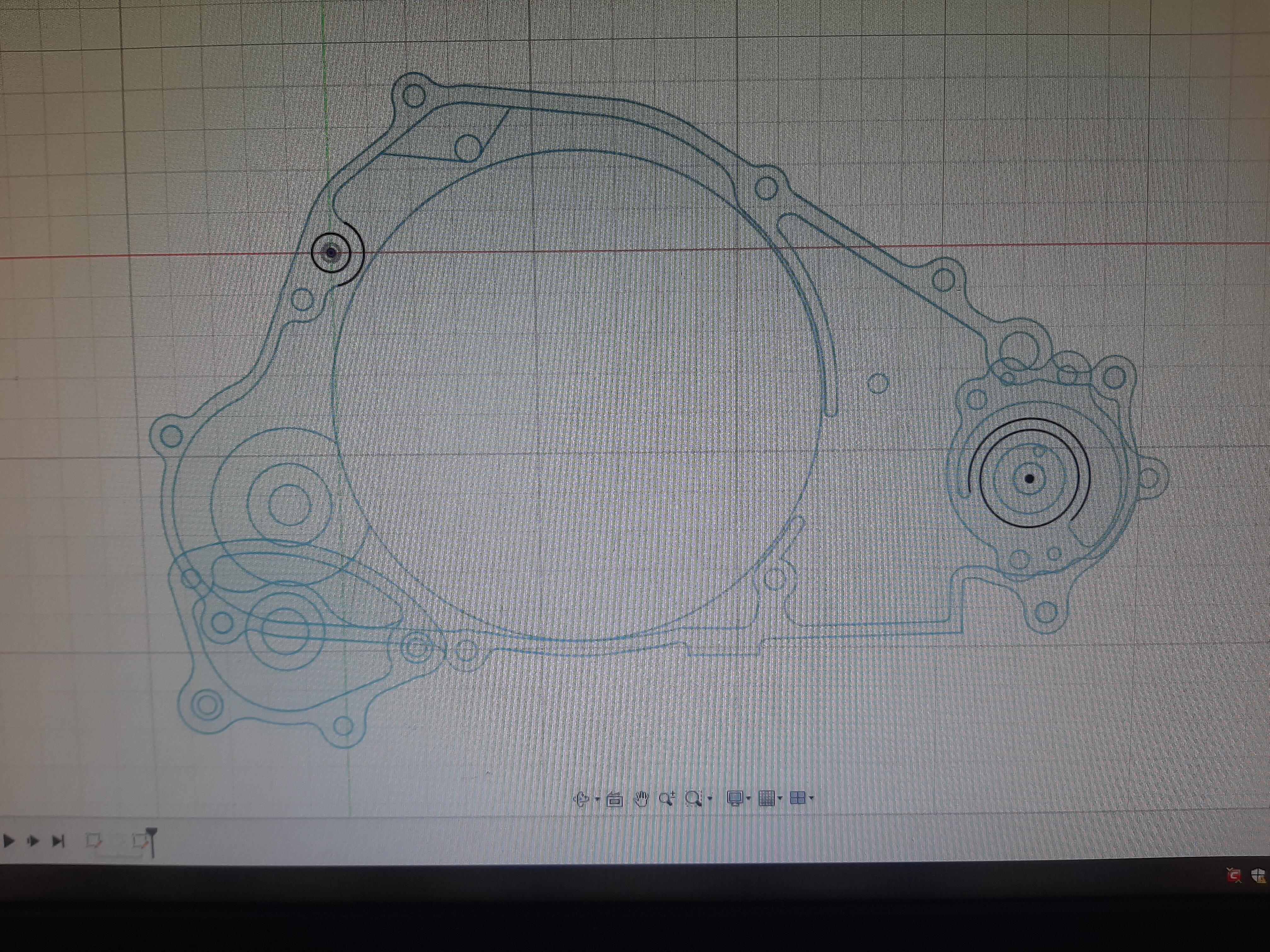

    It's not much progress, but at least it's forward progress. I should be able to have my CAD model finished next week. I'm in the process of learning to use Fusion 360° CAD/CAM software after 10yrs. of using Mastercam.
    I'm still not sure how long it will be before I can order material, or how much it will cost yet. After some scrounging around the shop, I came up with some scrap steel that I can clean up and use to make fixture plates.
    I'll post more pics when the CAD model is finished, but I'll probably have to wait till after christmas to order material.

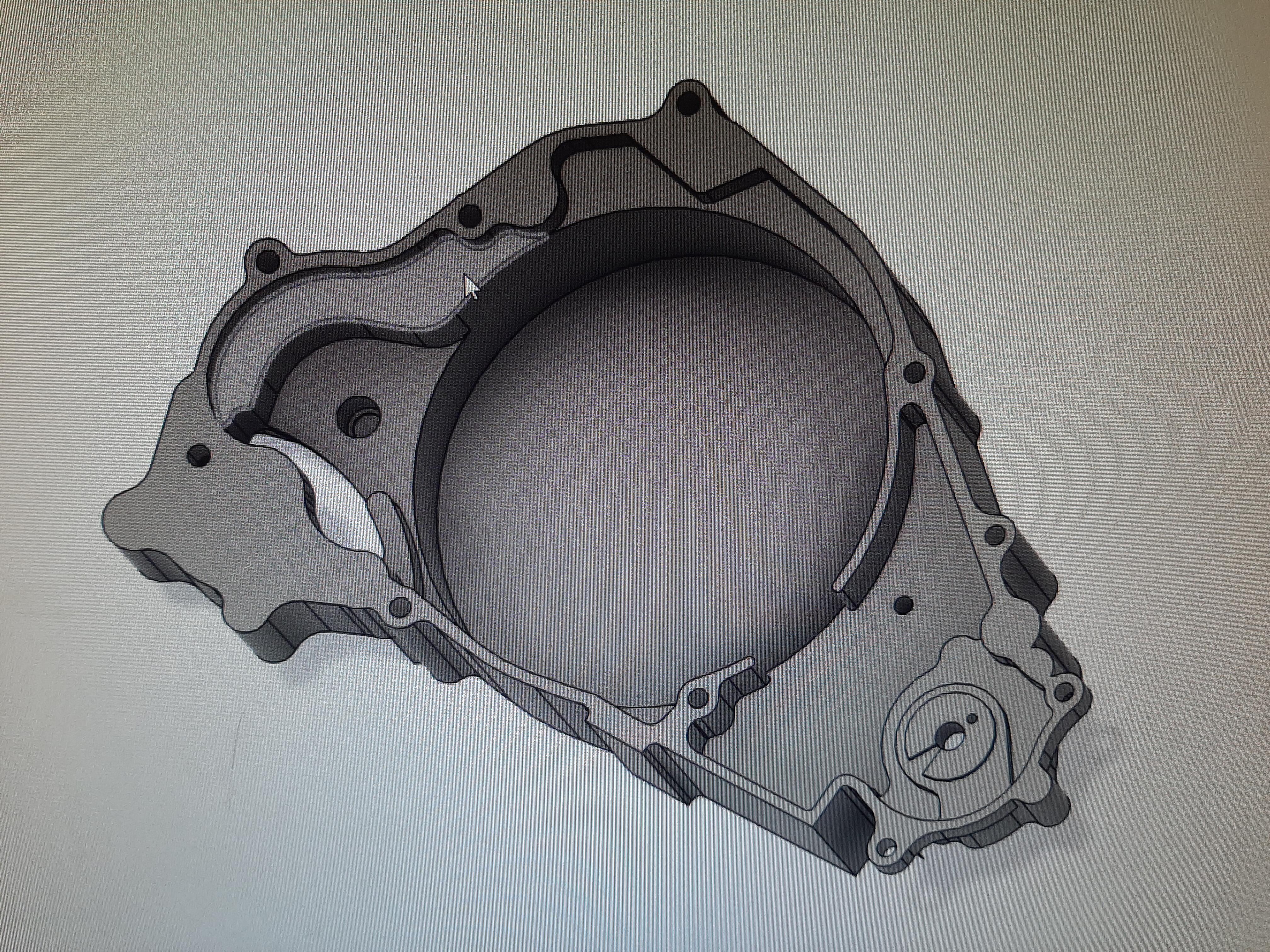

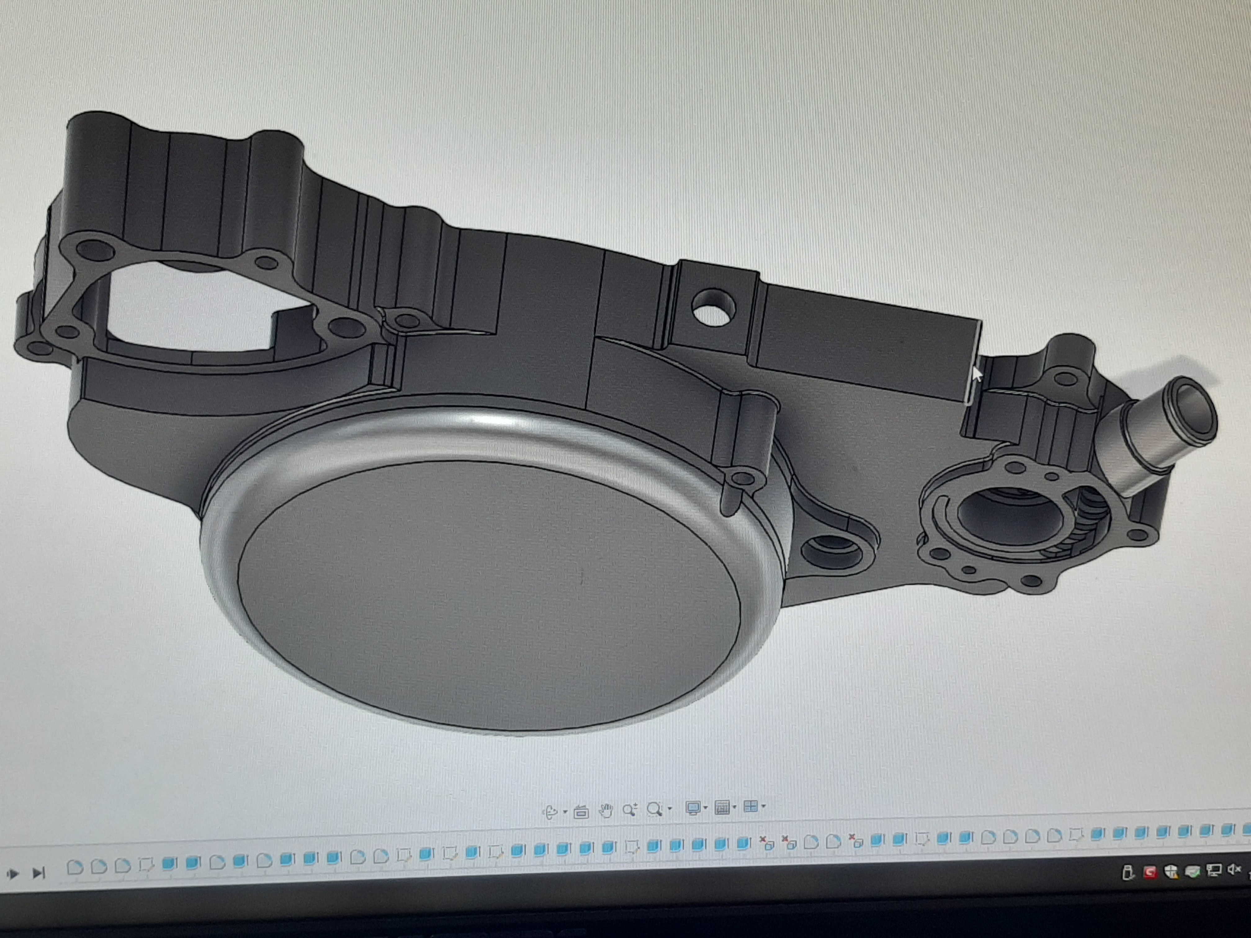

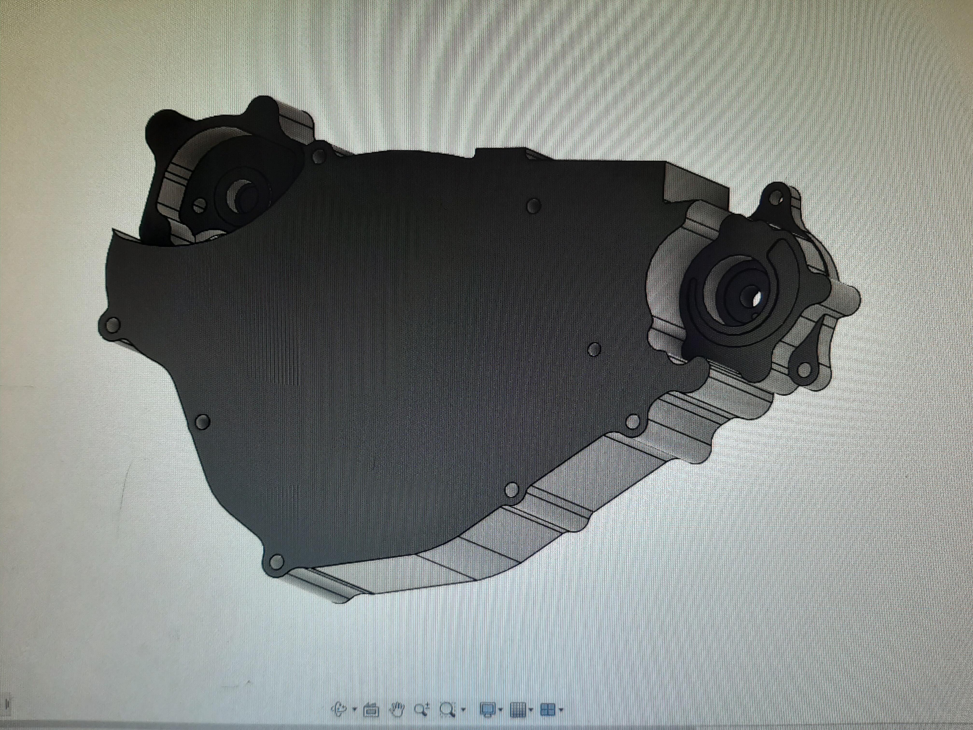

    Thankyou for the kind words. I just finished the cad model today. It's a big step in the right direction.Click image for larger version.

    If it’s not too late please allow for a little extra space for a Talon clutch basket to fit. The stock clutch can rub when it gets worn and the Talon baskets require that you grind the two ribs at the top of the cover in order to use it.
    Removing those ribs and extending the inside of the face of the cover 1 or 2mm would fix the issue.
    Good luck!!!

    According to all my measurements, the factory clutch basket has about .085in clearance to the two inner ribs on the clutch cover. This is the tightest point I can find. A Talon clutch basket would have about .04in of clearance at these ribs on a stock cover. This problem is made a little worse by the fact that both the factory clutch basket and cover have a taper, or draft angle built in so they can be pulled from the mold. Both the Talon basket and my cover will have straight walls. My cover with a Talon basket should have about .091in clearance to the tightest point, this point being one of the cover mounting bolt bosses in the basket pocket itself.
    As far as the sight glass, that's really my preferance. I hate having to pull out a bolt just to check the oil level. Draining and refilling isn't any better of a system when you just want to check the oil level.
    A quick change clutch cover would be nice, but will add to machine time, setup time, material costs and overall part cost. I may play with a quick change cover if I am able to get my own cnc machine in the next year or so. Due to paying the shop I work at for actual machine time, I need to keep my run times as low as possible.
    It may not look like it, but I currently have about 100hrs in dimensioning and drafting that cad model.
    N.E. Ohio
    2,005
    Don’t discount expansion to the basket at running temps under load, might be slight. Just something to ponder.

    This project is still moving forward. I've been staying at work late for the last week to get this programmed. Tomorrow is my day off, and I'm hoping to go in and finish programming everything. I told my manager to go ahead and order 2 pcs of aluminum, I'm still waiting to find out the exact price on stock.
    To clarify the clutch basket clearance issue a little further, when I drafted up the cad model I opened up the inner diameter of the clutch basket pocket by approximately .200in. If I calculate the talon basket diameter against the basket pocket diameter, then I come up with the .091in that I mentioned above. I cannot move any of the cover mounting bolt locations, and the boss around that bolt will be .1in thick vs .12in thick stk.
    This means it should have more clearance since I made the pocket larger and the boss thinner. That makes me believe that the stock basket isn't centered in the pocket from the factory.
