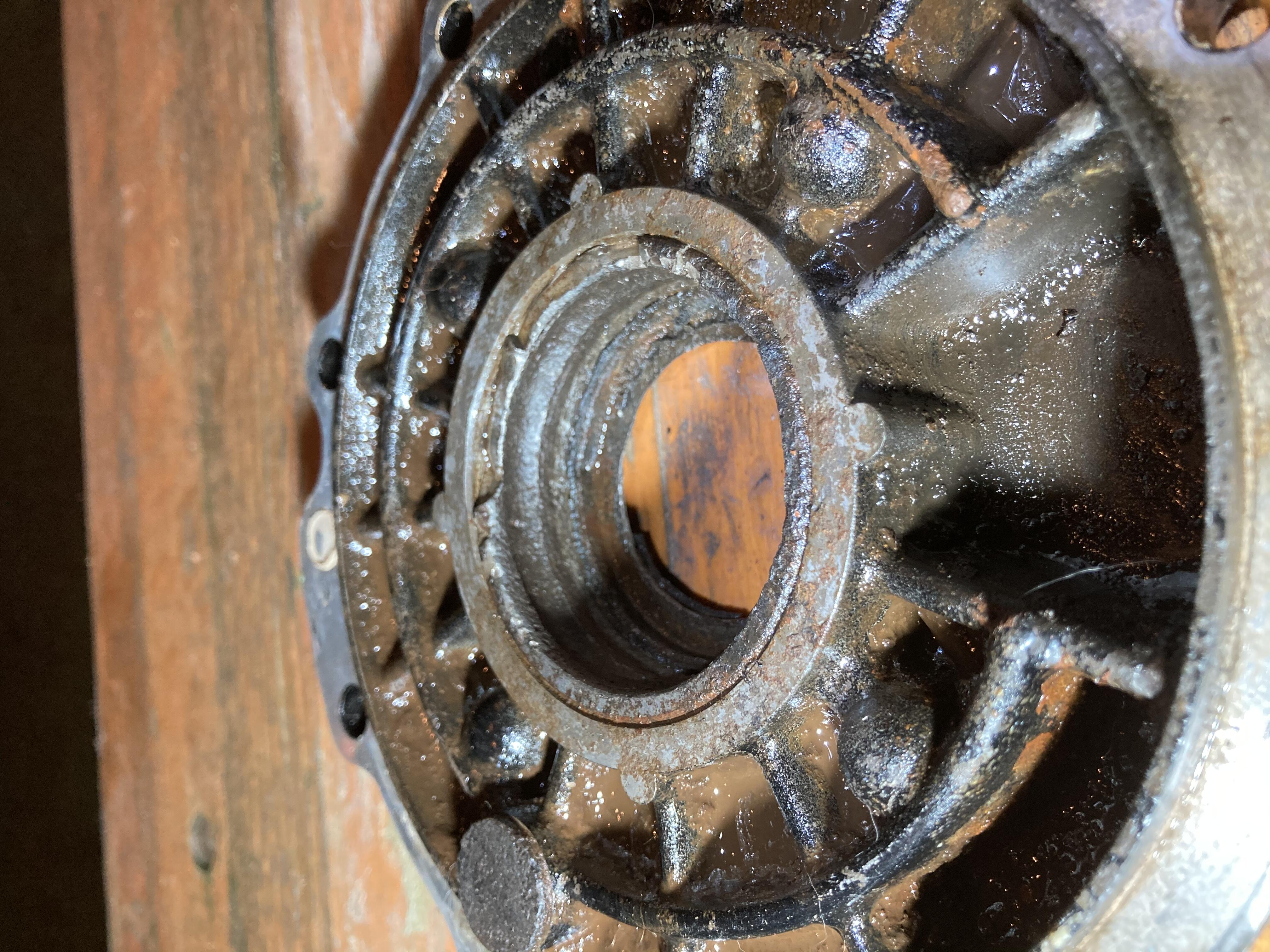

    I’m pretty sure it’s not supposed to look like this!

    I think it may well be the case that this diff is toast! Very annoying!
    Arkansas
    2,447
    That gear is roached.
    You're going to be better off finding a good, used, final drive. As long as a bearing didn't spin, you can put the case back as a spare, or strip it down, clean, and sell it.
