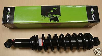

    What year 300 ? 2wd or 4wd ? And any pics ?
    I bought the Bronco Au04256 which is for the 4x4
