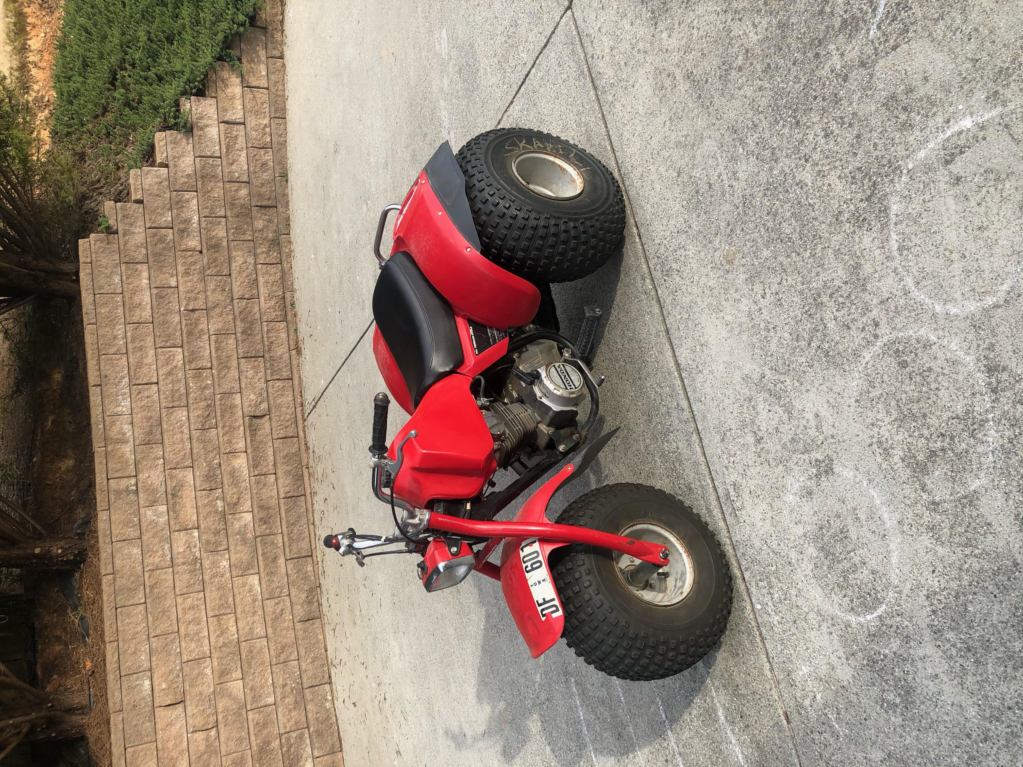

    Well, rolled her out of the garage today. Continued to pull on her to try to get her to turn over. After maybe the 35th try, she sputtered. About 5 more tries and she ripped off. Lots and lots of smoke came out as i revved it up. Took her up and down the street a bunch to get things moving. Since a brand new carb is cheap..maybe just toss on a new one and see if that's what was causing the problem?
