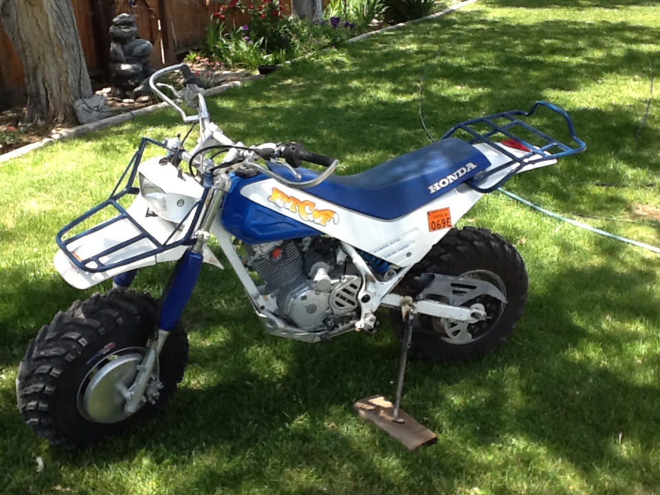

    200x
    [IMG]img 0032[/IMG][IMG]img 1159[/IMG]

    . Torn apart
    May 2021
    Nevada
    13
    Pic
