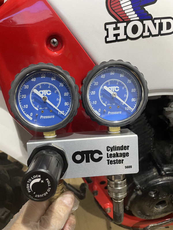

    Looking for my source of smoke
    1) fresh gas not mixed
    2) pulled exhaust packing
    3) compression test gets me to 160s at about 8 kicks throttle open (cold or warm)
    4) leak down at tdc at 100 psi shows maybe 4-5 psi leak or less, can’t hear a leak
    Starts on first kick, runs great more smoke on throttle, minimal at idle
    KISS is rings but I’m not able to prove it

    Rechecking my leak down
    I may not have swapped out hose w valve on it
