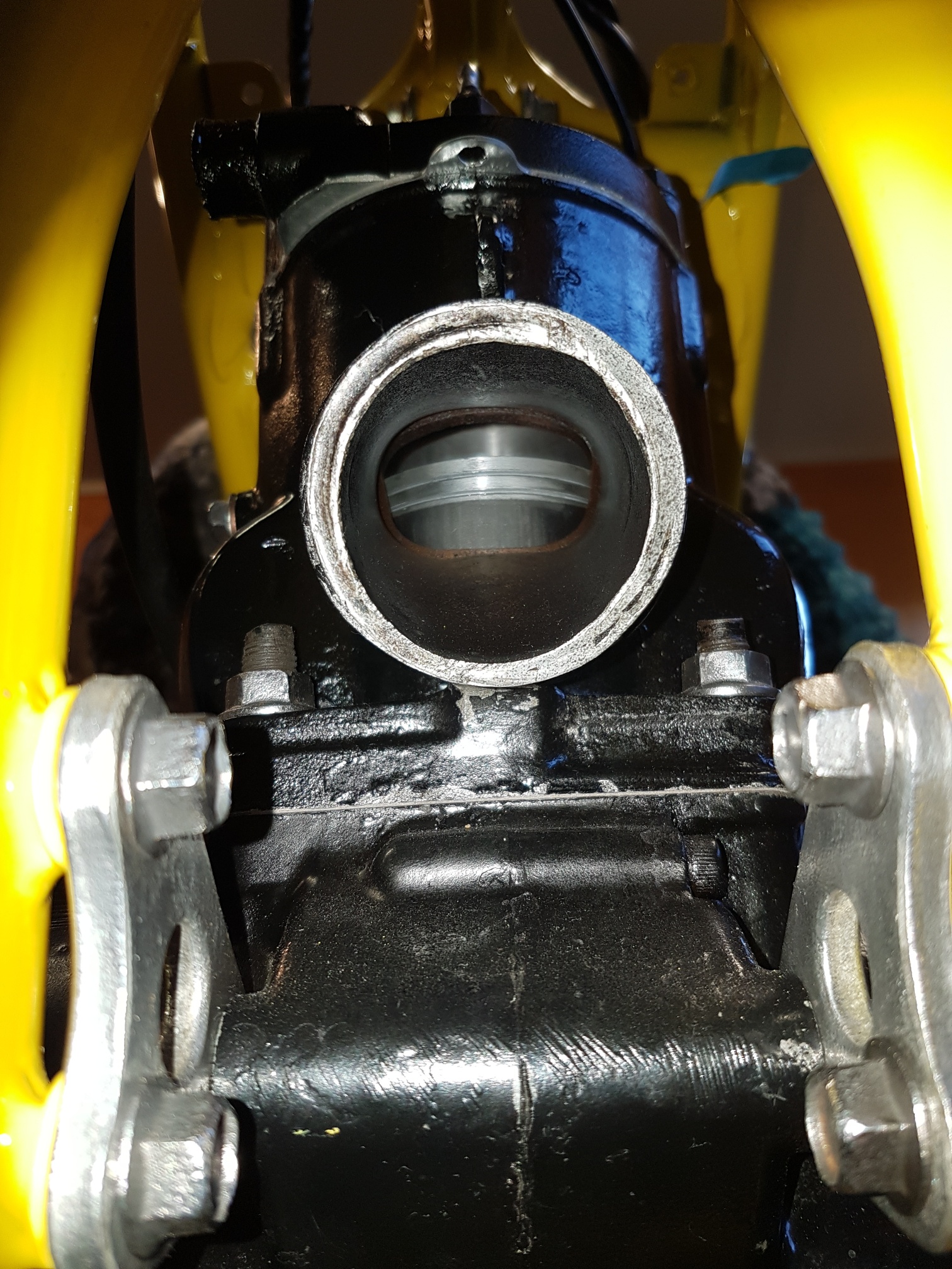

    Hey El Camexican, thats awesome thank you bro...ive been abit premature in getting her back together before really understanding these mods...u reakon i could slide the cylinder off, with the head on and it in the frame, then i could check correctly the distance between the top of the exhaust port and the head gasket...photos dont really show much

    Based on the photo I don’t think anyone has touched the exhaust port.
    I saw what appears to be weld, or epoxy in the photo you posted of the intake and assumed that if anyone was willing to rape that cylinder with a drill bit as as it appears they did, then they would have likely gone on to abuse it in other areas. Hopefully for your sake the stupidity started and ended with the boost port modification and that the cylinder was properly welded and decked after it broke.
    Please do a pressure test on the engine to check the seals and gaskets for leaks before you start riding it. You’ll save yourself a pile of money and time if there’s a leak to be found.

    The exhaust port was probably spared because the only tool the guy had was a hand drill. If I had to bet he started off with a large bit and got in crooked. The correct way to do it unless you’re some sort of porting savant is to carefully drill a pilot hole with something no bigger than a 1/4” bit and then determine if you can open it straight through with a larger bit, or if you need to switch over to proper porting tools and correct any misalignment. I’ve done five of these and my arse still puckers up while drilling the pilot hole.

    i got the cylinder off a yes as you suspected no work on the exhaust port, im tempted to give to my m8 who owns a motor machinist shop who honed the bore for me as i only own a dremel and dont think i can get the right angle on the port edge with that. Option 2 is to buy a right angle die grinder but it will have to be tiny to get in the bore...decision decisions lol.
    Looking again at the cylinder does suggest that yes a drill bit too big, too soon and not incrementing slowly enough on both holes was attempted and no competence present lol
