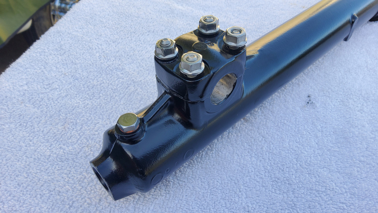

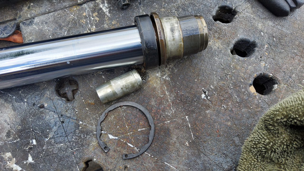

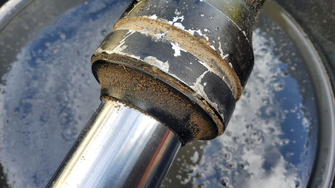

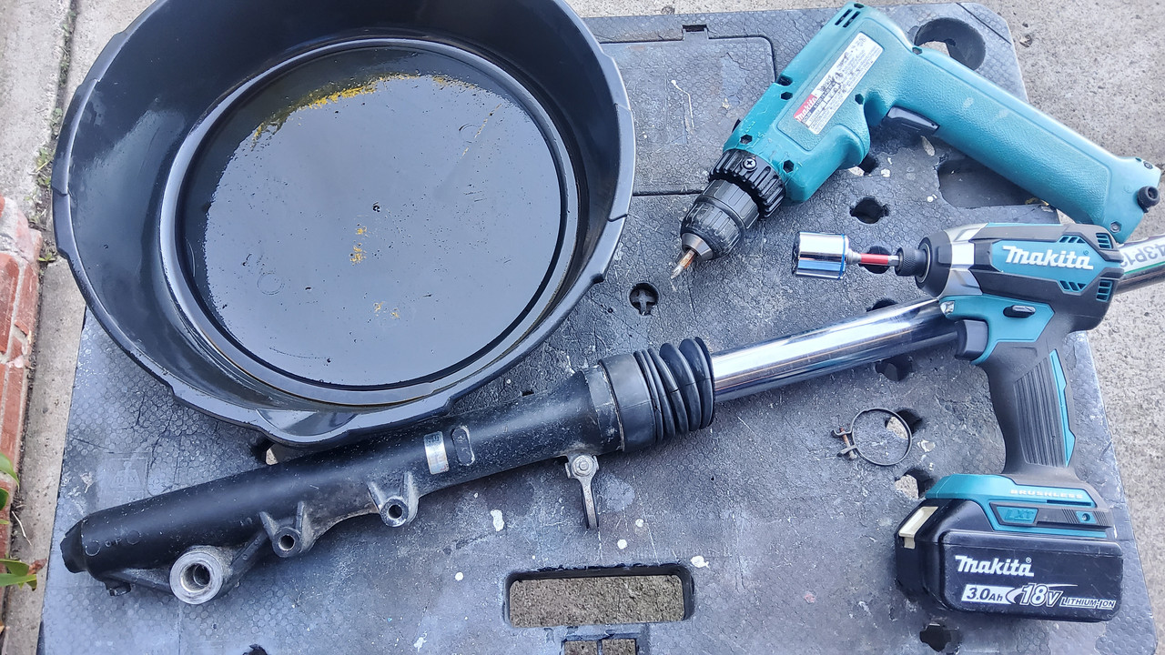

    One fork disassembled.
    Tapatalk says "network config"? so I can't upload photos. I can't upload photos on safari, chrome, etc....the only way I was doing it was through Tapatalk and now that that is gone this thread may be as dead as this project is.
    A picture is worth a 1000 words but I'll just say things cleaned up nice and all. I think I will just overhaul them vs rebuild as I'm not going to spend the $$ on springs. It already looks like my new budget will be $2000.....and even at that I may pass it.

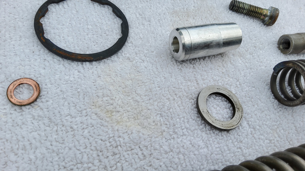

    A picture of some tidbits from the fork.

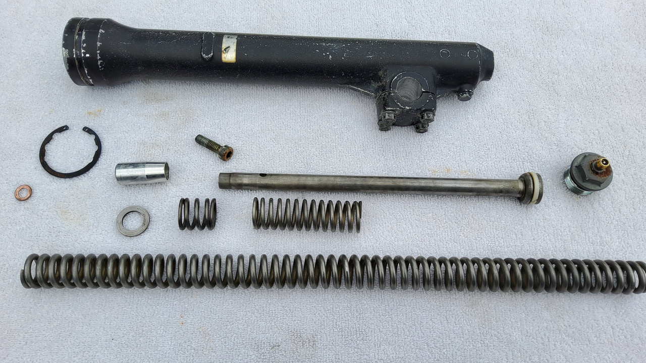

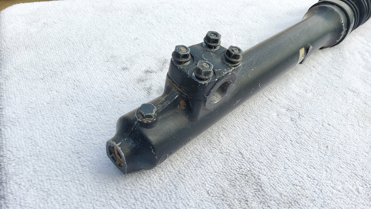

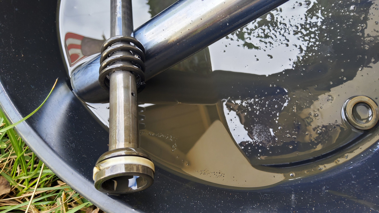

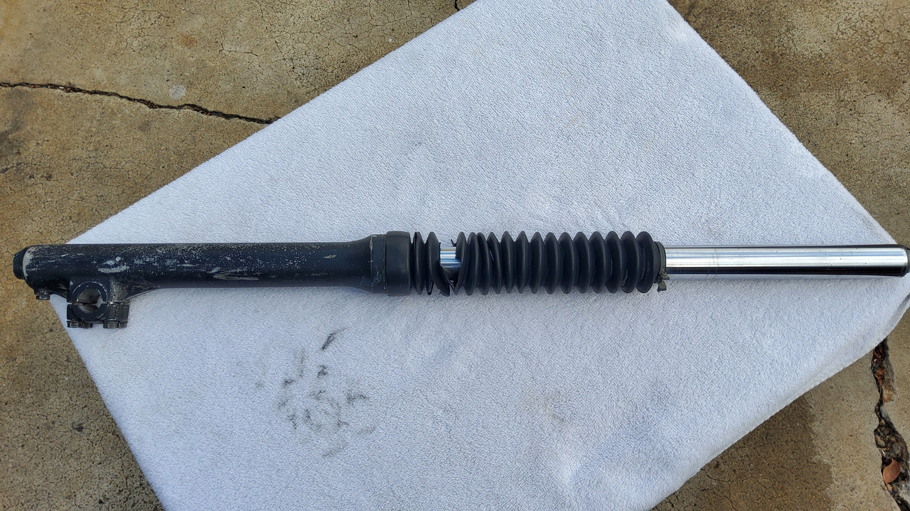

    Internals of one fork all cleaned up and inspected.
    I'm going for a poor man's overhaul. Already have the seals and got o-rings that will replace everything. Going to use some pvc for a little preload and Walmarts best ATF. That should give it life for another 20 years of sitting.

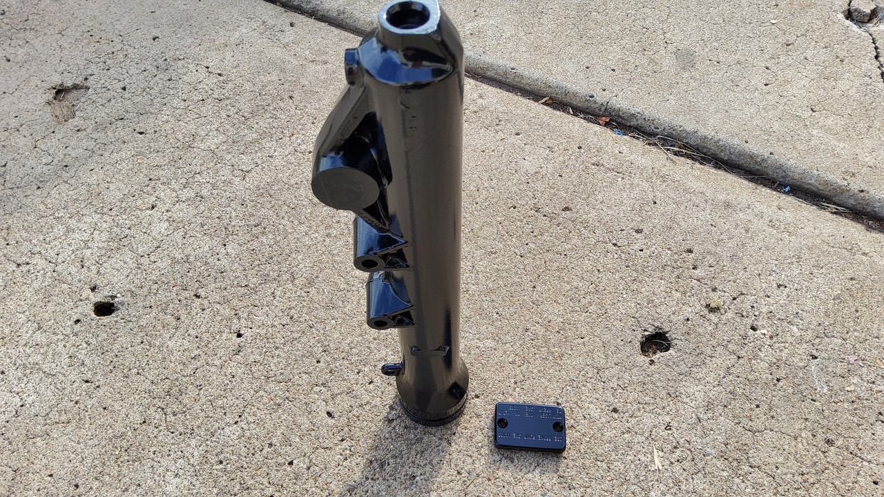

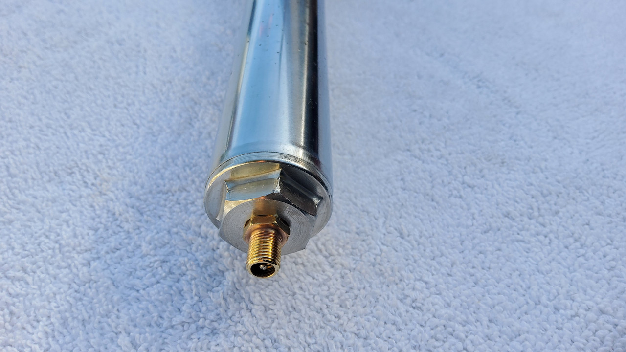

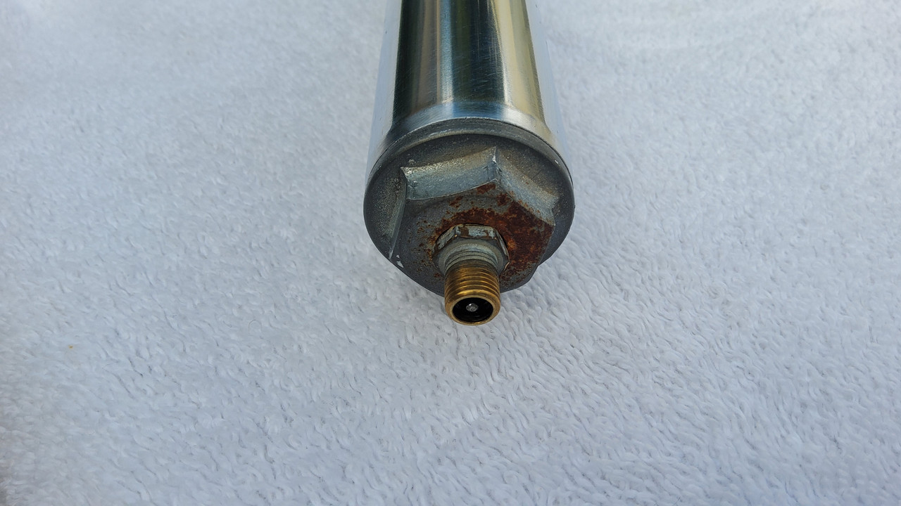

    1 tube down 1 to go.
    All serviced & assembled & ready to go.
    I havent added ATF yet or zip tied that gator.... will do both of those when they are on the bike. Now on to the next & final one

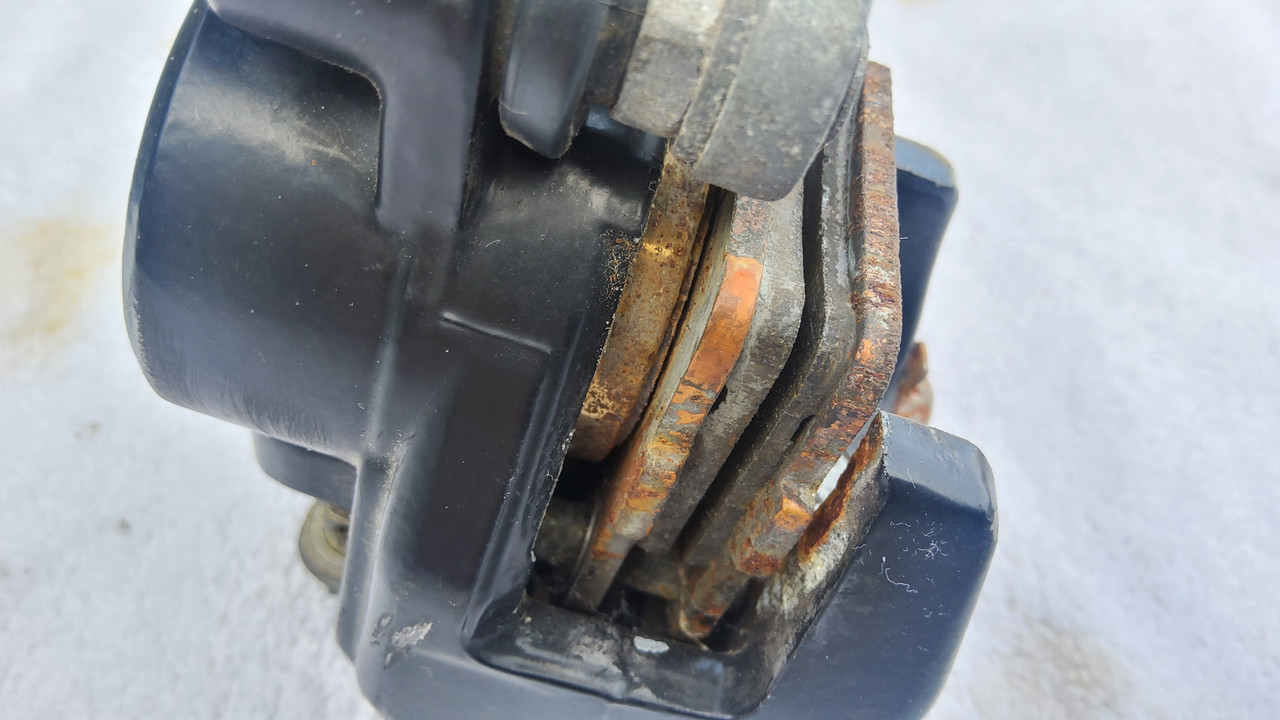

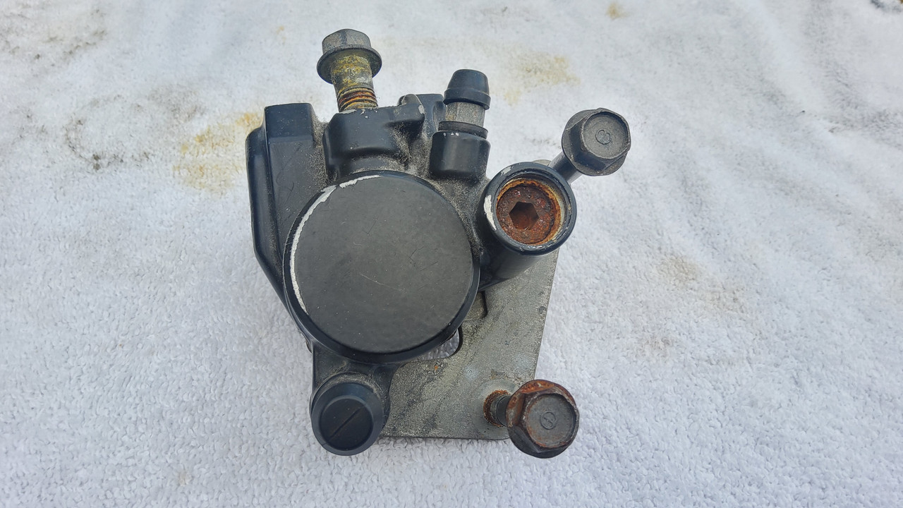

    While on the forks I've been contemplating the front caliper.
    My new budget is $2000. I feel confident I could have made my initial $1500 budget if I would have also stuck to my initial plan of just getting it going....probably well under $1500. Doing anything cosmetic is more money than doing practically anything else on any project.......& it looks like at some point in this project I decided to go the cosmetic route…. not all the way but still more than I initially planned so hence the new budget. Plus 2 years ago when I started this rescue things weren't so costly.

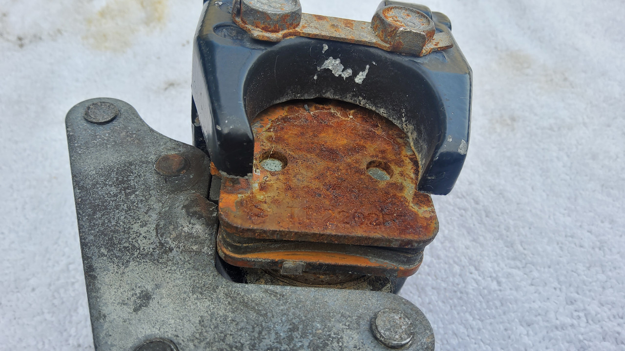

    Every aspect of this caliper is stuck solid... everything is frozen and nothing's moving. I'm going to let it sit in some penetrating oil but even if I have to splurge on a new one it's not a budget buster. It kinda goes new caliper with everything $45. Just the caliper & not the carrier $35. Rebuild kit with everything $25. We will see how everything loosens up.

    Blaster penetration oil, don’t bust your knuckles: bust your nutz!
    200x the best buddy bike ever made, anybody at beginner to expert level of experience can have a great day on it.
    Caliper- call Cycles R Us is a salvage yrd that offers new parts as well. Might have to use the old mount bracket but call em
    330-760-2629

    Quote Originally Posted by Tri-Z 250 View Post
    Caliper- call Cycles R Us is a salvage yrd that offers new parts as well. Might have to use the old mount bracket but call em 330-760-2629
    Right on man....thanks for the lead.
    Things are soaking in Kroil right now but I don't have high hopes for it....it's just a sense. I mean the rear caliper & both front and rear masters needed to be replaced.....I don't think the front would be any different. It's the cost of leaving things outside neglected for years....it's always the brake systems that need replacing.

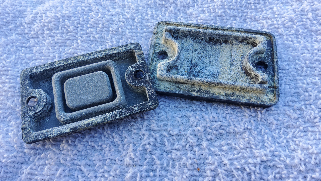

    Air valve caps came in.
    It's amazing how 100 pieces can come clear across the earth to my door for $1.99 plus tax.....$2.30. It just led me to thinking about how I can't unfreeze that front caliper but it's OK because somewhere in the world I can get a complete one ready for installation for $45.00.....that's going to be the plan.
    It's now $2.55 from the same seller I purchased them from....still a steal.
    https://www.ebay.com/itm/22585173127...mis&media=COPY
    While I'm at it I'll probably get a new repop rear reservoir from clear access the globe as well for $21.
    I'm going to see if I can clean it and also squeeze it together with some heat as over the years of neglect it became swollen and cracked and it may not hold fluid at all.... I don't know

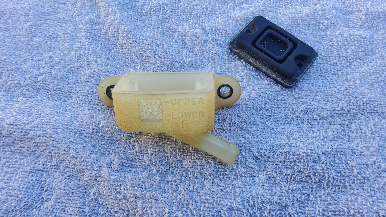

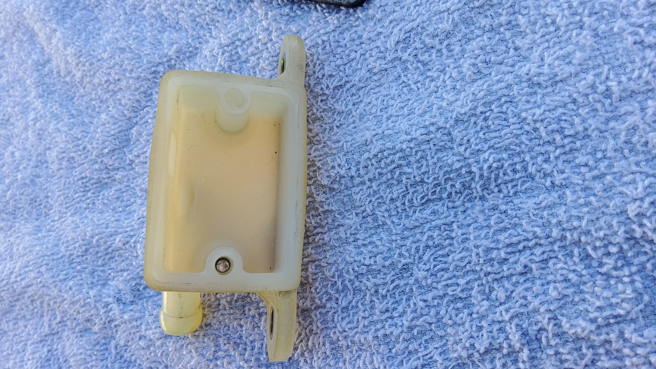

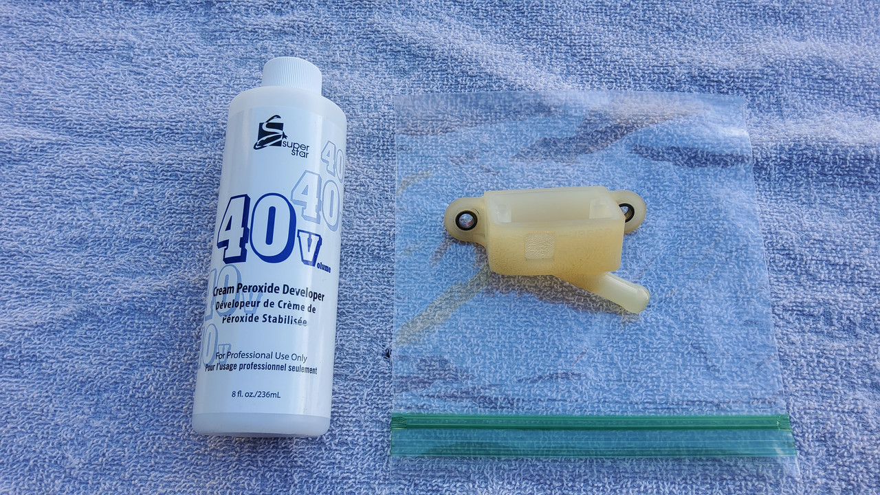

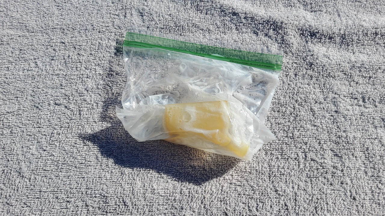

    We had a nice day so I decided to see if I can bleach some of the yellow out of the reservoir. It came out better.....I can get it probably better if it had a couple of more sunny days but that's not in the forecast so it will do as is.
    I also decided to start using the Autosol after plating because a couple of plated items are starting to lightly rust.....that dosent happen very often if you use Autosol at the end.

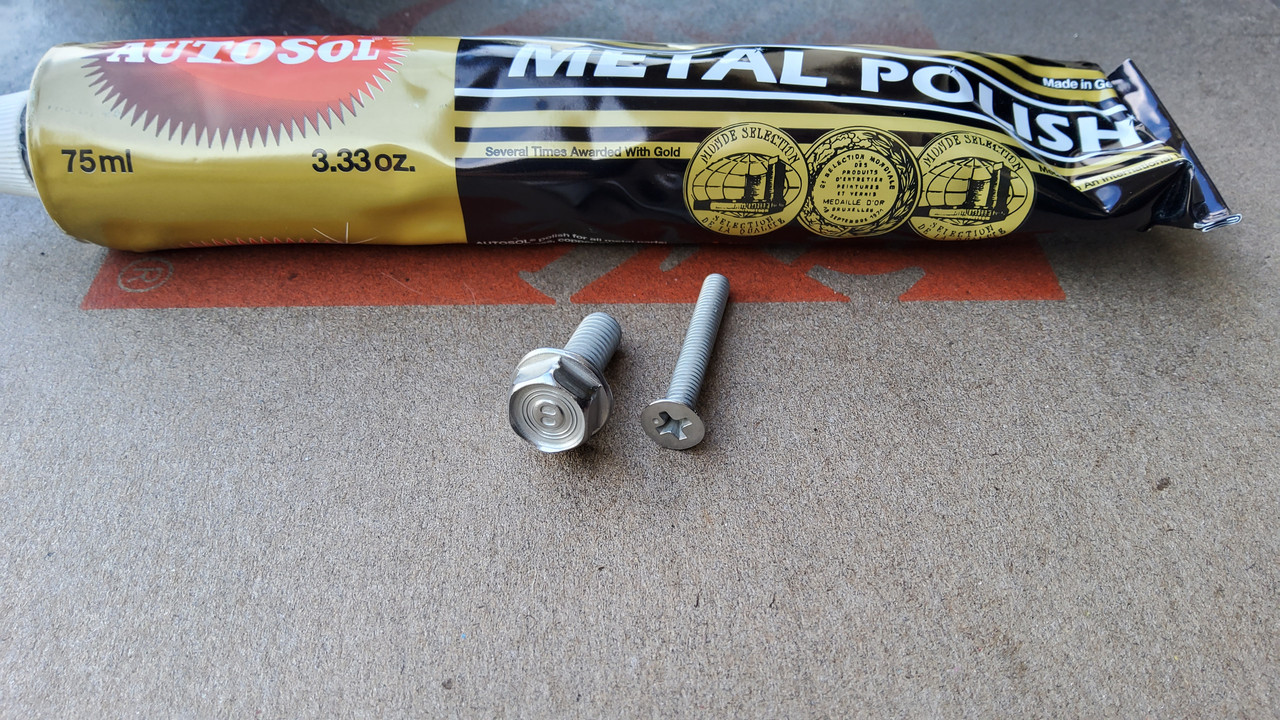

    Also just waiting for some painted items to throughly dry before I start to handle them for assembly.
