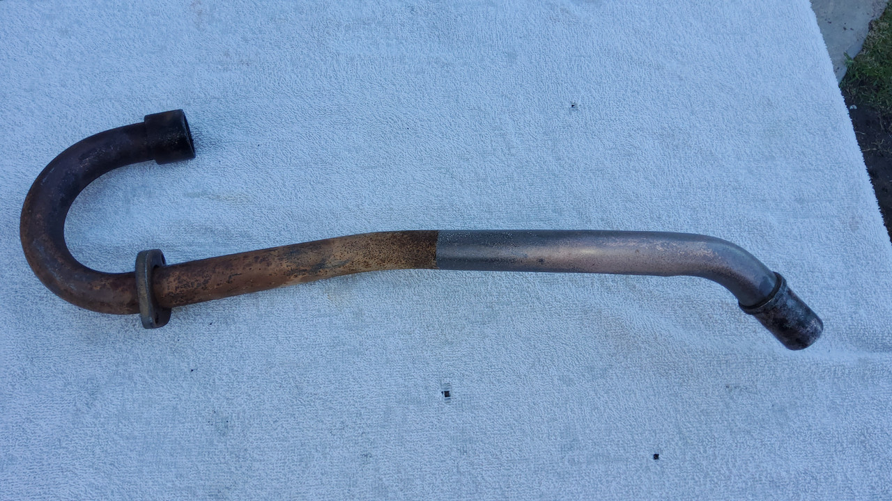

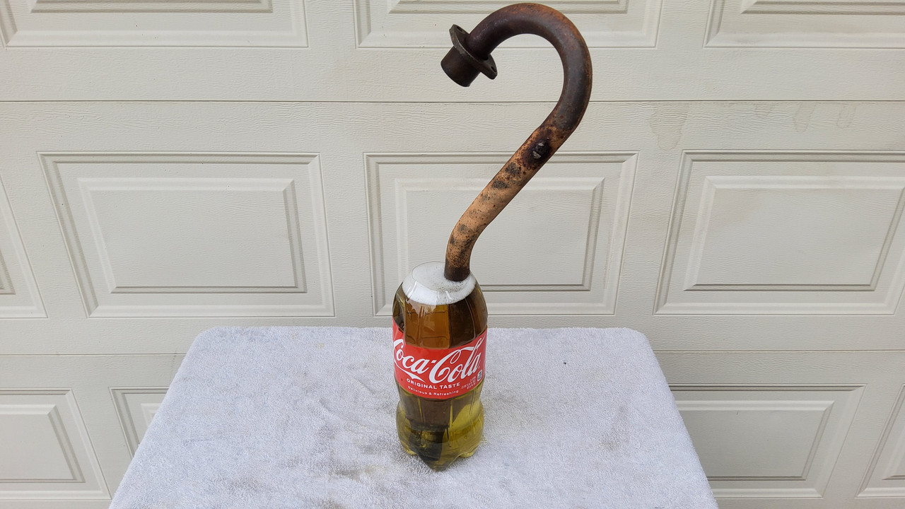

    Half done stripping....half to go. Just waiting for the cat litter container to be empty....that should fit the other half of the exhaust completely. I'm just using whatever used plastic container comes my way.
    The exhaust headpipe was so pitted with rust I might as well have just sandblasted it. It's still easier just to let it sit in the acid and take it out later & rinse.

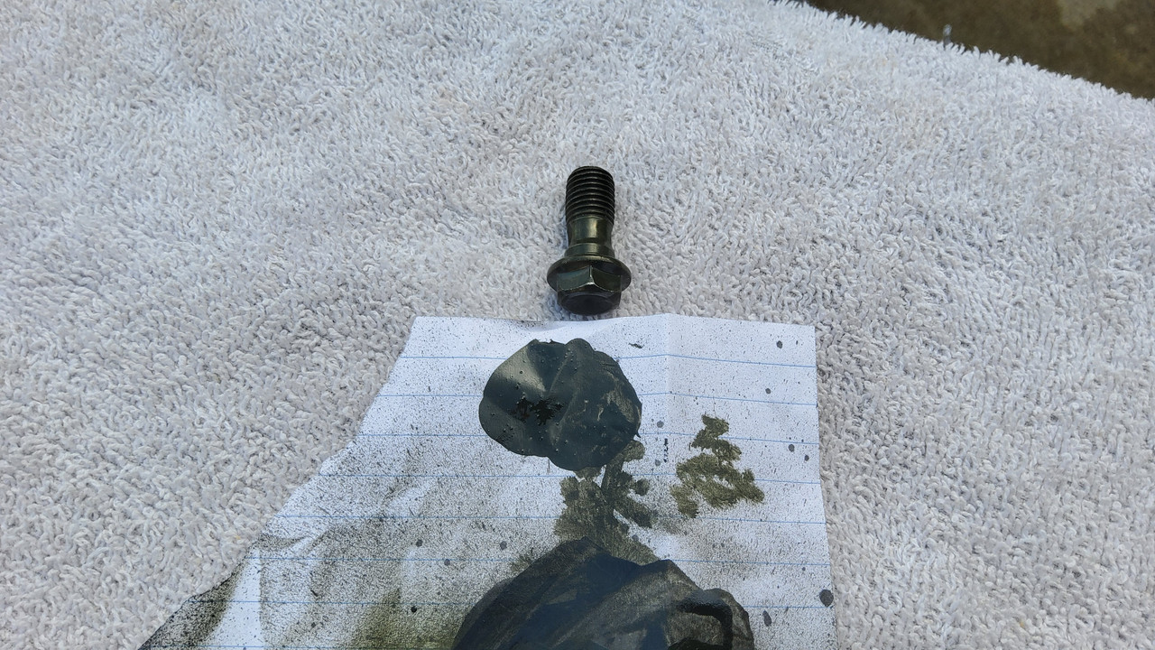

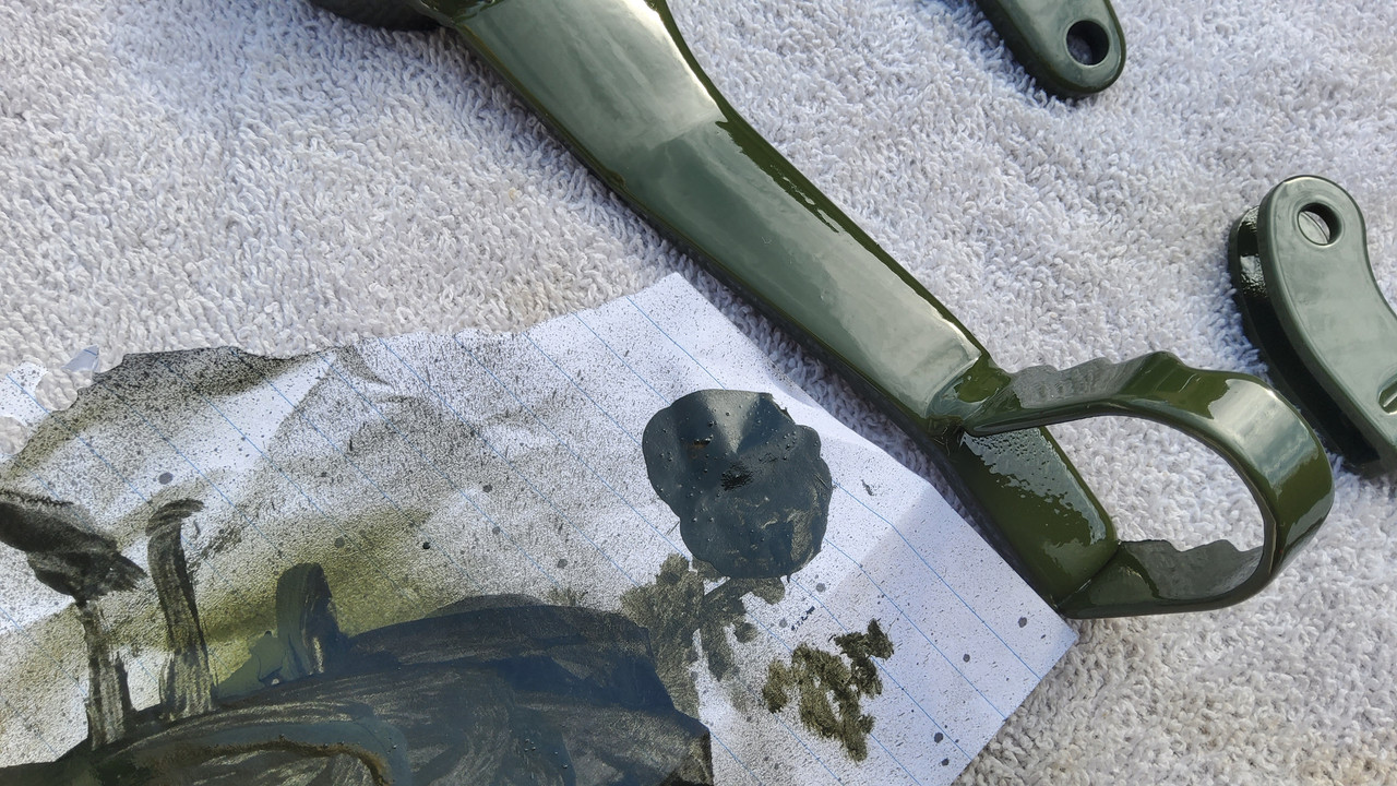

    Well just as I thought..... the green is far to green.
    I tried to match it to a new bolt that came with the master cylinder....it looked good on paper but not in reality. The only thing I can do is spray it into a cup and mix some HD vivid black and see if I can't get it a little darker. I mixed a little to see if it would be closer.
    I should have listened to everyone and just painted it black.

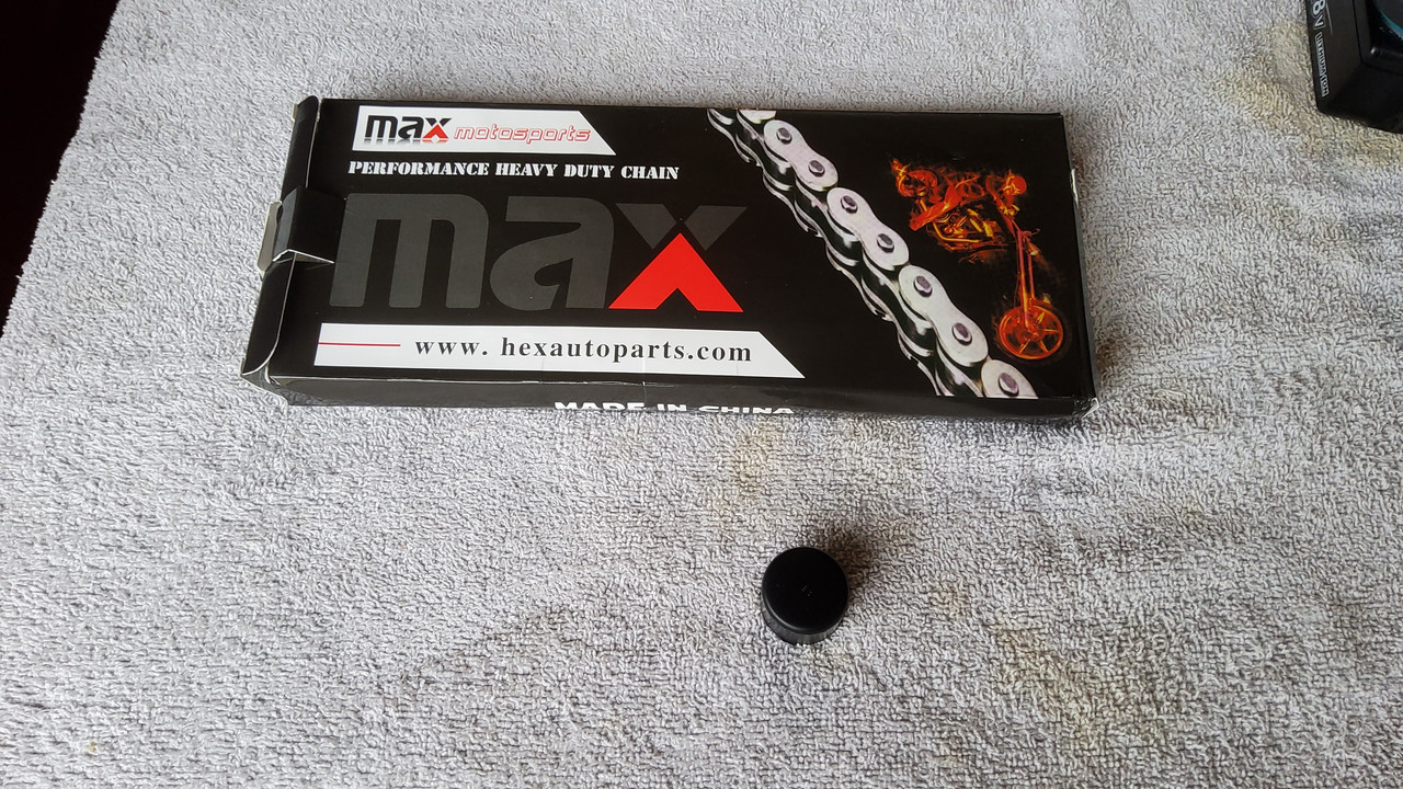

    A couple parts came in..... thank you Shep for that perfect tank rubber piece. This 3WW community is great.
    Also a chain came in from ebay. I ordered a gold one but got a black one. I couldn't find the one I had from the last 200X project I did.....so I just splurged the $22 for a non o-ring new one.

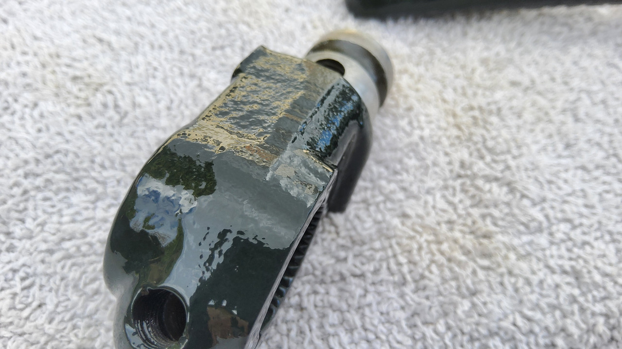

    I painted the kick starter a little darker green now i've gone the other direction....... It's darker than lighter but I give up. It's an overcast day so you're really can't see the pictures...... It looks dark green to gun metal but it really is a dark green. It can probably be seen better on a sunnier day. I'll leave it alone because it looks more natural darker than army green.
    Edit.... If I used a low gloss clear it would have looked a lot more greener and more natural..... But the only low glass clear I had was 2k speed that is a aerosol that needs to be activated. Once the can is activated, it's only good for 2 days. I'm not ready to paint the forks off my DR yet..... So I used a gloss clear which made it even darker.

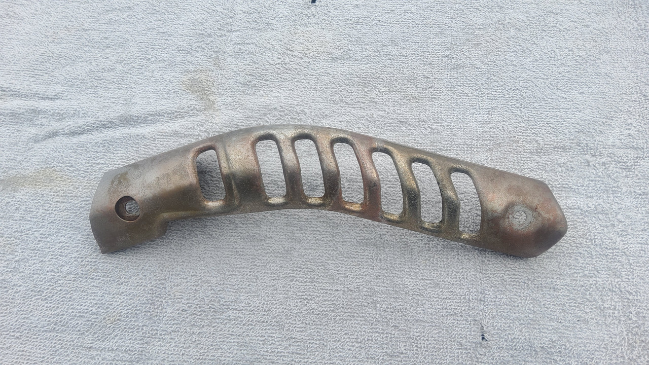

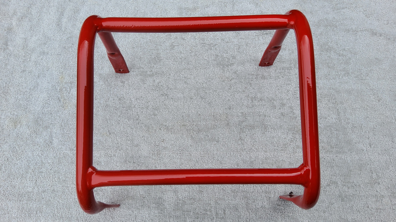

    Got the headlight guard painted. Red was a good choice.

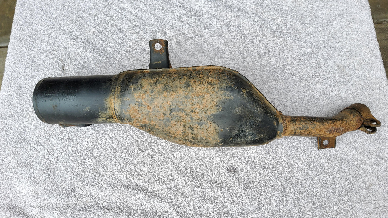

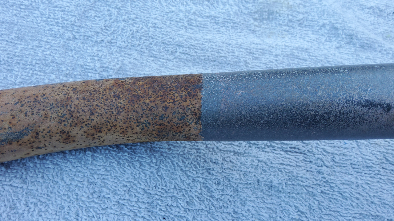

    Finally got the rest of the exhaust pipe stripped....needed to wait for the right container for soaking.
    Does anyone know if the muffler has any kind of packing in it? I don't think it does but I don't know for sure. After seeing a newer DR650 muffler cut up and what appears to have a packing material inside it got me thinking....I don't want any acid "sponging" up inside a packing material and rusting from the inside out.
    I may just soak the the pipe portion prior to the muffler and do a "scratch n spray" on everything else.
  10. #370
    Arkansas
    2,447
    I suggest not dipping the muffler just on the account it has a lot of nooks and crannies that'll trap air and be difficult to clean/neutralize all the dip from. Once hot and acidic exhaust hits that it's likely to cause more issues than you can solve.
    The other thing is if it has a removable baffle, that's the most likely to have packing in it. Some removable baffles have bolts, but also a couple spot welds. That is typical of OE Honda baffles.
    Many OE mufflers from that era have a Krizman type spark arrestor. The internals at the end of the muffler have a vortex inducing apparatus that flings exhaust solids to the outside. That is why many OE mufflers have a removable plug/panel at the end, on the bottom, to periodically remove, plug the regular outlet, then rev the engine to blow those particals out. Those are the carbon bits that would normally fly out of a straight pipe while still glowing, and start wildfires.
    The end baffles, resonators, on many OE exhaust have packing in them. The muffler usually doesn't, it's all mechanical with chambers and perforated tubes.
    A screen, like many two cycle exhausts have, would normally catch those, but it's restrictive and requires more frequent maintenance. Screens are still typical on most lawn care small engines, like line trimmers and blowers.
    As for a last gen DR650 muffler, that thing is a beast. I know of a low mileage one hanging on a wall right now. They're stainless steel and will outlast the engine, but are actually very, very heavy. I've removed and weighed several OE mufflers and the DR is by far the heaviest. Most aftermarket mufflers on low to mid powered modern machines aren't much heavier than aftermarket, except the most modern ones with converters. The OE aren't that restrictive either, unless the engine has some internal upgrades the require more flow at higher RPM. Most stock exhausts are fine for engines that aren't used in actual racing. Largely, aftermarket exhausts are a waste of money on modern machines and just make it louder.
    On your 200X muffler, I'd just blast it and apply a quality exhaust paint. On a stock engine, the stock muffler isn't holding anything back at actual riding speeds.

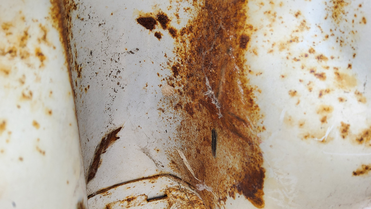

    Does anybody know what color/shade of white this gas tank is?
    Even if it's a spray can color the paint supply place can make a batch for it.

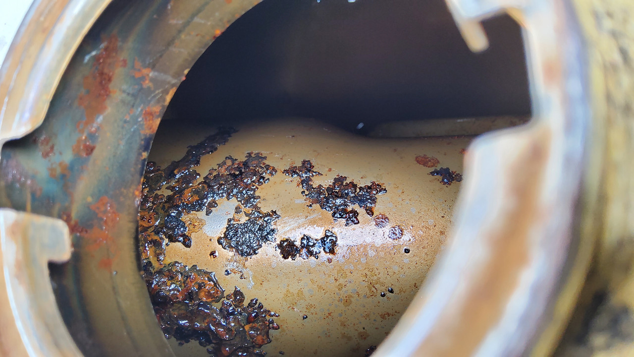

    I haven't worked on this rig for some time. I pulled the gas tank out of the back of the garage just to inspect it. Other than yanking it off the trike I never really looked at it or inspected it closely. I knew there were no dents or anything and I knew it was fuel full on the inside when I removed it...not so much now.
    There's normal surface rust on the outside....common with leaving it outdoors for 15+ years.
    The inside is serviceable. The only real rust is right there at the top........ where probably 15 years of rain seeped in. There are some other spots inside but not life threatening. I used the harbor freight inspection camera but it's mainly just varnished/grimy/etc. Unless this thing is leaking like Elmer Fudd after getting blasted by Donald Duck (which it isn't) I will never use a tank liner. Even the good ones like Caswell will fail eventually..... leaving a nightmare of a job to remove. Tank liners are evil but necessary at times.
