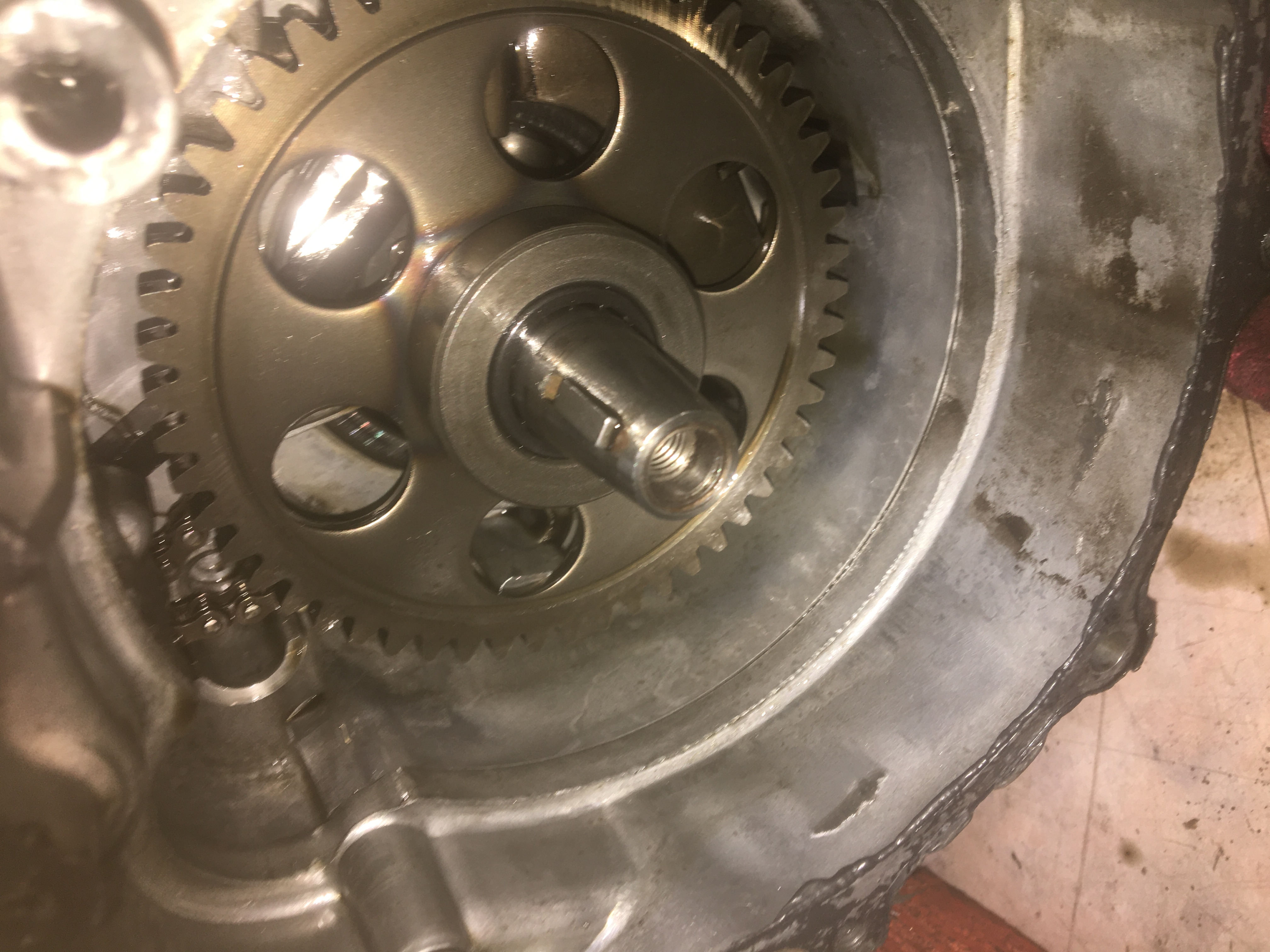

    Ok. Bearings are good. I found the problem. The starter gear behind the one way bearing was rubbing hard on the crankcase. The thrust washer between the cam gear and starter gear was in the wrong place. Just have to shake your head sometimes. Way better than splitting the case I guess.

    Gear
    Pic of smoking gun.
