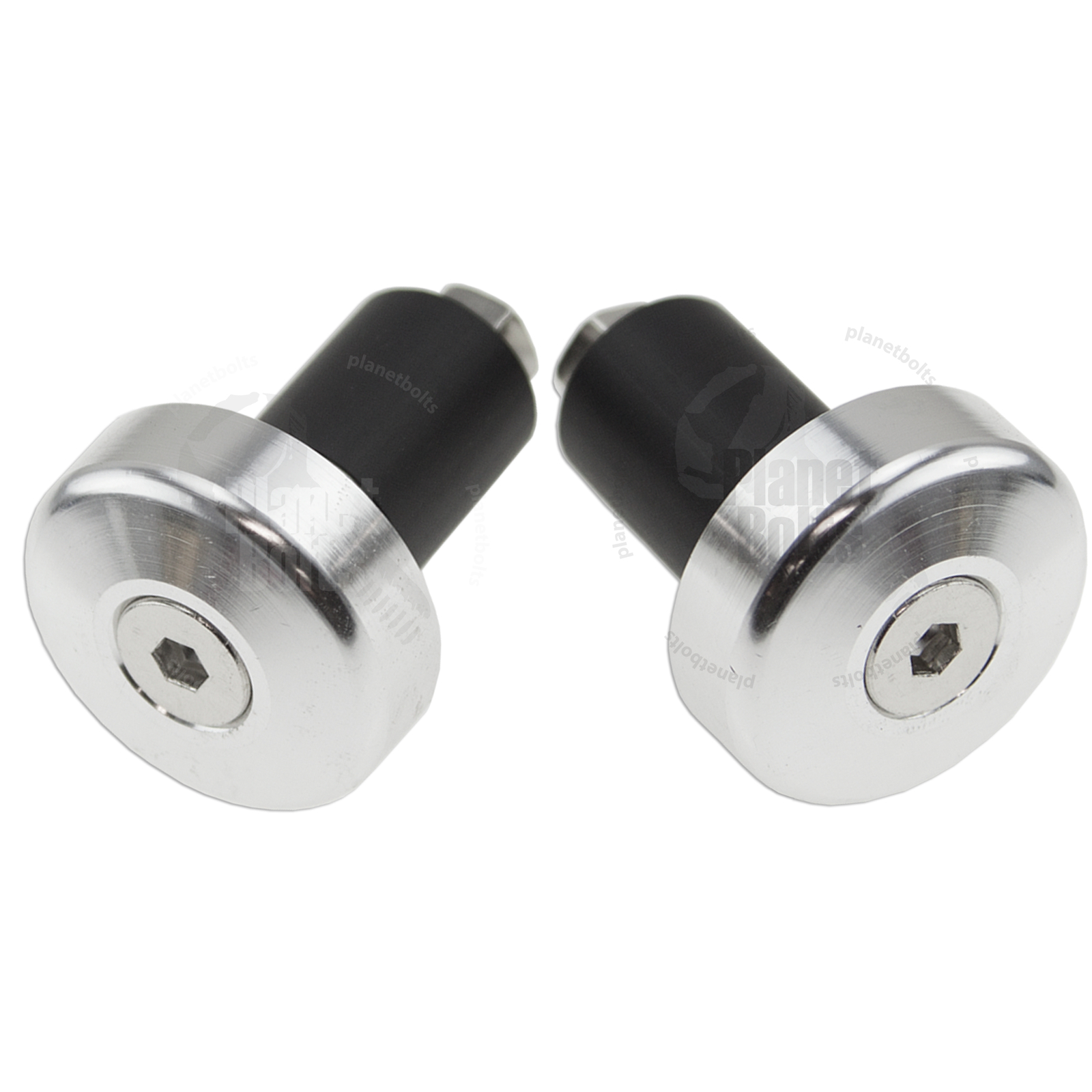

    I get trying to retain an OE style.
    Since those black bars listed in this tread don't have...threaded ends, it'd be nice to finish them with some bolt in bar ends.
    Something like these:
    https://www.ebay.com/itm/18379547071...4AAOSw3bBcyku5
    Bar end caps/weights really help finish out the OE look.
