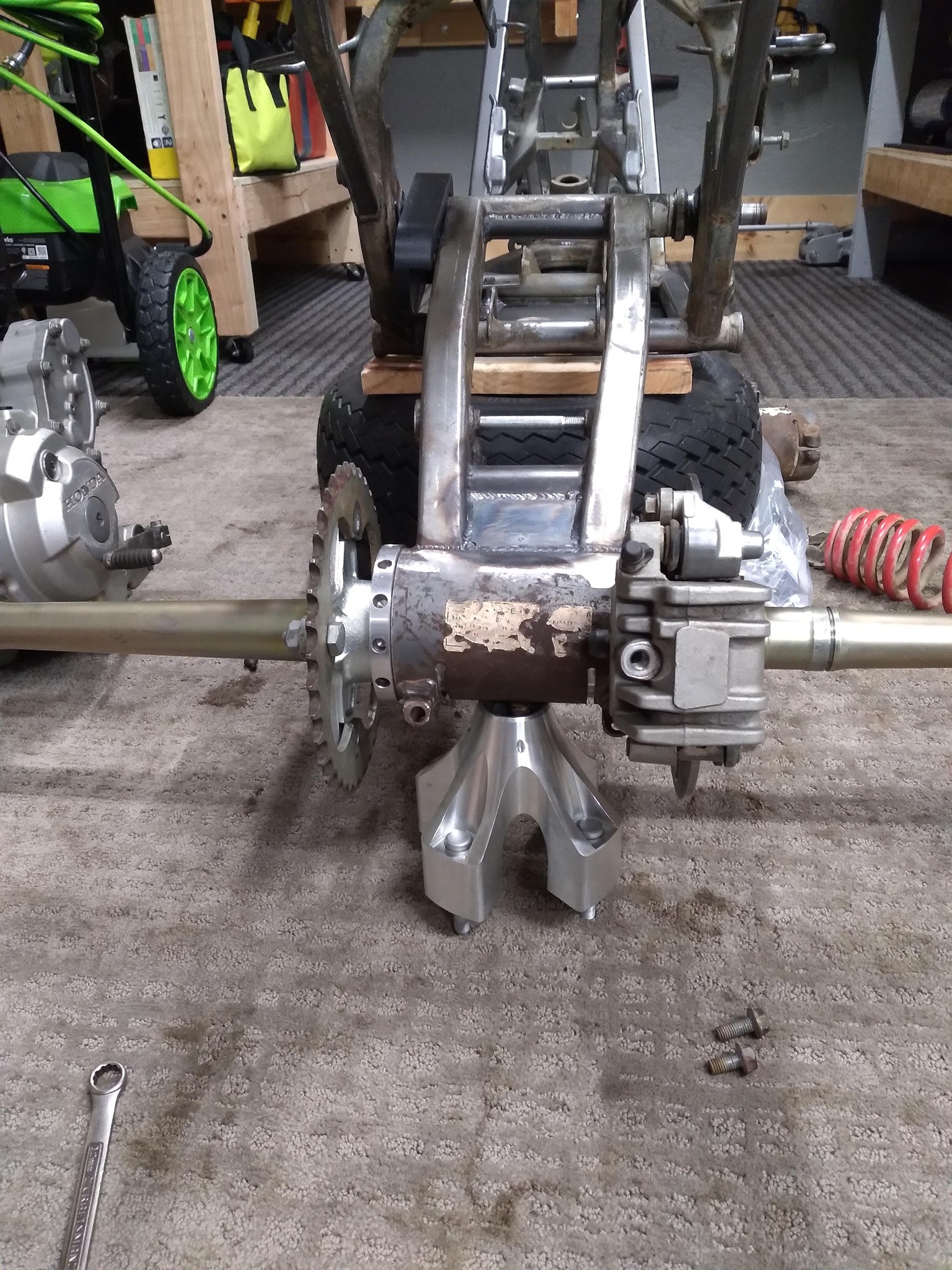

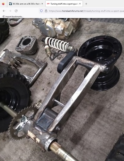

    here's my 85 350x arm we converted to 86. You guys have talked about it on here longer then it takes to convert.
    I used the OEM 86 350x rear brake stay, cut it up and over at HRE one day we modified it to run a YZ426F front dual phenolic piston caliper ($14 shipped) almost same design as TRX250R) and mounted it to the plate. Next I didn't like the big 350X rotor or the 300ex rotor, which both bolt on. I use 85 ATC250R rotor and hub since its the smallest of all rear rotors
    (must use 350X brake stay is using 350x rotor and hub)
    (must use 300ex brake stay is using 300ex rotor and hub) i have multiples left forsale
    You can see 85X arm in bad shape I had, so we fixed it up.
    You can see 86X arm in good shape I had, I sold it to fund other stuff.
    You can see the threaded on nipple I cut off 85X arm
    You can see the brake stay nipple on 86X arm you need
    Besides the two gussets up front on the 86X arm nothing is different. Both OEM arms need gussets where I have them placed. If you can't do this send it to HRE who can do it in blink of an eye.
    Later after I sold the machine I took that same swing arm and modified it for a warrior 350 rear shock which was a great upgrade on a 300ex.
    Long story short is anything can work. I know what all works since I've had everything psychically in my hand from parting hundreds of machines out.
    I ended up selling all the OEM 350x stuff off and using new or like new 300ex rear axle, 86 350x / 93-09 300ex LSR dual row carrier (still have one left FS needing new bearings) got all my stuff for free. Guys wanting period correct 350x's wont do this...I wanted new parts I can get easy. It all did the same thing. It road, it works and it was fun. But you need to know how to think at times, have some parts made and read a digital caliper...if you cant do anything of that. Have someone else make some parts for you.
    My typing this responce took longer than it takes to cut the 85X brake crap off, turn a new nipple and weld it on in place for the 86 350x or 300ex brake stay. THE carriers are 100% the same 86 X - 93-09 300ex 100%
