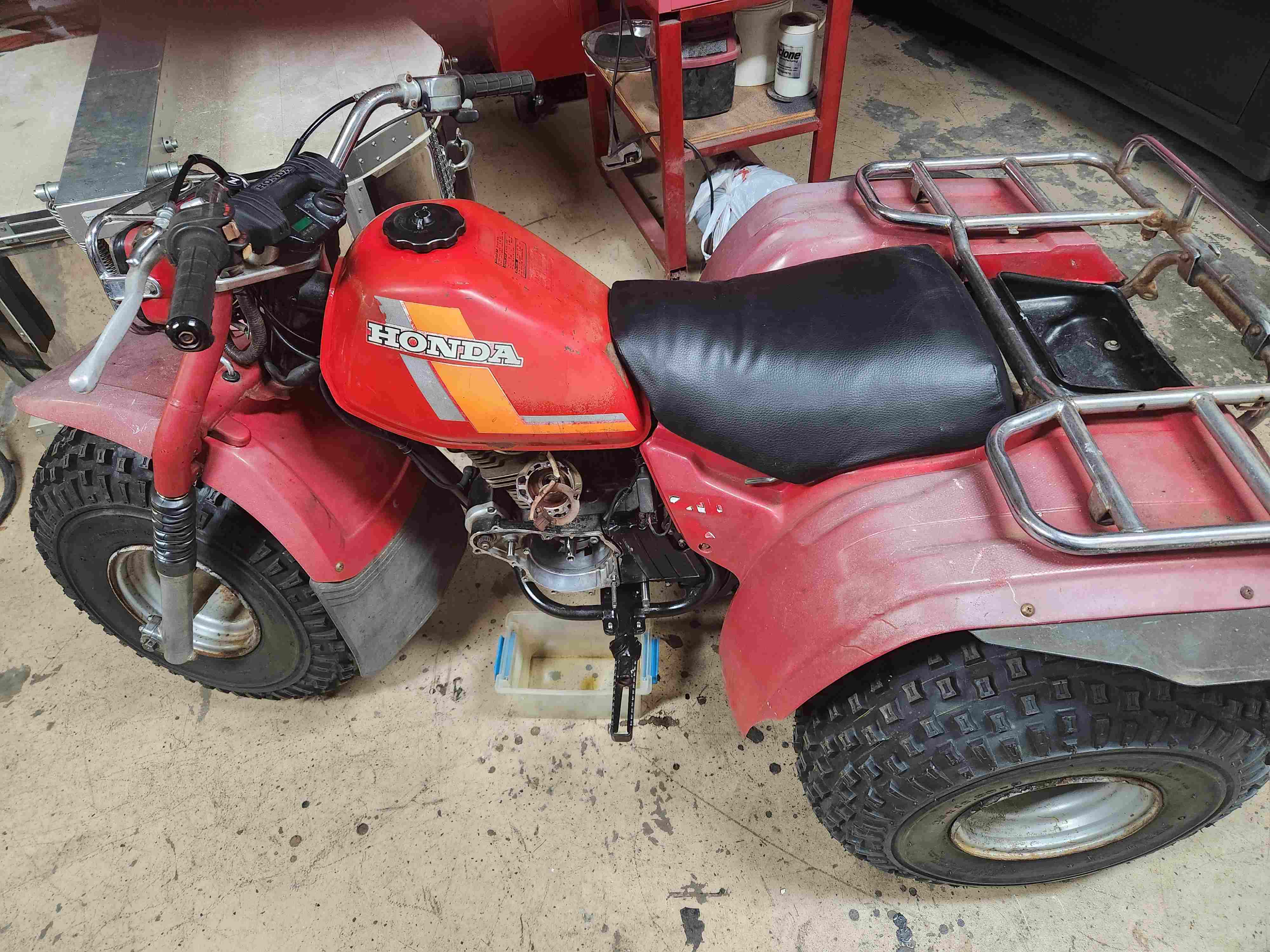

    And where I'm at now, much better.
Name:	200M July 23rd - Copy.jpg
    Got it all together except a muffler and was test running it for a couple minutes and got a bad backfire when killing it. SURPRISE, sheared the crankshaft key on the alternator rotor! Wallowed out the side of the keyway in the shaft a bit, but I peened most of it back down. Now it's only about .010" or so wide each side. ARRRGGGHHHH!
    I'm thinking that Loctite 660 sounds like deal. Anyone tried that for a minor issue on the keyway?
