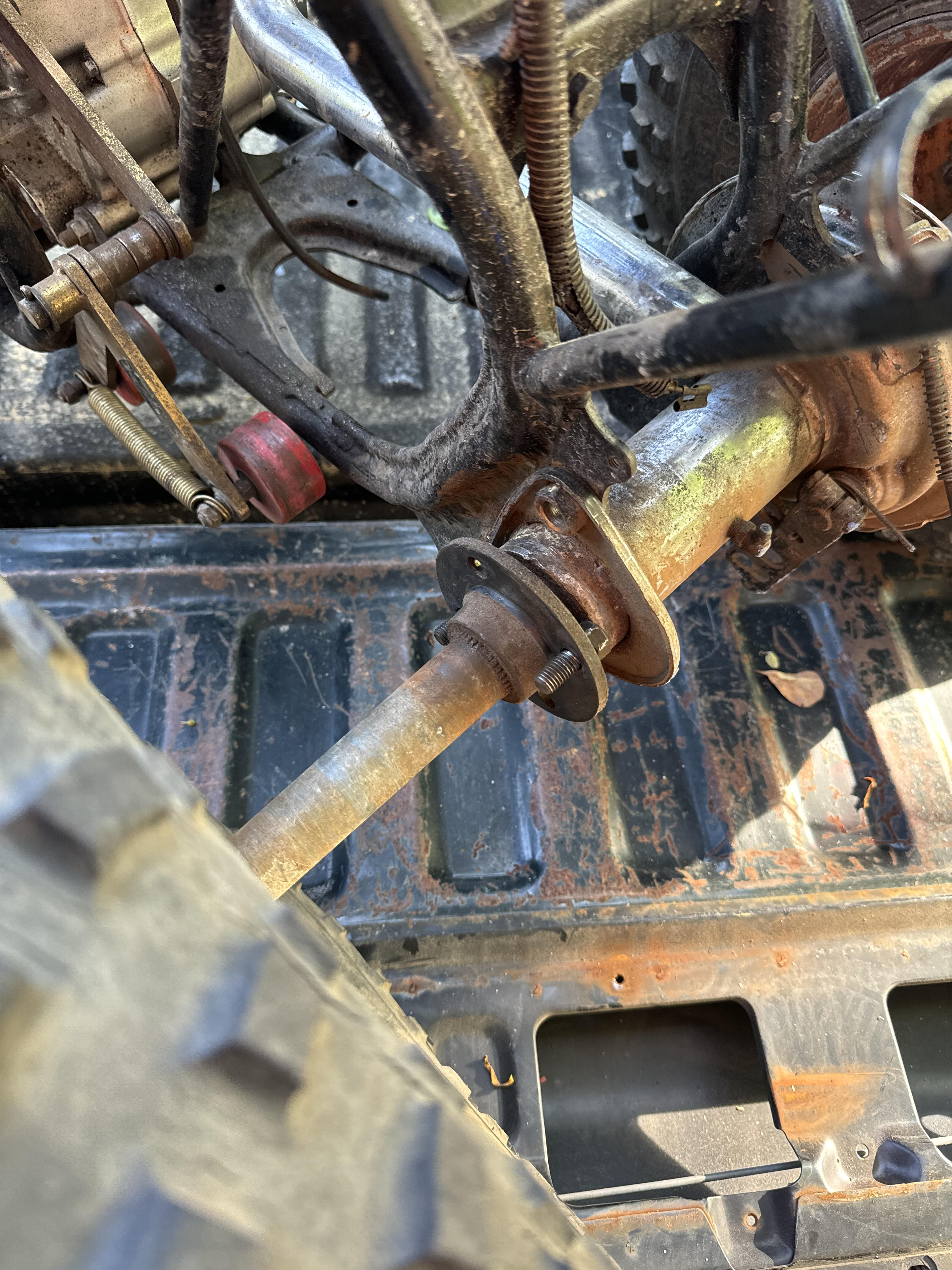

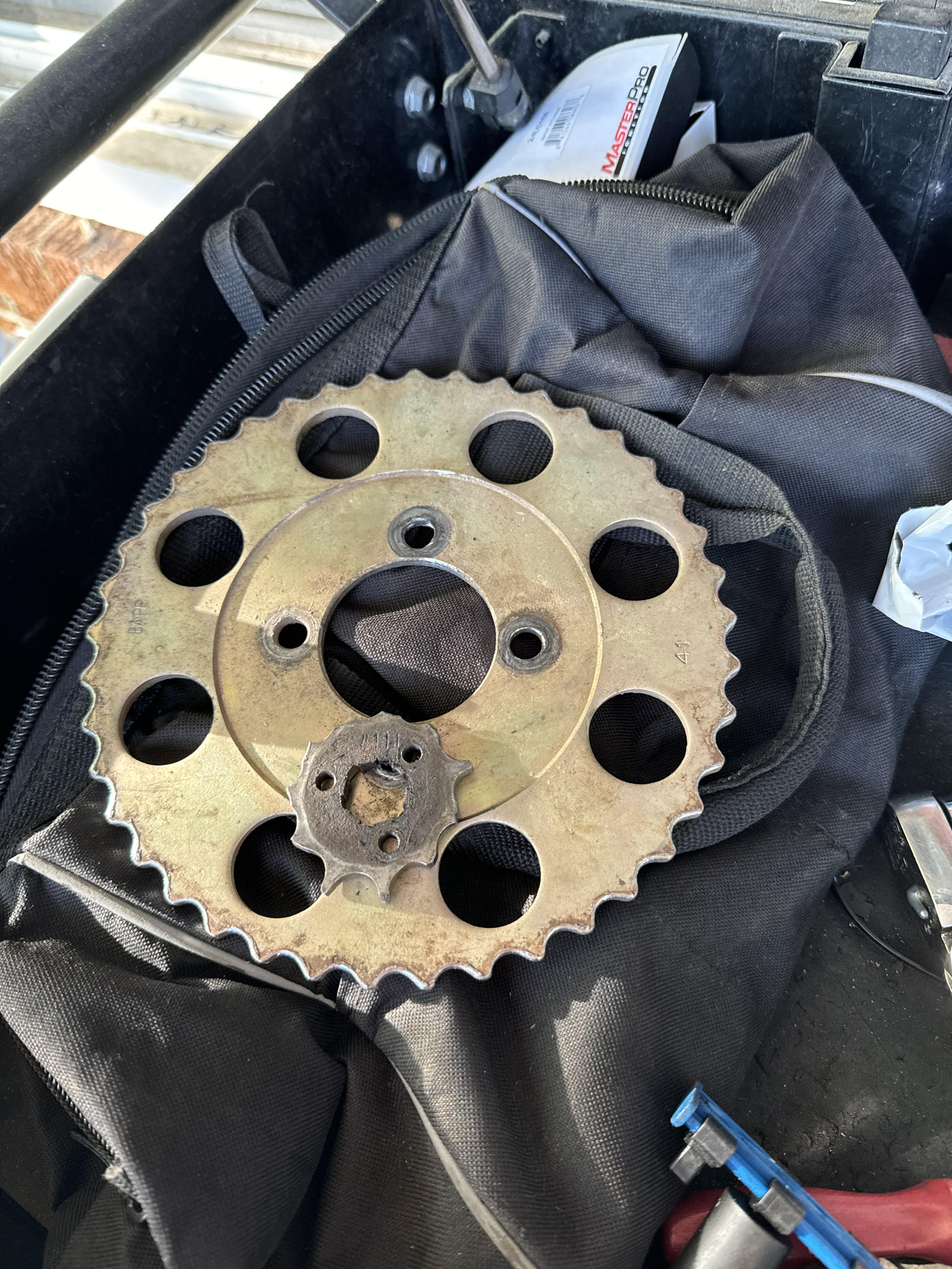

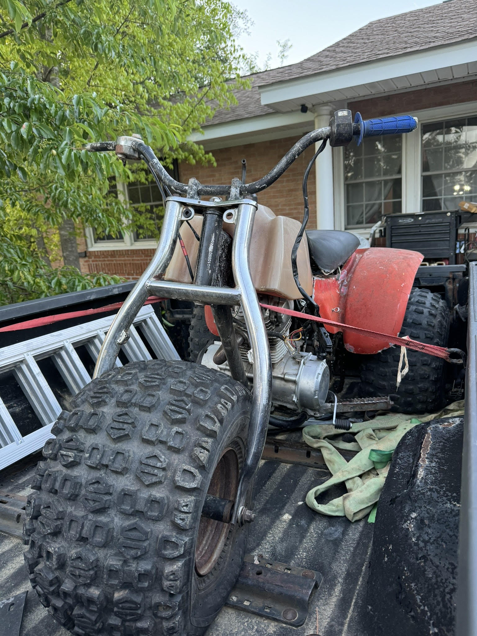

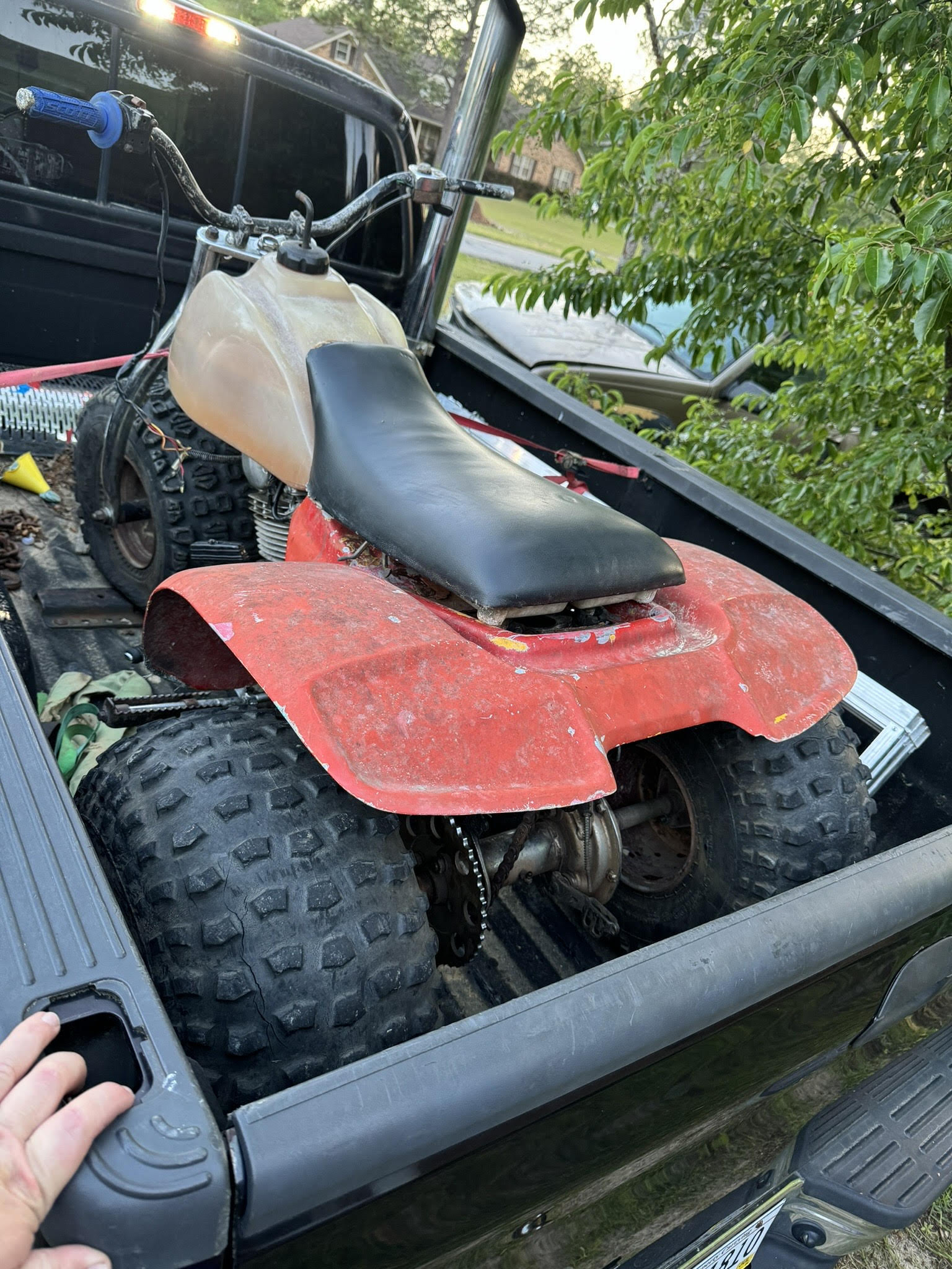

    That is actually extremely helpful! Unfortunately I don't have a headlight to go off of but as for the kill switch it is on the left of the handle bar along with some other switches that i cannot make out what they are. Also I have attached images of what I'm working with.

    I would call it a mutt , several years mixed in there . But with those rear fenders it’s a 185s 1981/82 , oh and a 200s seat lol .

    Classic case of somone needing a trike and being so excited they do not ask seller anything. Its a 185s mostly. Time to live and learn like we all did

    I'd say that someone got all the goofy out of those sprockets.

    I just swapped a 85 200s rear axle in my 83 185s that sprocket looks the same. When I get home tonight I'll measure the mounting holes.
    Aug 2020
    Snowflake Arizona
    77
    Sorry forgot to measure those axles. I measured bolt to bolt center its 2 1/2 on 200s and 2 1/8 on 185s. The 185s studs should have a smaller set of threads on the end of the studs.
